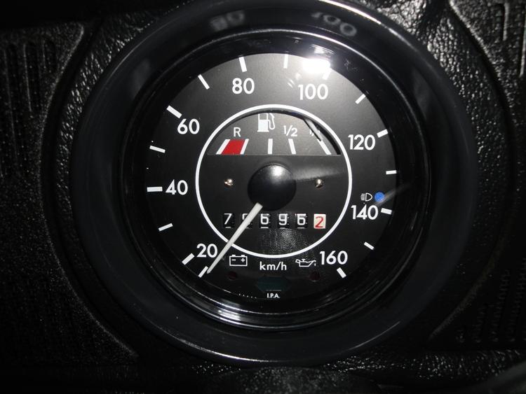

valvecovergasket
Joined: October 10, 2018
Posts: 1499
Location: pnw
valvecovergasket is offline
PostPosted: Fri Jan 29, 2021 12:09 pm    Post subject: Re: Foggy Dash Reply with quote
the plastic is bonded in and i think youd be hard pressed to replace anything
that said the whole thing isnt sealed all that well and odds are its just dirty.
here are a couple pictures of the setup during a gauge project, i didnt take too many good "before" ones but you can at least see how it comes apart.
its pretty easy to dissect just be careful with the plastic foil, probably a good time to replace it if it looks at all suspect.
getting it to this point is just a matter of a handful of philips screws and some careful removable of the foil. its not rocket science, if youre worried youll forget how it goes back together just take a bunch of pictures along the way...
you can see the plastic on the left hand here
and where it used to be the mounting edges are visible here (i had to break it out in pieces, theres no way your removing it cleanly to replace it)
but getting back there to clean it off is a good step. both of the cluster surrounds (my original and the cleaner one i bought to work with) were pretty dirty back there

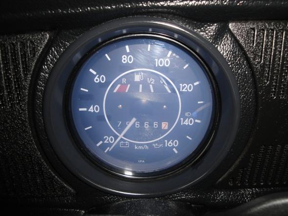

oasis
Joined: December 12, 2002
Posts: 2193
oasis is offline
PostPosted: Fri Jan 29, 2021 9:05 pm    Post subject: Re: Foggy Dash (Instrument Cluster) Reply with quote
Thanks!
If it is just dirty, it's dirty on the inside of the plastic. I used the same wipes I use for my eyeglasses trying to clean the outside.
The plastic being bonded in is no surprise, but I appreciate the confirmation. I will do my due diligence when the weather gets a little warmer (unless I have all of my desired parts gathered ahead of that ... then, I'll just let a professional take over).
