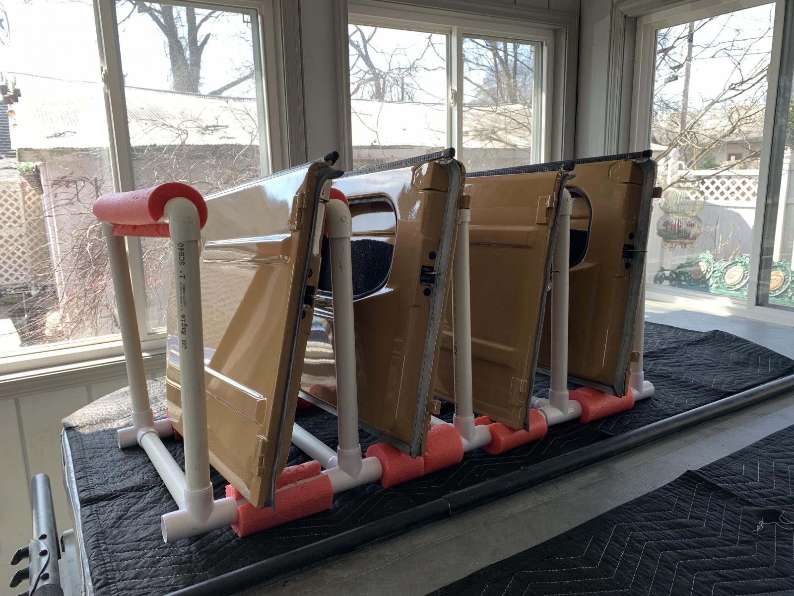

PostPosted: Wed May 14, 2025 9:33 am    Post subject: Re: Door storage Reply with quote
I put together a rack of sorts with PVC pipe, fittings and some pool noodles.
Everything is friction fit so that it can be broken down and used at events.
