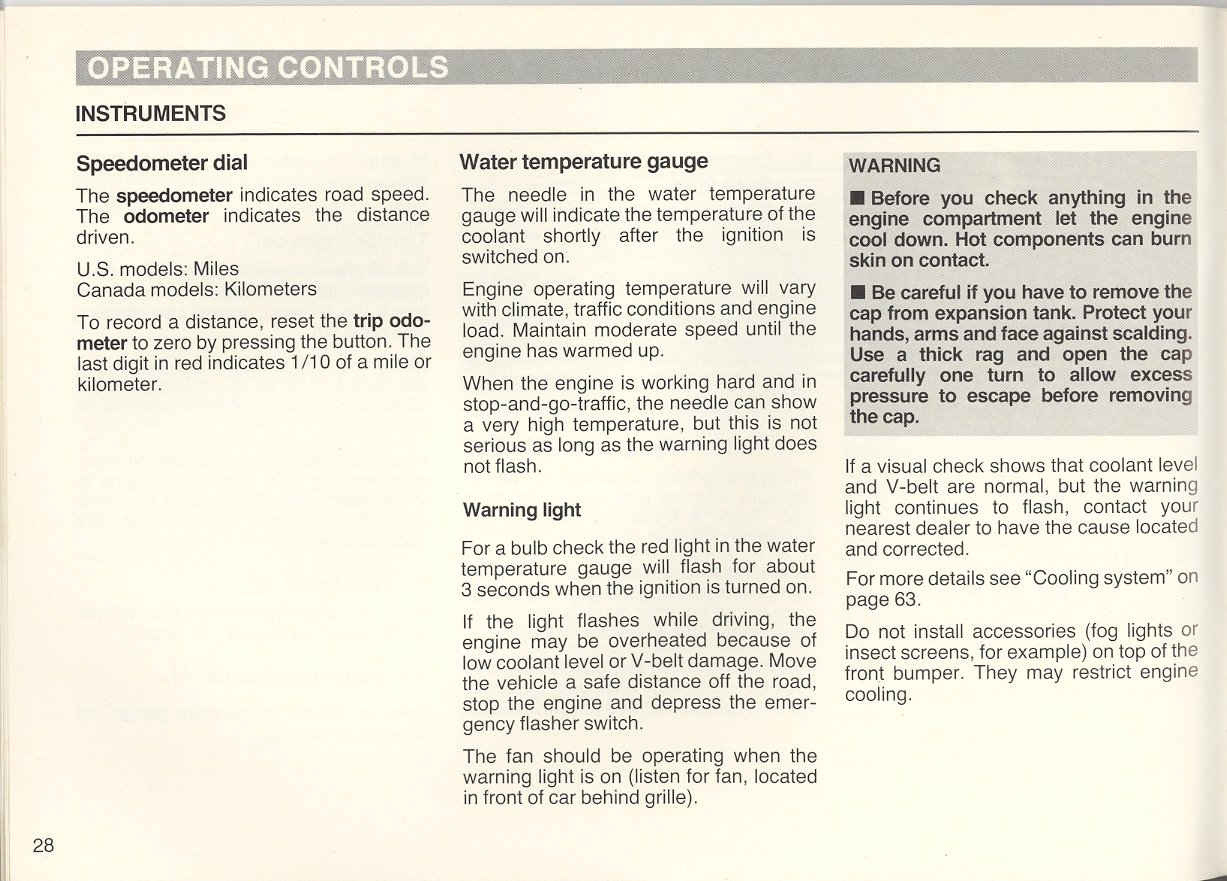

How the heck are we supposed to know if it's the coolant level or something else. you are the 1st one on the scene..
open the engine compartment and take a look..
and if you don't know anything about (antique) automobiles.
READ THE DANGED MANUAL
