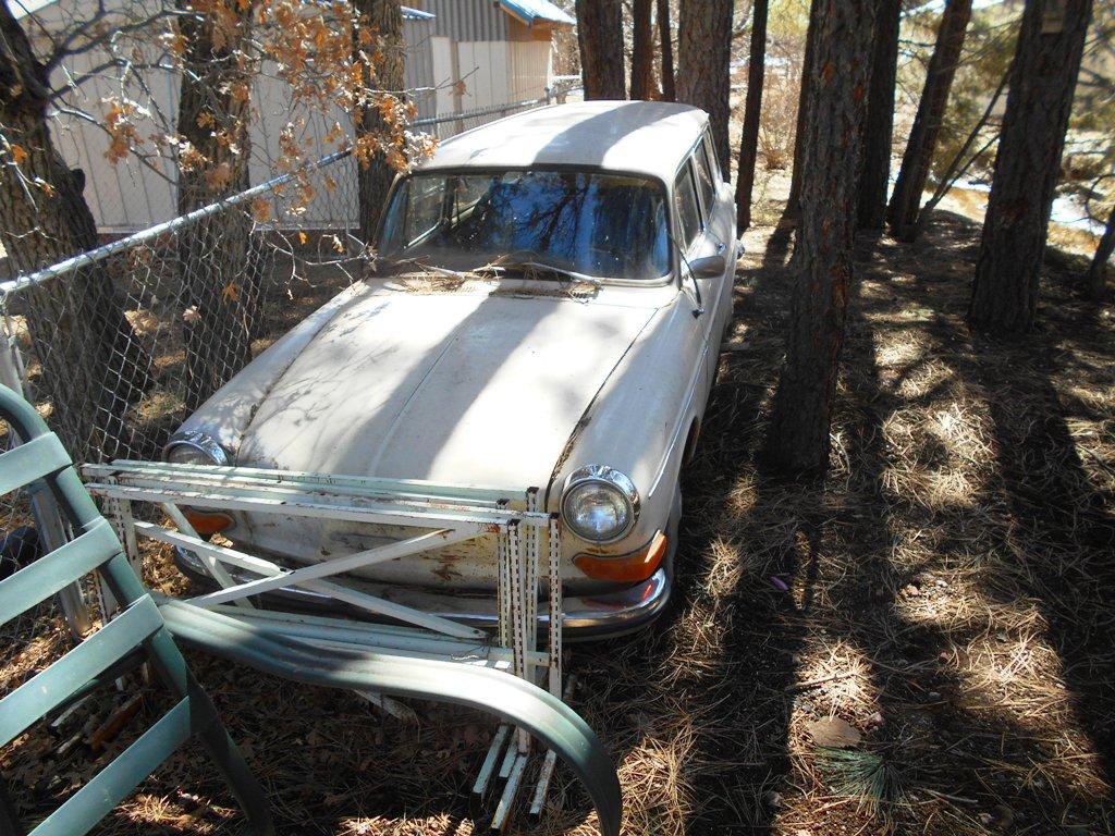

The squarebacks are out there in great drivable condition for dollars. I happened to find one parked for ten years, a complete car. A year later driving fine and dandy. Yes it needed a lot the wiring was not all hacked up, did have to replace the right battery tray pan but the sale price was only 850 bucks.
When looking at them look them over top and bottom and drive them, do yourself a huge favor and check many as you can. Ok one my be sold but keep looking for what will fit your needs.
How I found this one
and now after complete engine work, interior work etc.
Would sell if for your budget too.

That red Craigslist car doesn't look like one that the owner does his own work to me.
I could be wrong, but I'll bet you.. Wink
just a gut feeling, but that thing has 'lipstick pig' written all over it.
