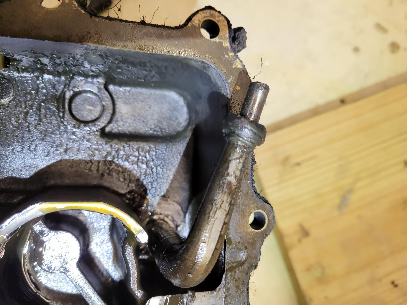

After dropping the exhaust system, I quickly found the source of the fairly-serious oil leak that the engine had:
It looks like the rocker arm had contacted the head at some point and broken a chunk off, and someone had repaired it with red RTV. This made me glad that the engine was coming out. So it looks like replacement heads are in order, which leads to my first question (hopefully not stepping into a hornet's nest here)- what should I get? I want to keep things pretty stock but I think I'd prefer new over rebuilt, and I'd like to maximize reliability and cooling within reason.

My two cents. Get your new AMC heads refined by Len Hoffman. https://newsite.hamheads.com/

If your heads are otherwise good, why not find a piece of aluminium, cut it to fit the gap, and and have someone TIG or MIG weld it into place.

This is good advice, I maybe shouldn't be so quick to jump into new heads. I guess my assumption is if that damage was repaired with RTV, there are other horrors lurking within.

You could JB weld that hole in the head in place. Use brake cleaner to get it oil free. Let the JB weld plug the hole, then setup just above the sealing surface off the valve cover. Then Knick it down close to flat with a file
Somebody just prised on the rocker arm and gorillaโ€™d that hole, I bet
