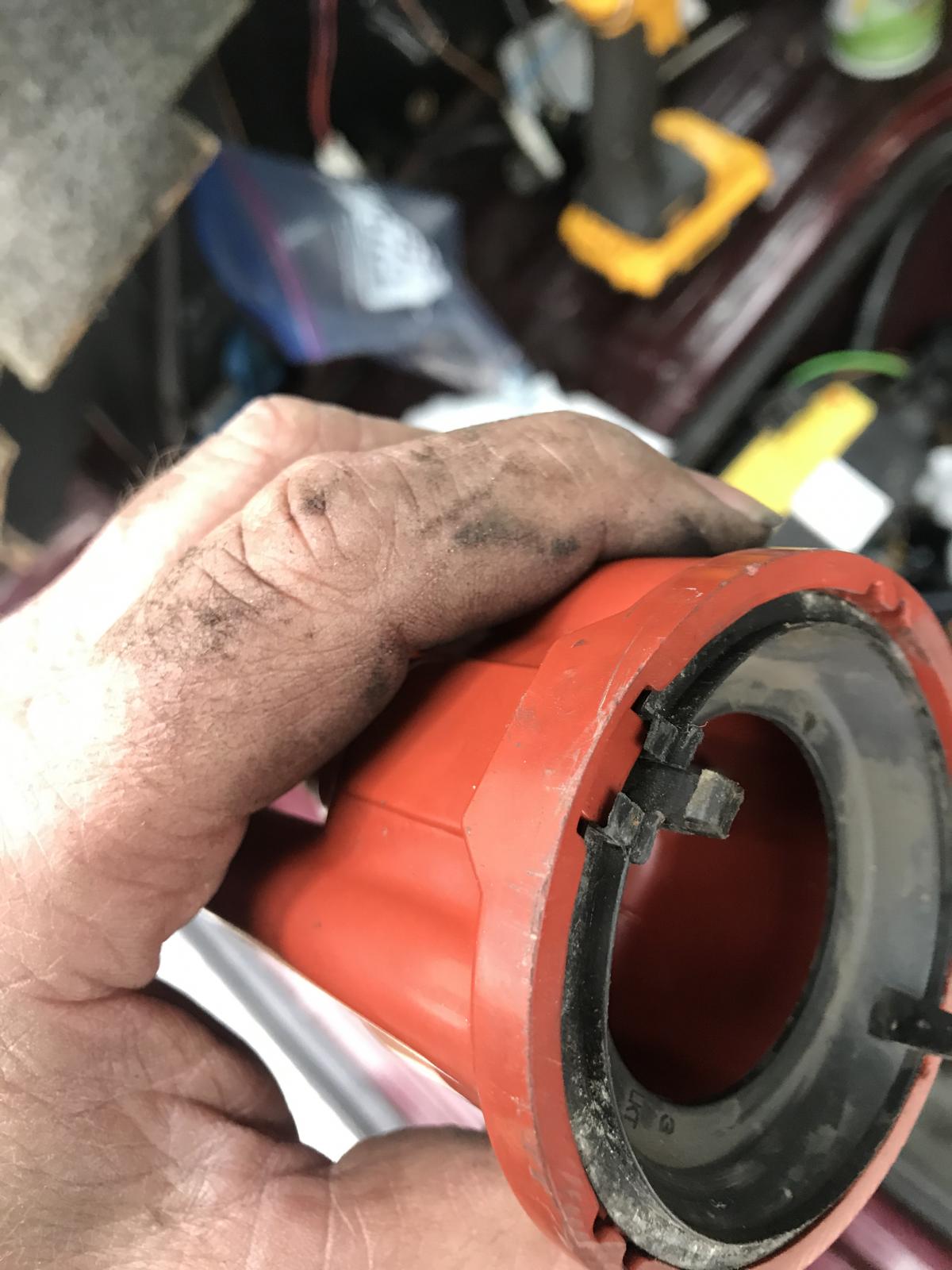

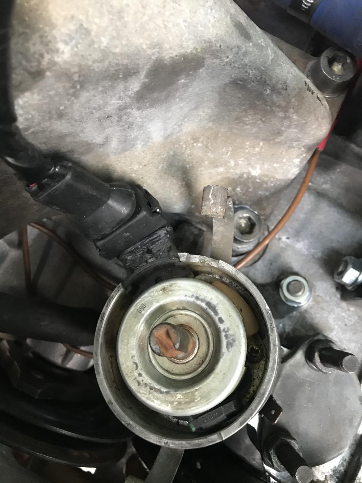

I was cleaning up the distributor and made sure the rotor and cap I got fit OK.
The rotor did, the cap did except the alignment tang was too narrow, the cap can rotate a degree +/- ?
I thought "That's odd, I'll need to make sure it is the right cap."
Anyway I put it in yesterday and it occurred to me that maybe the distributer on the 2.1 in the garage might have a dust cap?
SCORE! It does!
It turns out that the dust cap us held in place by the alignment tab on the distributer cap!
The black plastic is molded to fit into the alignment slot.
The sloppy cap was because I didn't have a dust cover!
Moral?
Put on your dust cover folks.
