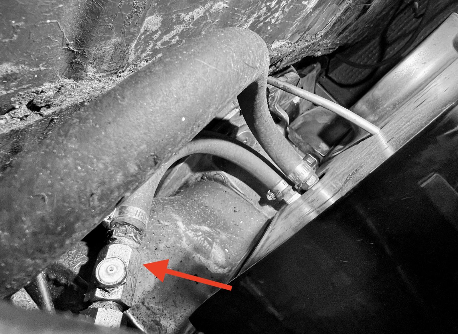

PostPosted: Sat Mar 04, 2023 8:32 pm    Post subject: Re: Oil Cooler Wiring Reply with quote
Thanks Glen, here is what I have. Does the prior owner have the (broken) thermostat on the line in?

With a 1600cc engine as in your signature I would immediately remove the auxiliary oil cooler and install a dog house oil cooler and shroud, no matter what the cost and eliminate all you extra baggage and head aches. The way the cooler is mounted up against the package tray there is not very much room for cool air to circulate around it. I'd bet your engine would run a lot cooler with a factory dog house cooler and shroud.

Looks like the stock non-dog house cooler was remove and this is the only cooler.
I'd go back to stock or convert to a dog house oil cooler and remove the remote one. It's probability not needed.

PostPosted: Sun Mar 05, 2023 8:42 am    Post subject: Re: Oil Cooler Wiring Reply with quote
Best solution is as others say, just replace what you have with stock cooler...
With the adapter that is on engine the upper hose is "OUT" of engine and "IN" to cooler, the lower hose connection is "IN" to engine and "OUT" of cooler....
Don't know what the device is in hose, everyone does this sort of thing different/non standard...
Relay polarity in real life does not matter.... Unless it had a diode across the coil windings... The current passing through the coil creates a magnetic field which causes armature to move, closing a set of contacts that is all it is... And Yes technically 85 should be ground or negative and 86 should be 12 volts or positive by DIN standards ...
And yes cooled where mounted so close to bottom side of package tray is very poor for air flow... It makes it almost useless.... It needs more air gap for air flow...
