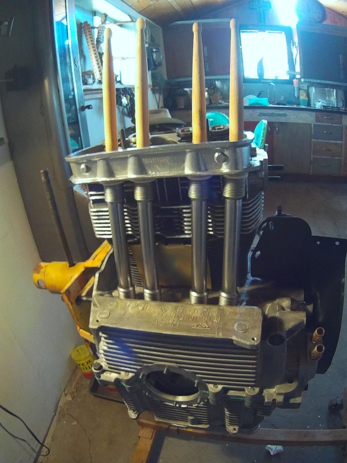

The annoying pushrod tube juggle gets a lot easier when you go find your drumsticks, stick one down the first pushrod tube you place, then the remainder go lickety-split. Thanks, Buddy Rich!

I wish we had a "LIKE" button great idea but now I have to buy some drum sticks.

Some here that will just look at the picture and not read your post, they will be assuming thats the new lightweight pushrod set, cause saving 2 ounces will gain 10 horsepower Rolling Eyes

I just use a deep socket that fits.

I never had a problem lining them up.

I’ve always just used to pushrods themselves especially when building an engine in the upright position. This holds everything in the correct position as you line up the seams and get ready to tighten. Not shown any manual it was shown to me 25 or 30 years ago by the old man building engines.

Also, I never seem to have the pushrods nearby when at the head-setting stage, typically I don't install them until I've spun the motor up for oil pressure.

I don't get what the drum sticks are doing? What's the juggle? Don't they pretty much just fall into place, like you can simply feel when they are seated into the lifter cups?
What does this help with?

neat trick. It can be a pain sometimes.
The windage pushrod tubes are easier because the case end does not want to fall out.
For me it's a pain all the time, tubes falling on the floor, exasperating. Never been good at it.

I just use the pushrods to hang them tubes all together while I introduce the heads on the cylinders. AFter the seals are in place in their holes you can remove the pushrods. SErve like 12th hands on there.

LOL! No wonder I didn't understand this as I'm building my engine with the windage tubes. They stand up straight by themselves. Now I get it...

I looked and the second thing I thought is "Must have big balls! He's building that in the kitchen!"

Only as a matter of course...
