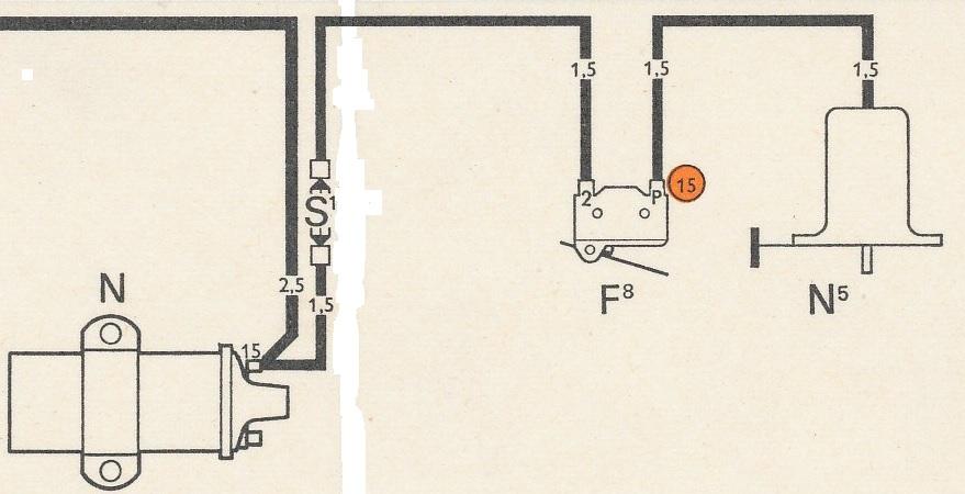

No colors, but here is how the switch is wired:
I think the wires are all black, anyway.
With an automatic, you probably need the red wire connected to the electric AAR. Can you post a pic of your engine bay in that area (near the distributor) and we can better advise you.
Switches are near impossible to find. Some have adapted generic micro-switches from Radio Shack. Hard to find a RS anymore, too!

Ah that's easy enough!
Where and what is N5? On the trans?

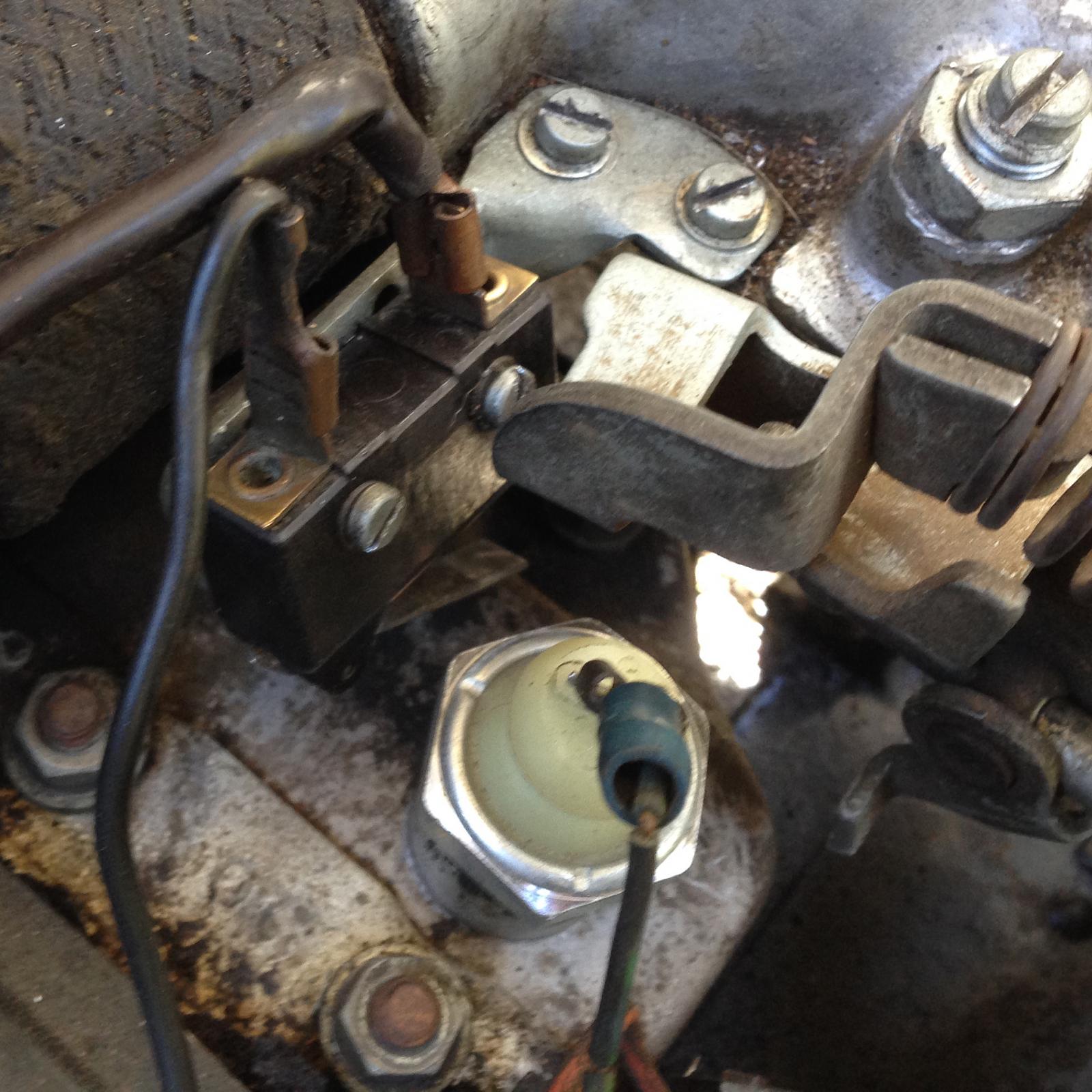

Is this the kick down solenoid?
I have a black wire coming out of it.
Pic is from samba gallery that I circled.

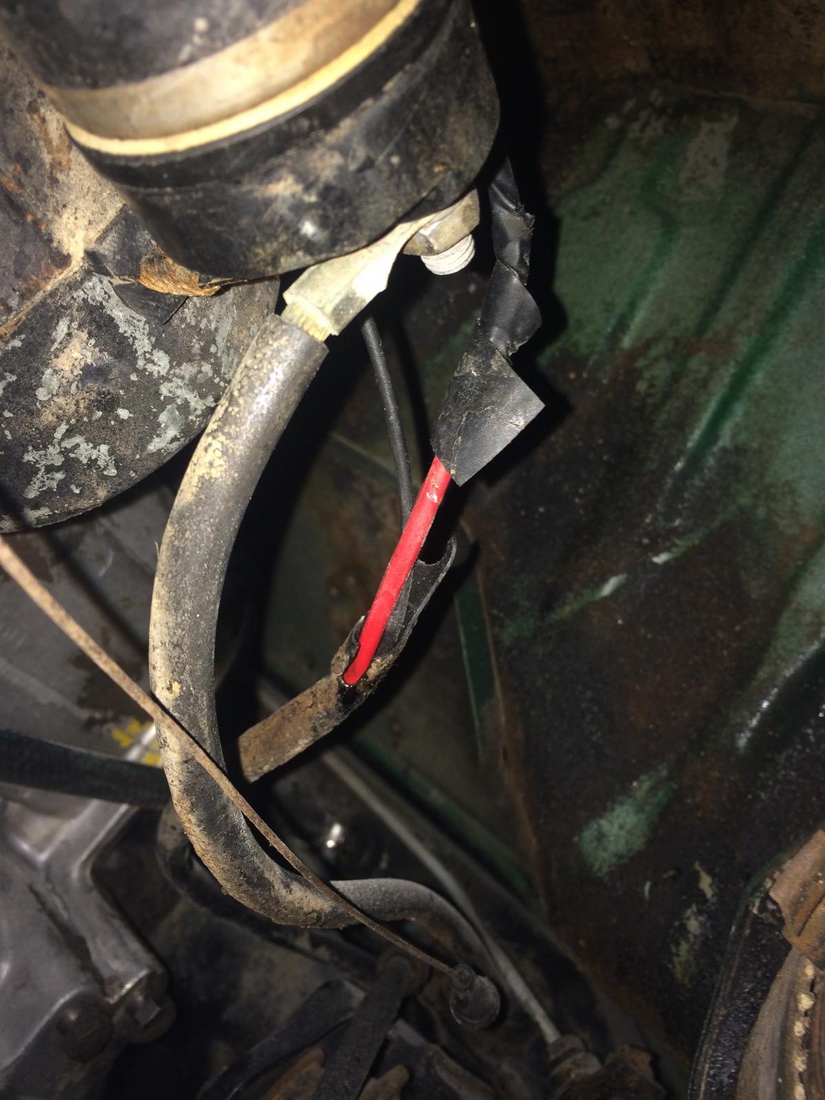

Pictured is the wire I'm talking about. If you look close you can see the thin black wire behind the red one. It exits the harness that goes to the starter. (I'll be fixing the tape on the red wire soon)
It only has power when the car is in R. Tried every other option to get power to it, as in lights, brakes, and all switches. Only R so reverse lights! Very Happy
There are no other switches on the trans other than the one I circled in the earlier picture. Hoping that is the kick down solenoid.

That's "N5" that goes to the kick down switch.
Off the coil + or terminal #15, you should have a black wire with a cigar shaped fuse holder (S1), and a black wire coming out of it, that goes to the kick down switch (FCool.

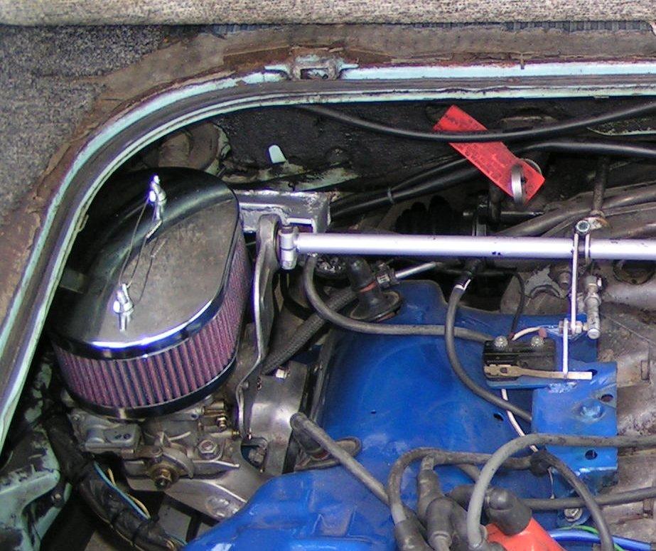

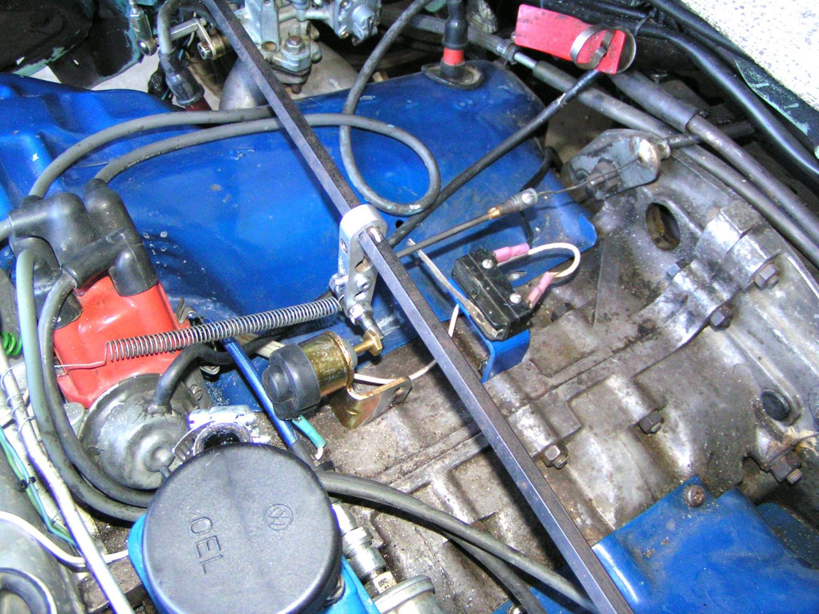

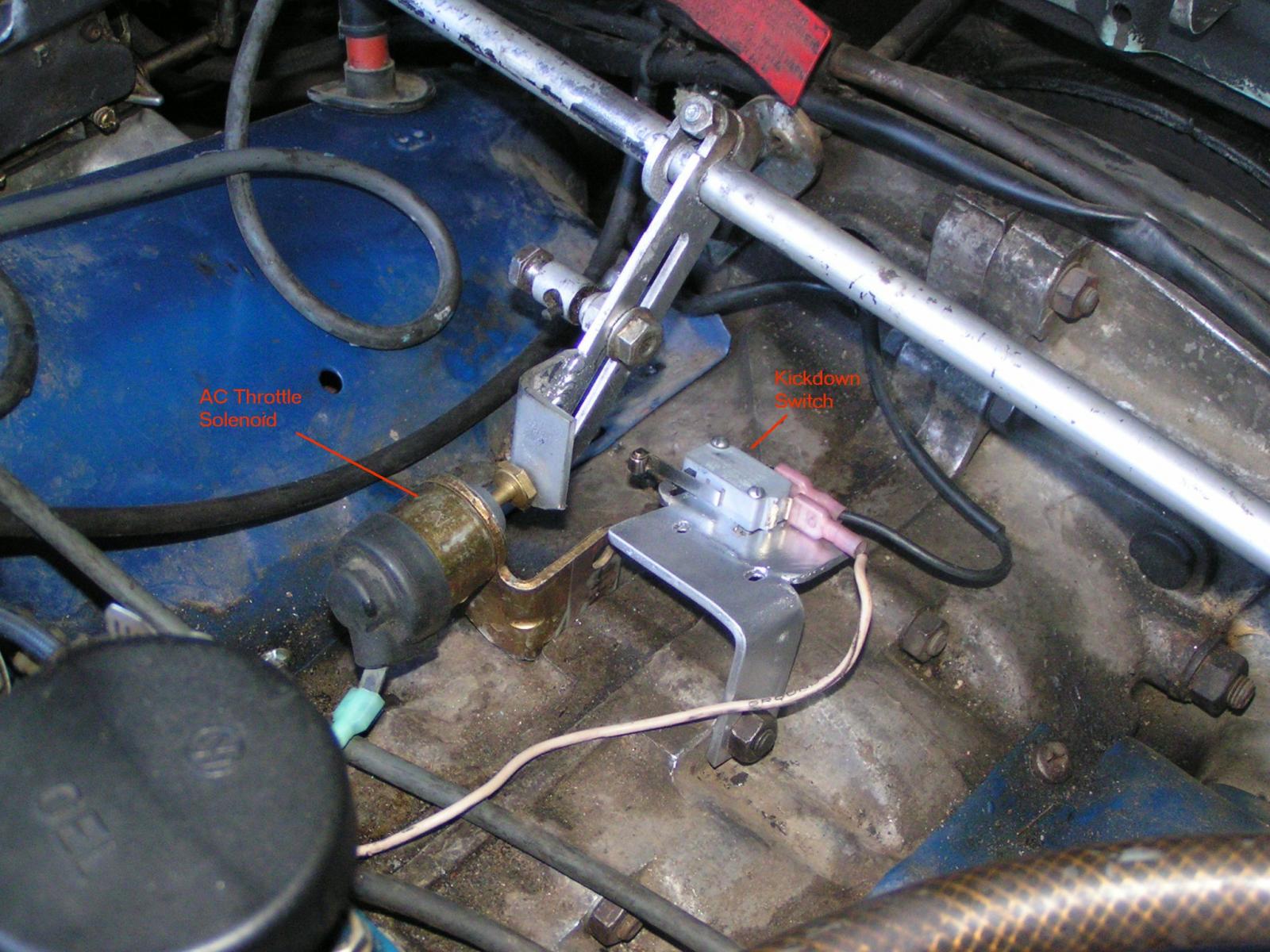

The green circled area on your trans is it's kickdown unit. Just to make things simple, it is activated by 12V, not ground. The kickdown "SWITCH", is integrated into the throttle mechanism. But to put it basically, the kickdown switch is a micro switch with an arm on it. In its regular state, it is in the normally open (no connection) condition. The electrical connections are easy. Connect a wire from the hot (keyed) side of the coil to the switch. I put an inline fuse there. Then from the switch run a wire to the green circled connection. When the throttle is floored, it closes the micro switch, and sends 12V to the trans. This activates the kickdown feature.
I wish I had some better pics for you, but I have been running a Type 4 engine so long, I don't have a pic of the stock throttle unit. However, I did steal the first pic from the gallery. The rest of the pics are from my various stages of carburation, and I hope you can get a general idea from al of them.
