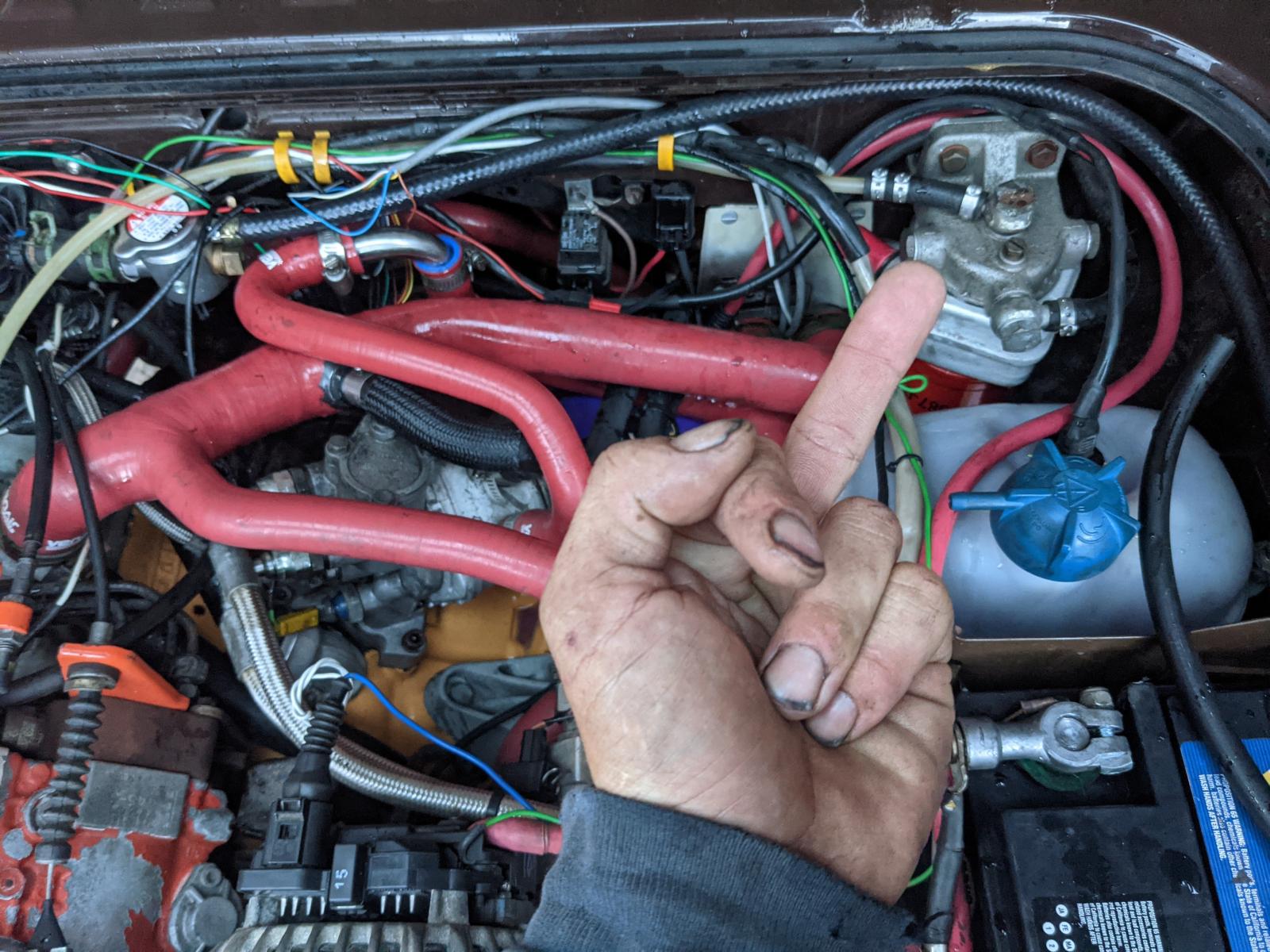

I`m battling cooling flow issues to the radiator not even 10 days before shipping my van to CA to finally do my dream trip with the Syncro to Central America.
Well, looks like it won`t happen on time now...
If you can help me, that would be awesome. There is clearly something I must be missing somewhere but I`m too stupid to find out what.
So, here`s the deal:
Brand new rebuilt 1.9 Tdi engine by yours truly over a period of 8 years. Finally got on the road, kinda...
JX 1.6 TD style layout.
I cannot bleed the air out of the engine hot hose (the spider hose). When the engine is off, if I squeeze hoses fast, I can hear bubbles in there.
Let me tell you that`s not my first rodeo with diesel engines or Vanagons in general, and I had never had this issue, ever, so I`m really at loss here....
I always bled the engines nose down , expansion tank open, heater loop open, and that`s it. Easy as it gets.
I tried also nose up to move air a bit and while accelerating to avoid sucking air into the radiator.
So far I have almost no flow to the radiator, I can bleed it easily, but the stainless pipes underneath tell me the flow is almost non existent.
The hot pipe after a while get extremely hot on the top of its diameter and warm on the bottom, indicating coolant is barely moving in there.
So I put a brand new Behr of RSA radiator, just in case ( old one was a copper core AKG radiator from 1984, with 17,000 original miles so I had kept it).
Same result.

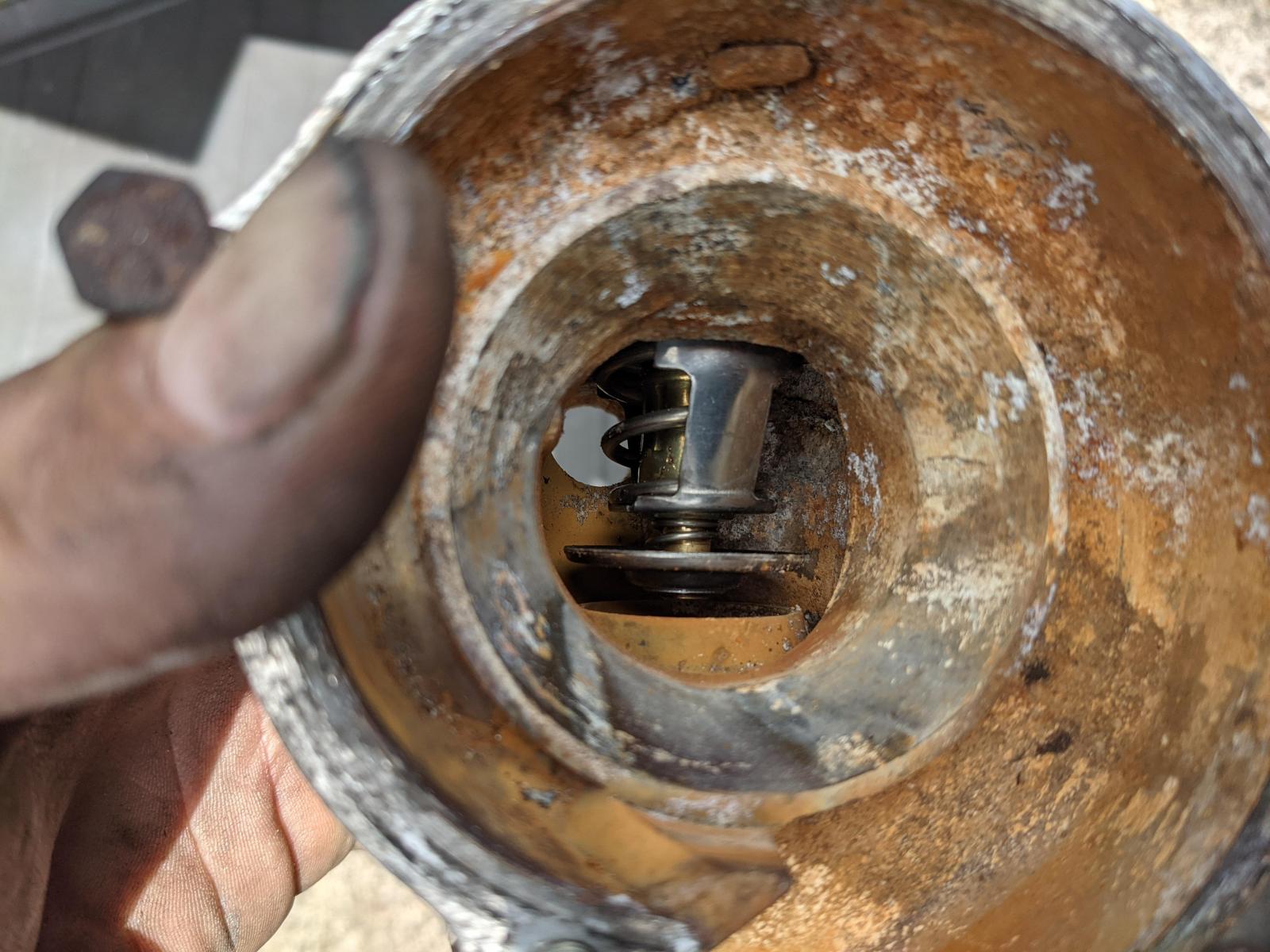

I replaced the brand new 80*c thermostat ( Wahler brand, made in France) by an 87*c thermostat ( Vernet brand, also made in France).
No improvement.
I ordered an original 87*c VW thermostat ( prolly made by Behr in Czek republic, manufacturer code BCH )
The thermostat arms are oriented vertical at 12 and 6 o`clock as to not interfere with the flow from the lower hose from the expansion tank.

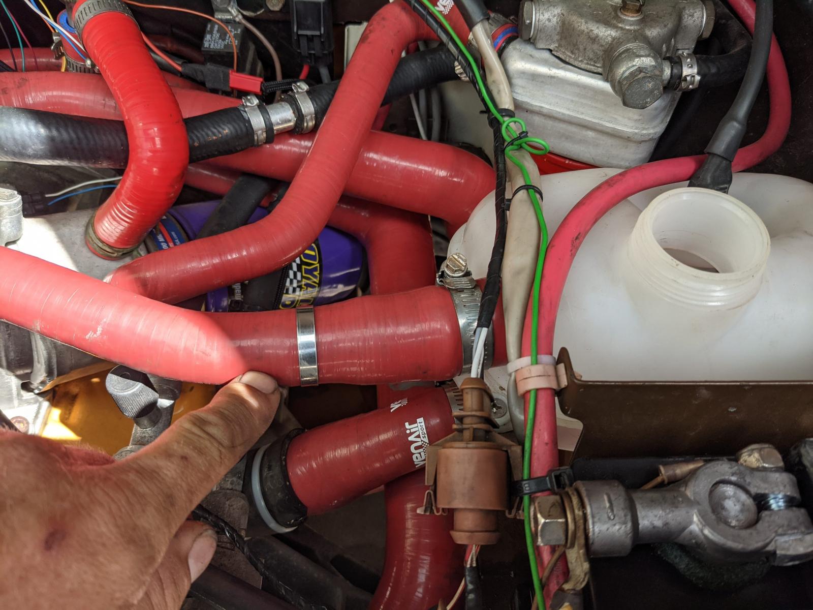

I had a dual oil heat exchanger set up, one exchanger is just a bigger one for the engine, the other was for warming up a possible veggie oil set up at the fuel filter. I thought it was trapping air, so I was, eff it, go back to stock set up, only the engine oil heat exchanger.
I do not know which way it circulates in there but from touching hoses, it seems like the cold gets sucked in the cooler and goes out into the hot hose then back to radiator.
My heater loop works like a charm, so the water pump must be working. It is a cast impeller water pump made by Graf from what I recall. The pump runs clockwise from the V-belt exactly like from factory. Correct size pulleys down to the part number, correct impeller angle ( in case there was a CCW running pump option out there).

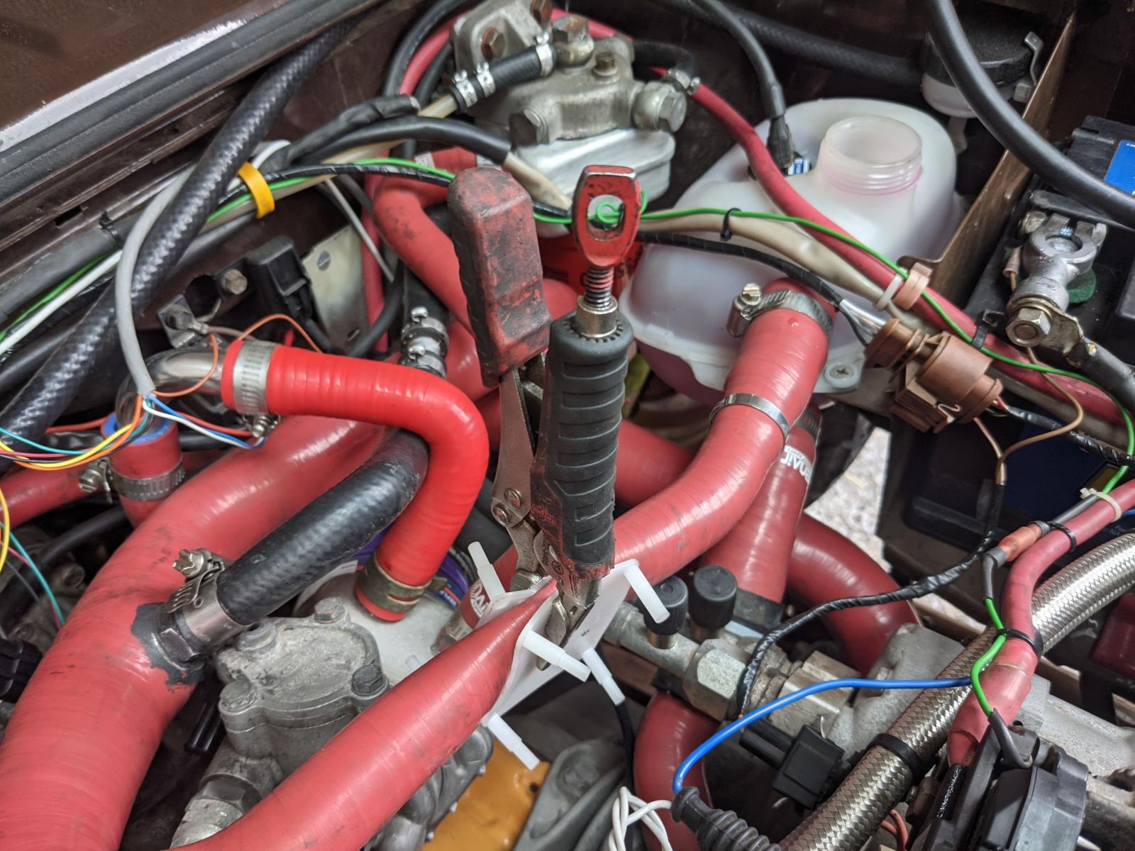

I tried pinching the culprit hose to avoid by-passing the radiator completely and force things to and from the radiator.
I need to do that next on the heat exchanger loop but I doubt it`s gonna make a difference, I mean in what world do you have to do that to bleed a diesel? This is becoming ridiculous.

The water pump left nipple ( top right on the picture here) goes to the cylinder head flange between the injectors. This hose gets closed when the thermostat opens. The gap is about 5mm.
The right nipple is the one from the bottom of the expansion tank, so you can understand without the restrictor on the top hose at the expansion tank it would by-pass the radiator completely. This port is always open fully.
The cold IN from the radiator is completely shut until the thermostat opens.

Three tips. The thermostat is clocked wrong. You want the tabs out of the flow. I always drill an 1/8” hole in the thermostat to ensure you have coolant on both sides of the thermostat. Last tip, I always fill the engine through the top hose on the cylinder head. Then I fill the cooling system. Don’t imagine the order matters. Then bleed as usual.
Why is the thermostat clocked wrong? What is correct then?
On this pic, I would call it wrong, so I put the arms vertical to not impact the flow as much from either side ( elbow in and the open nipple connected to the lower expansion tank hose)
I mean, I never had to do such extent of work ever on any diesel before, I never even considered clocking the thermostat nor drilling it which is not factory....
