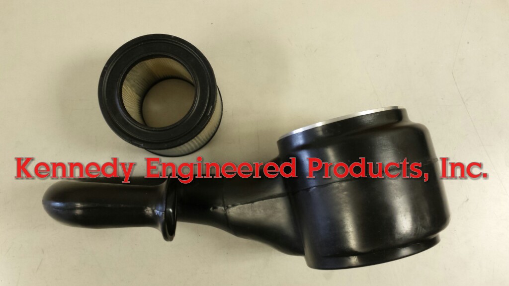

Kennedy also has an airbox.

Does anyone know where I can get a Kennedy Air filter? They never responded to my email.
pjn_wyo
Joined: April 22, 2019
Posts: 196
Location: Bellingham, WA
pjn_wyo is offline
PostPosted: Tue Apr 27, 2021 10:18 am    Post subject: Re: Subagon / Vanaru engine intake airboxes/airfilters.... Reply with quote
I emailed with them yesterday about wiring diagrams and parts cost. They replied quickly and they also answer the phone.

Intake looks pretty narrow on that Kennedy airbox. Not sure it'd flow enough for a Subaru 2.5l engine.

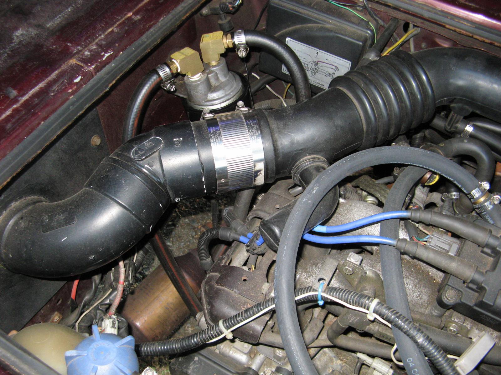

In my subaru conversion I did myself using a 1999 forrester 2.5 sohc - I used the Subaru airbox in the driver pillar. Needed a 18" 45deg hose (used pre made silicone) Ended up putting in a vanagon snorkel from box up to upper air intake to reduce high speed/rpm drone. 52k miles later still happy and it's nice to use a off the shelf airfilter. An happy with result
