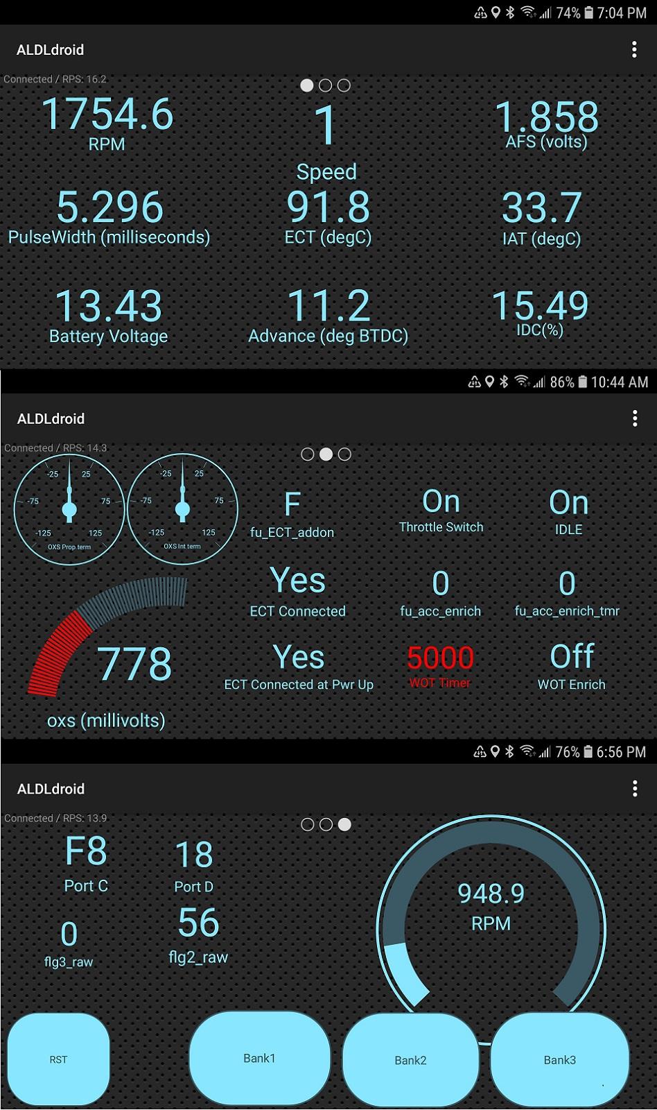

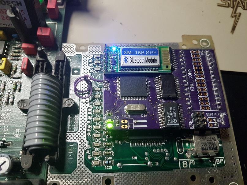

I have been working with a friend who developed an emulator for tuning his car. He developed it for the digifant ECU used in the 1.8L supercharged engine. After spending some time with him, we were able to implement changes to make it work with the Vanagon "D" version ECU. The emulator plugs into the chip socket and only requires one wire to be soldered in the ECU to get it to work. It looks like this:
The emulator currently has the following features:
    This board can replace old EEPROM chip permanently
    can load and store 3 banks (3 chip files)
    is powered by the chip socket
    works with ADLDdroid (low cost android application)
    works with TunerProRT (windows application)
    outputs engine data in real time via Bluetooth (needs custom TunerPro ADX file)
    allows data logging and playback
    allows easy and quick checking of ECU inputs like O2 sensor, temperature sensors, AFM voltage, throttle switch etc.
    Shows data with just the ignition on for trouble shooting
    can show GPS speed in ALDLdroid
    Can be used to tune/adjust chip tables like timing and fuel etc. in real time if engine modifications warrant it.(needs TunerPro XDF file)
    *** Update: Immobilizer feature that is settable to cut fuel and spark is now available***
Future features:
    more as we think of them
Here is a picture of 3 ADLDdroid screenshots with the engine running
Is this something that people would be interested in for their WBX?
Thinking $150 US for diagnostics version and $175 US for the tuning and diagnostics version. ALDLdroid app and TunerProRT and shipping are not included in the price.
