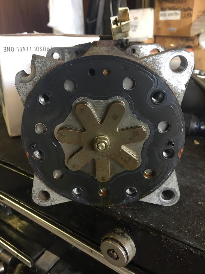

Everything else I got from the Van-Cafe. Here is a picture of the new compressor they provide.

One major issue I ran into was the hole on the back side of the compressor for the small hose was too large. We ended up swapping the back cover from the old compressor to the new one to ensure a proper fit.
The other thing is the high and low R-12 ports don't fit R143a machines, so you need to get adapters installed. I did not see this mentioned in any of the threads, but I might have just overlooked it.

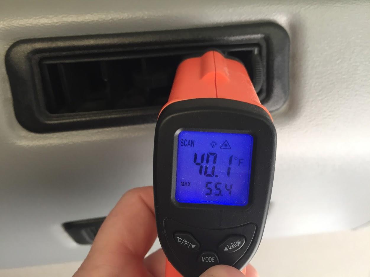

After everything was hooked back up I took it to a local shop and had them charge the system up. I am really happy with the results and it will freeze you out.
Last thing to do is to create a filter for the air intake at the back of the evaporator housing. Will have more on that after I figure out what I want to do.
Hopefully this helps those of you on the fence about tackling this project yourself. It wasn't nearly as bad as I expected and going with r134a made the project much easier. I didn't even need to buy any special tools. Sorry I didn't take more pictures, but it is pretty straightforward once you get going.

(85° ambient; 39° @ vents; 42° @ rear seat; 72° @ driver's seat)
