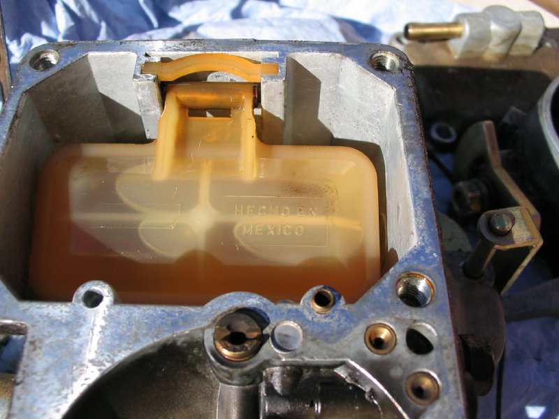

19mm = 3/4in which is correct fuel level for a Solex Pict carb.
Make sure the U-shaped clip that holds the float pin down (top of pic below) is oriented correctly as shown below:
Check if your intake is firmly mounted. Grab the carb and push-pull to see if the intake can rotate around the lower tube running between the end castings. There should be a bracket from one of the carb mounting bolts to the top of the case to prevent the intake from moving at all. Without this the intake could tilt the carb when you are pointed downhill causing fuel to overflow down the intake.
One more thing to check... fuel pressure. You ideally want something in the 2~3psi range. Much more than this and you can overwhelm the float.
Lastly check for any loose wires. If something were to short the ignition coil #1 (-) terminal it would prevent the coil from generating a spark.
AshMan40

PostPosted: Mon Jun 30, 2025 1:18 pm    Post subject: Re: High rev to idle too slowly Reply with quote
I noticed that throttle linkage was making some noise when the lever goes down. Possibly because the retaining rings on the pump arm were not totally in place.
It could possibly not allow the throttle plate to close totally the Venturi.
I put it in place and tomorrow I will test.
Thanks
