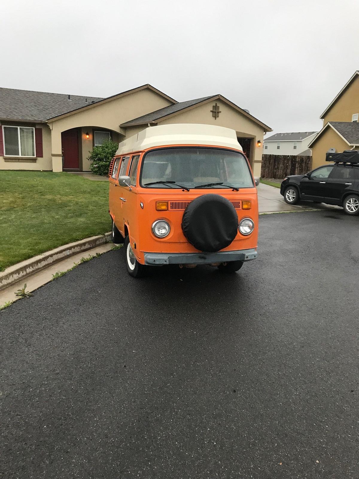

After a crazy night and flooding in some areas, the tow truck finally dropped off our new bus. It is a 1979 Riviera Penthouse model which seems mostly complete and original, besides engine/radiator/rear bumper.
First we plan on getting it running fully, the engine swap does run but it needs a belly mounted radiator which we plan putting in within the week.
Next up we will most likely recover the interior, and replace the cracked front windshield.

Congrats! More pics please. I have no idea what the "pent house" model looks like.

pretty sure that is not a Penthouse from sportsmobile. I would need to see the sticker/plate to believe it. (edit- I believe it) Also , you may have to look pretty hard for a replacement radiator. they are pretty rare, as they did not come stock. Laughing

The motor is from a Mercury capri, the radiator is an aluminum one with dual electric fans that will be mounted to some brackets that had been added underneath. The Westy group in my area looked at it and identified it as a Penthouse model, I will find some pictures from the previous owner and post them up.
Its a penthouse model from ASI, they made them in Vancouver WA and somewhere in Oregon.

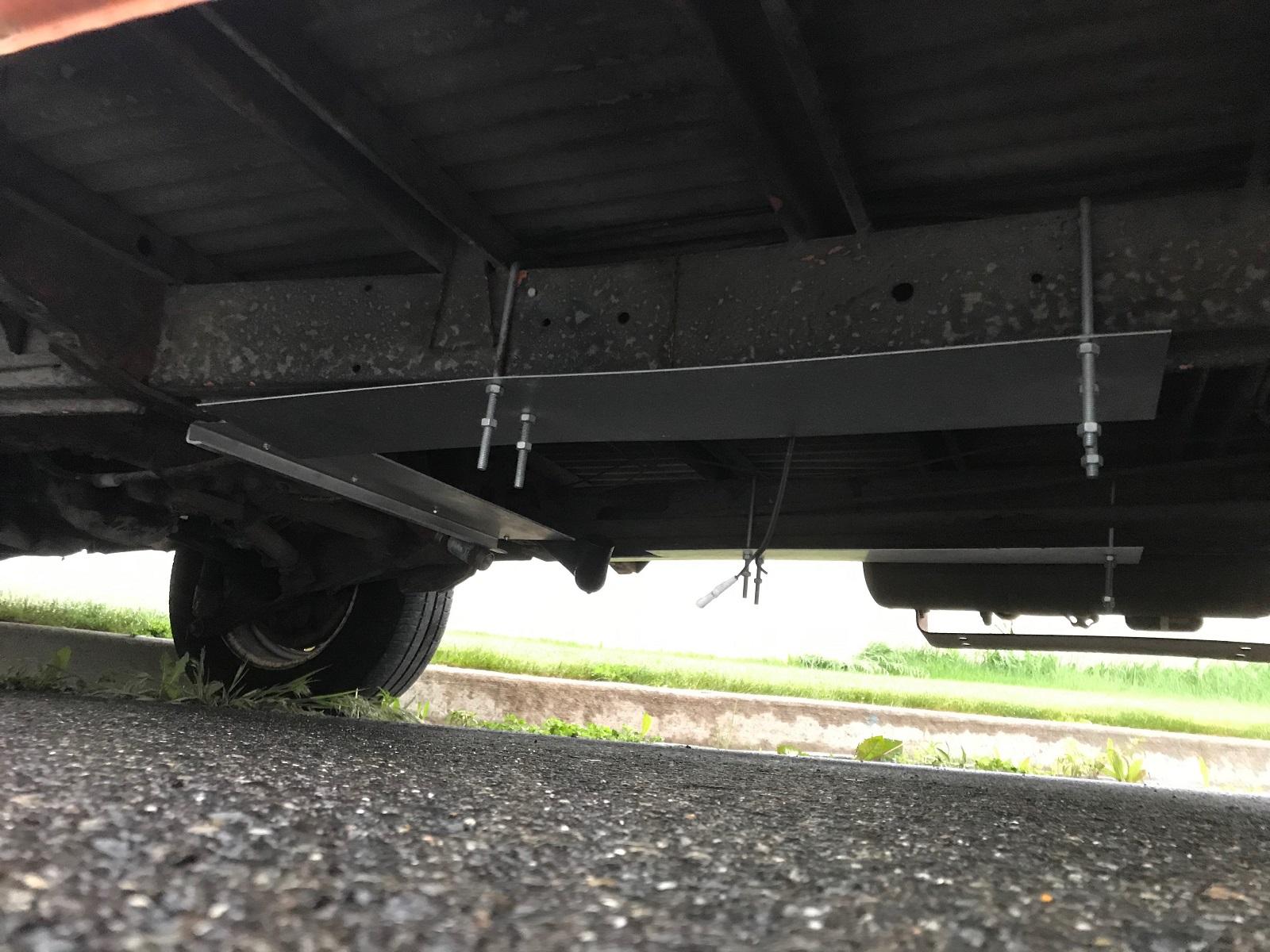

Here is the motor and the mount they came up with for the radiator, we are going to attempt to have the radiator installed tomorrow.
The bus looks to be in decent shape underneath and there is not too much rust we can see.

There is a guy I follow on Instagram that has a ford v6 six in his and he seems to like it. He mounted his rad up front like a vanagon and put a cool looking custom cow killer bumper on the front.

Yes I have seen many mounted on the front that don't look terrible. I would like to main the stock looking front end if possible. We will see how the belly mount preforms this summer.

You are right about it being a Riviera Penthouse.
Here is an old brochure showing the various lines offered by ASI...
