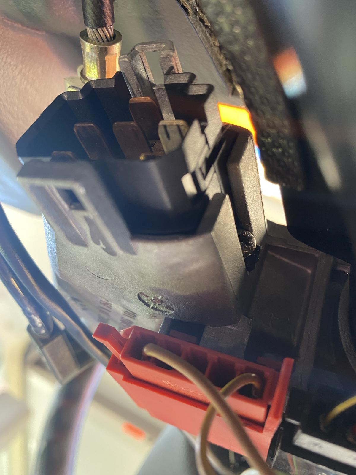

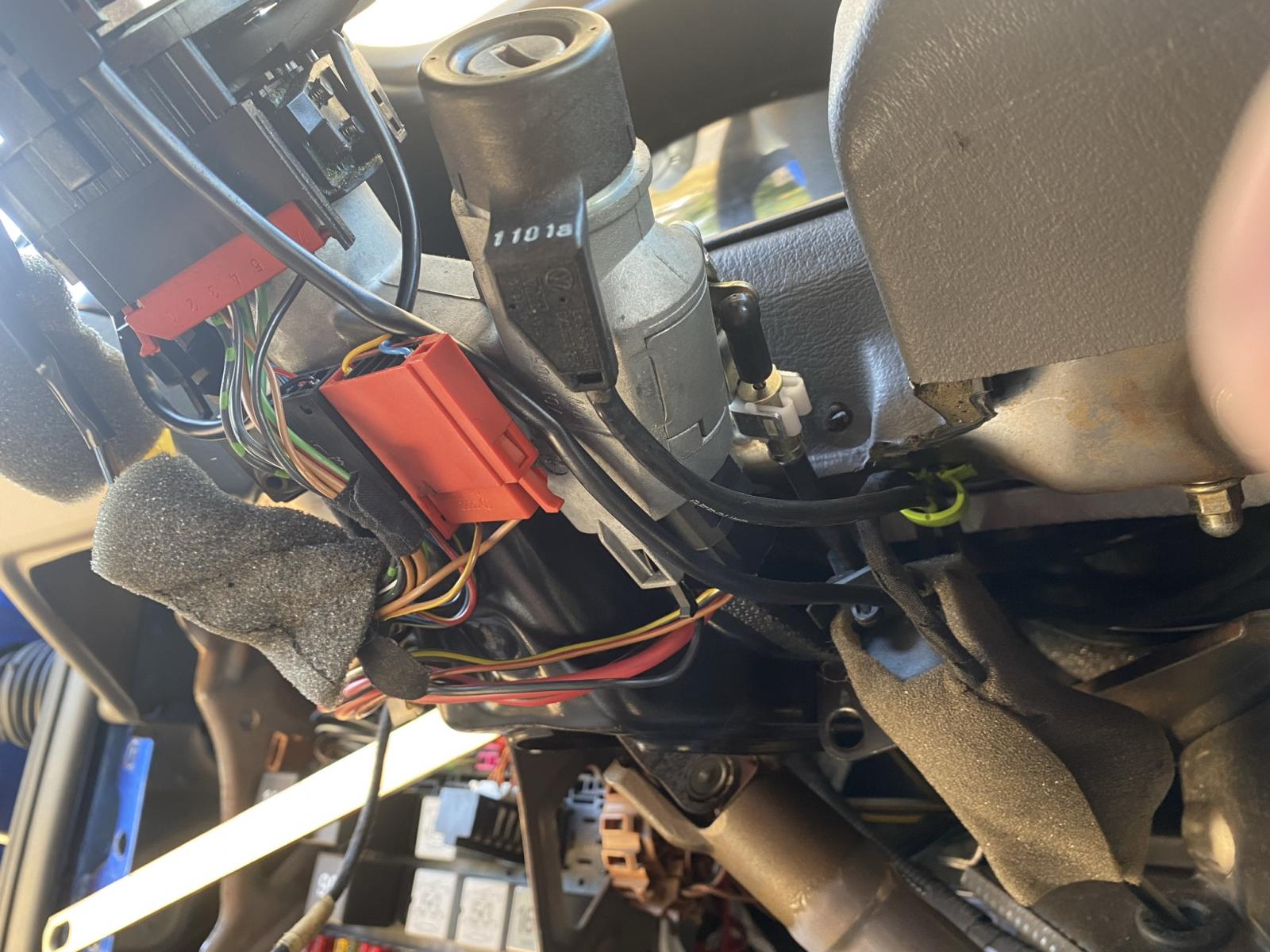

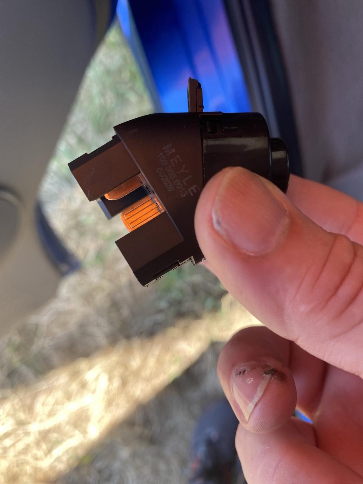

Hello
My family were all packed and ready for a road trip. Turn the key, nothing. I'm glad, it didn't happen on the road, but in our parking spot.
I assumed I would replace the ignition switch, like in vanagons, but apparently MUCH harder to reach.
Nothing... I messed with alignment of the switch, Nothing. I put in some silicon lock key powder, the key turns much easier now. But issues still there.
I noticed, when you feal behind the lock where the switch goes, nothing is turning or moving... which makes me think the Lock Cylinder got damaged.
I've asked my guru's, people tell me I can go to a locksmith to get fixed (few I talked to had no idea what I was talking about), and others tell me to just put a toggle switch. I don't mind this if it was hidden and almost be a kill switch, but messing with auxiliary power would be a mess and it isn't very clear.
I can drive it, with a screwdriver and the key in it.
My question.
If i replace the cylinder. Will my key stop working, or how does the chip interplay with the cylinder. I only have one key, and after this is over, i'd like to have 2 for a backup.
If I did go to a locksmith, what do I ask? And how do I make sure it'll start with a properly chipped key in the ignition.
I'm generally stumped. The cylinder is $180 on ebay, and I don't' want to buy if if my key stops work or the chip isn't working.
How does that chip work?
Sigh.. thanks so much, i've been sitting on this a month trying to figure out how to proceed, any help would be VERY APPRECIATED.
