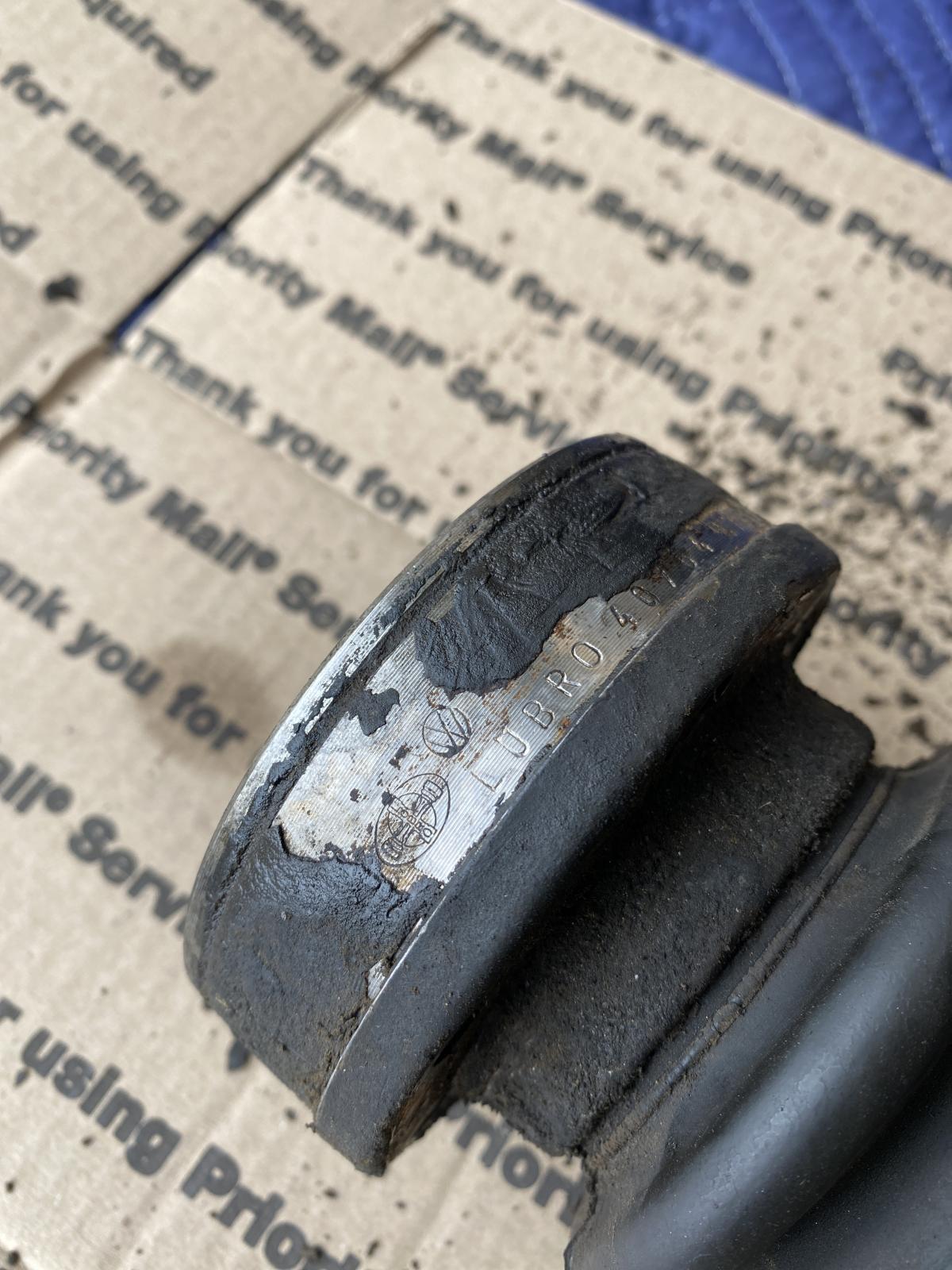

When I go to do my CV’s, is there a way to determine if my shafts are original German ones or already replaced with Chinese?
1986 Westfalia Vanagon, 2.2 Subaru
Okanagan Valley, British Columbia
Yellow Rabbit
Joined: August 31, 2005
Posts: 1169
Yellow Rabbit is offline
PostPosted: Thu Sep 02, 2021 11:07 am    Post subject: Re: Noisy axle or CV before and after replacement Reply with quote
Originals look like this:
