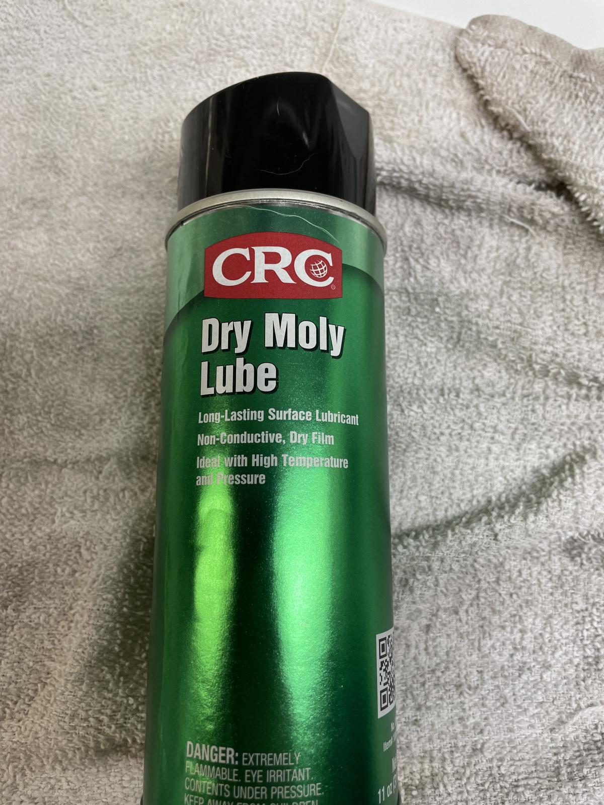

Another Version of similar lube...

like spices, i like having a variety of chemicals on hand, right DaveH? <grin>
this is good stuff, moly and silicone i think. dunno how it would be in the dust.
