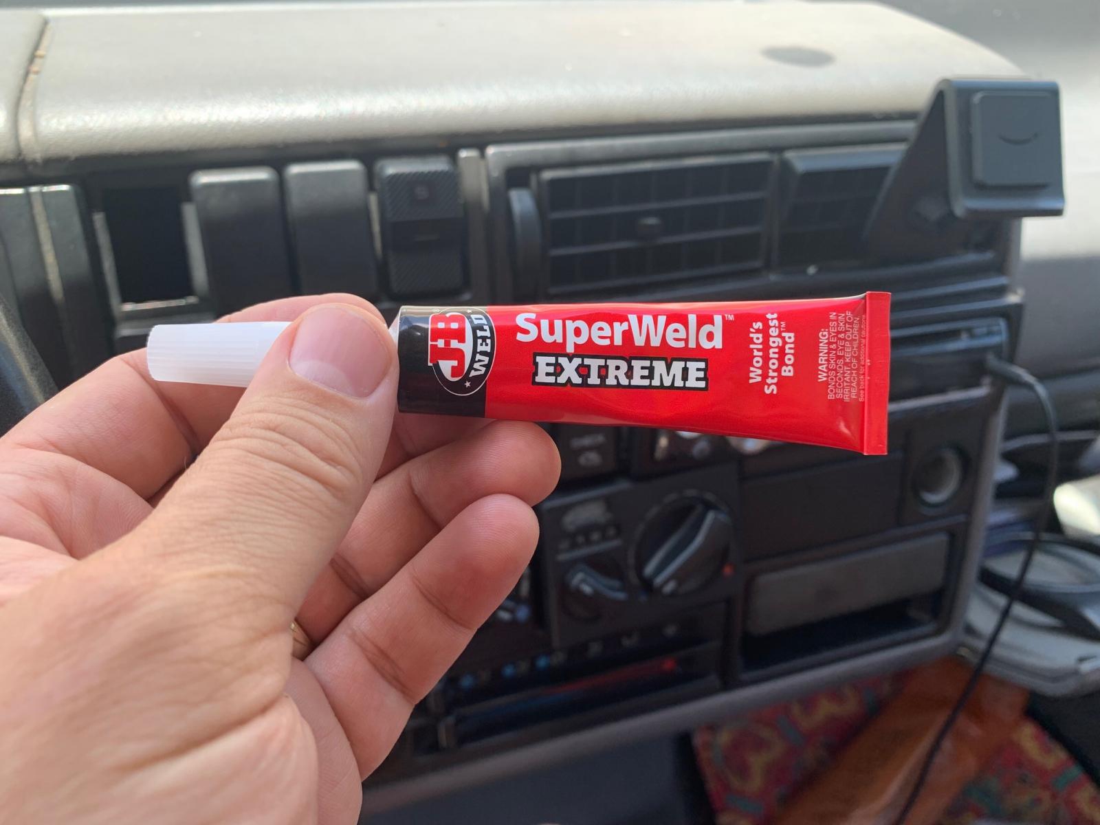

I wanted to update my thread. I finally got the rearview mirror installed on what I think was my fifth try. I tried two times with the Permatex that I bought, I then bought the JB Weld rearview mirror kit and still didn't have any luck. A couple of days ago, I was with my wife in Michael's craft store. I just happened to see that JB Weld had a product called Superweld Extreme. It worked on metal and glass so I figured that maybe it would do the job. After cleaning the glass, I installed the button. Within a few seconds, it was already starting to hold. It said to hold for a minute but I went about a minute and a half to two minutes. At that point, it seemed like it was on there. The instructions then said to wait 24 hours before it was fully set. I waited the 24 hours and installed the rearview mirror. It snapped on and the button didn't budge. My only concern now is whether there is an overall max temp before the glue melts. I'm in Central FL and about to enter summer. I guess if it's still holding by September then it did its job.
