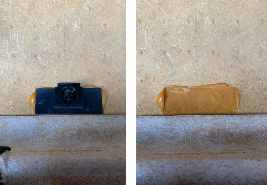

Now, let’s deal with those plastic studs that came loose. A cursory glance through that thread I linked in the introduction will show that people have had varying levels of success permanently reattaching these plastic studs to the interior of the door panel. It seems like the factory glue used to secure these loses its adhesion over time, but luckily it’s an easy fix, albeit a bit time consuming.
The below images illustrate the general concept for fixing these:
First, remove the plastic piece from the old glue (This should require no effort. If it won’t come off, then the factory glue is still good and you should probably leave that one alone)
Next, scrape away SOME of the glue. The factory glue does not provide a good base on which to add new glue/epoxy. This is where others run into issues with the permanence of their solutions. That’s why we scrape away some of the old glue…but why not scrape all of it?
You’ll notice that the old factory glue leaves a perfect impression of the plastic piece, allowing you to easily line it back up. It’s vital that everything is lined up properly, so retaining some form of these templates is incredibly useful to us when reattaching the plastic pieces.
To recap so far: we scrape the glue in order to give ourselves a nice surface to adhere things to, but leave some of the glue around the perimeter to guide where the plastic pieces will go.
Next, apply a generous amount of JB weld (or JB kwik) to the underside of each plastic piece. If using JB kwik, work fast and make small batches because it dries VERY quickly
THIS IS A PERMANENT SOLUTION AND CANNOT BE UNDONE WITHOUT DAMAGING THE PANEL. With that being said, ensure everything is lined up properly before adhering with JB weld. Below are images of how mine are attached. This worked for me, but I cannot guarantee the alignment is the exact same on your door/panel, so use your best judgement.

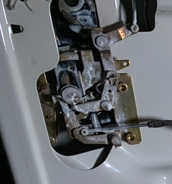

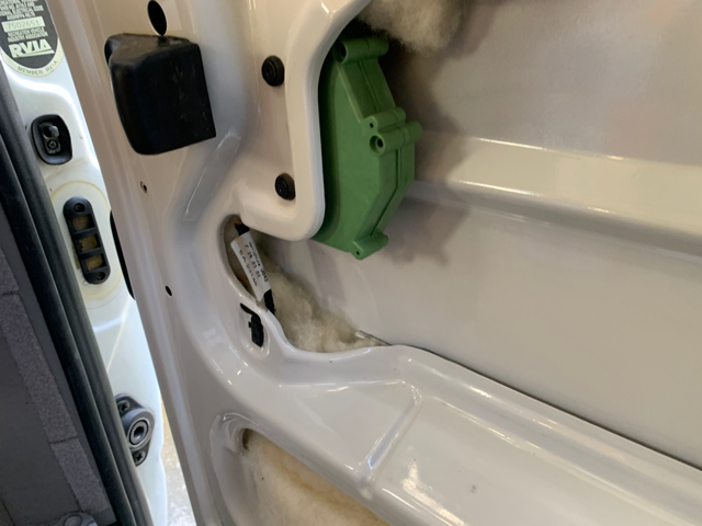

Locking mechanism
This part was pretty straightforward. I just took a clean rag and wiped out all of the previous grease/gunk that i could. The image below is after adding a few test spots of white lithium grease
And this is after going all out with the white lithium grease.
Did I overdo it? Maybe. I have no clue. Don’t do what I did here. Or maybe do? The choice is yours.

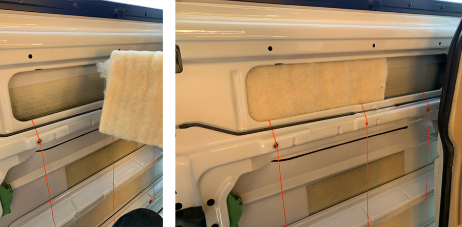

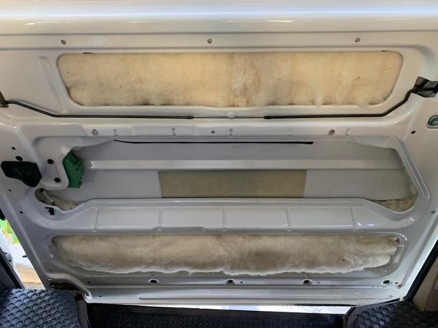

Wool Insulation
I purchased some havelock wool to stuff into some of the crevices in the door while I had the panel off. It supposedly helps with sound dampening and a few other things, so I figured it couldn’t hurt. The wool itself is relatively expensive though, so I just bought the “small” bag for $150 + $15 or so for shipping.
I put small in quotes because this is what I got. This is a large box, absolutely stuffed to the brim with wool. Based on the amount I used for this project, I’d estimate close to an entire Eurovan Camper could be insulated with just a small bag of this stuff.
One thing to note: this stuff smells somewhat like a barn. I guess that shouldn’t be surprising considering that it’s literally just wool, but it still surprised me. Once behind paneling though, any smell is completely nonexistent, so it’s definitely no huge cause for concern.

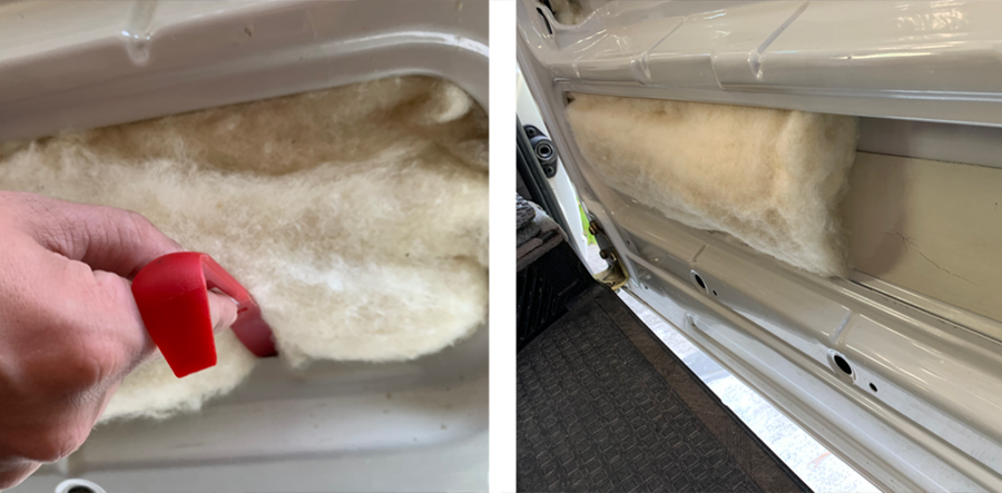

After cutting out a few test pieces to get a feel for the stuff, I began to stuff pieces of the wool into any cavities the exposed door frame had to offer. You can close your door for the rest of this section. Pictured below is the only real good place to stuff insulation on the door. The rest of the spots require a bit more work (disregard the orange strings. They are from a failed test)
Be sure to add wool all the way to the top inside the cavity. It goes quite a ways up inside of that lip, so fill everything. After that top cavity was filled, I began to stuff the bottom most section of the door.
This required me to use a trim tool to stuff any wool I could into a little lip below, as there’s nowhere for the wool to get a good grip. (You can use something like strings or tape for this, but I wanted to minimize anything extra holding the wool in place)

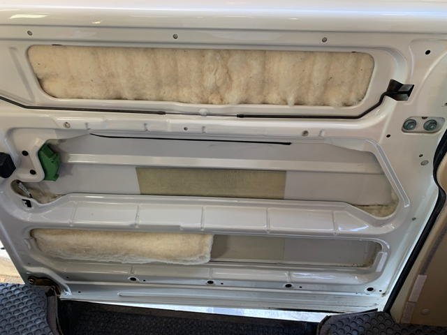

Finished top and bottom cavities completed (pictured below)
I then took this opportunity to fill every hole and crevice I could fit my fingers into. There are many on the door, so be thorough.
Finally, fill out the middle section. This stuff compresses well, so don’t worry too much about the concave indents in the door panel. I broke my own rule about no extra measures of holding insulation in here, but there was really no place to wedge this without some string or tape. I ended up using basic scotch tape, and it worked perfectly. I only needed these two strategically placed pieces to hold everything in
All done! All that’s left to do is close everything back up.

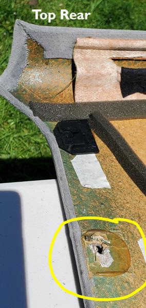

We have damage to our door panel where the rear screw goes through: The rectangular plastic spacer is missing. Without getting into the weeds with original parts, does anyone happen to know the THICKNESS of the spacer? This is one part we can jury-rig.

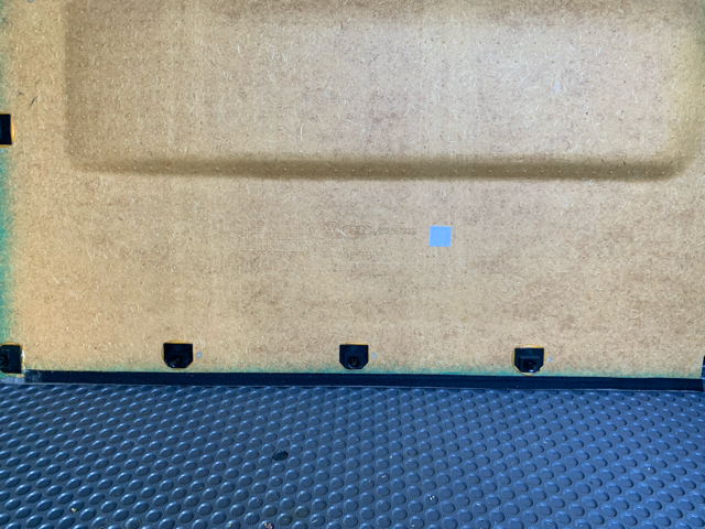

Thanks for this thorough step by step process. I recently heard some odd rattling on the door area, and when got to campground noticed a loose door panel and locking mechanism wouldn’t work.
Popped off the panel, and all but one of the plastic plates fell to the ground.
I’m about to start the gluing process, but noticed some of them have different thicknesses, specifically the ones the are square, but with three angles on one side.
I’m wondering if you noticed this, and where the thicker ones go?

Here are the locations for re-gluing the sliding door clips. I used E6000 glue for reattaching mine. I think I replaced the rearmost center clip with a 1" x 2" x 5/16" piece of plywood and a second screw.

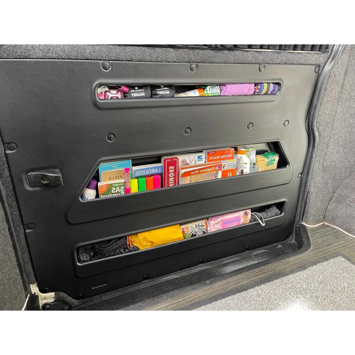

Has anyone used a Riv-Nut solution and stopped wasting their time with this panel? I have been trying to get one of the storage door panels from Kirvans in Europe but they don't currently ship to the US.
https://www.kiravans.co.uk/products/kiravans-vw-t4-transporter-doorstore?variant=41930724901064

I've put a lot of rivnuts in my EV but not to replace that panel. I like that idea and I've been wondering about ways to use that space better. I've seen some conversions that put a table top in that location even a drop down toilet, https://www.spacecamper.de/toilette.html.
But, you can also just modify the existing panel like here:
https://www.thesamba.com/vw/forum/viewtopic.php?p=9236224#9236224

Fun pics! Now that I've seen those, I have to do something. I can't find anyone that has the little mounts that have fallen off my panel. I see some people just using wood and screws. I think that if I figure out a way to get template made and then get all the holes drilled into the panel cleanly, then mounting with wide headed screws would look good. That's the thought anyway. Thanks for the pics!

I'm currently in the process of cleaning up my sliding door panel on a "new" Weekender - it had the familiar issue where the lock knob wouldn't slide up and down when the central locking mechanism would try to pull it down. So, I'm cleaning up all the old glue following the guides that have been posted here for a while.
Having looked at these clips (and the associated plastic pieces that come unglued and fall off of everyone's pane) a lot over the past few days, I'm fairly certain that the push clips that eventually push into the holes in the door's metal should be placed into their associated plastic "holders" in the card/panel first, and then, as you're installing the trim panel on to the door, you push the clip "pins" into their respected holes in the steel. I say this because given that the trim pieces on the door card (into which the clips slide) are not all facing the same way, it would ne nearly impossible to push in any one direction to "slide" the panel onto all 15 (or however many there are) clips pins at once. You'd have to slide them in at least 2 or 3 directions - it seems like it would be a fool's errand.
When I get ready to put my trim panel back in, I'll be putting alll the clips into their plastic holders on the trim panel first. Hopefully I get 15 good clicks this time and the lock knob goes up and down with no issues.

Referencing the picture above showing clips P, O, N and V…
These clips are asymmetrical in the sense that there is an opening on one side to slide the mount in.
Do these face in or out? The reason I ask is because going by the original location, mounting them facing in versus out will put the opening for the mount closer or farther relative to the edge.

Here's my trim panel (from a 2003 Weekender) all glued up and ready to re-install (tomorrow after the glue has cured).
Hope the photo will help with last poster asking questions about which direction pieces face. I kept mine in their original positions ...
I own a 1997 EVC as well and this Weekender is new to us - appreciate that VW added the carpeting as soundproofing. I also added a layer of Dynamat to the door recesses.
