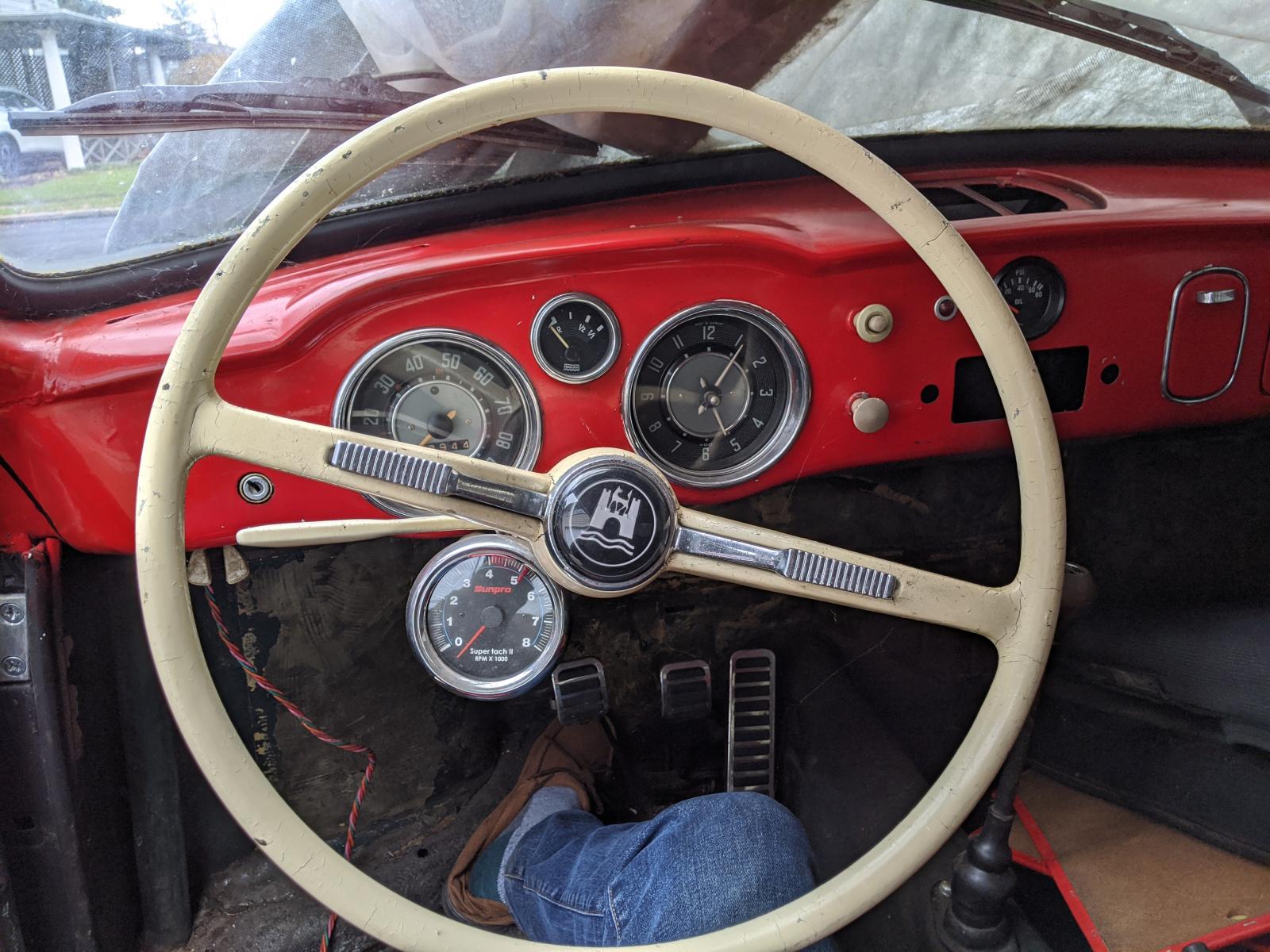

I need to begin getting various missing parts. I'm new to these cars. Does this dash look reasonable complete?
After market tach might stay or might go. Any thoughts?

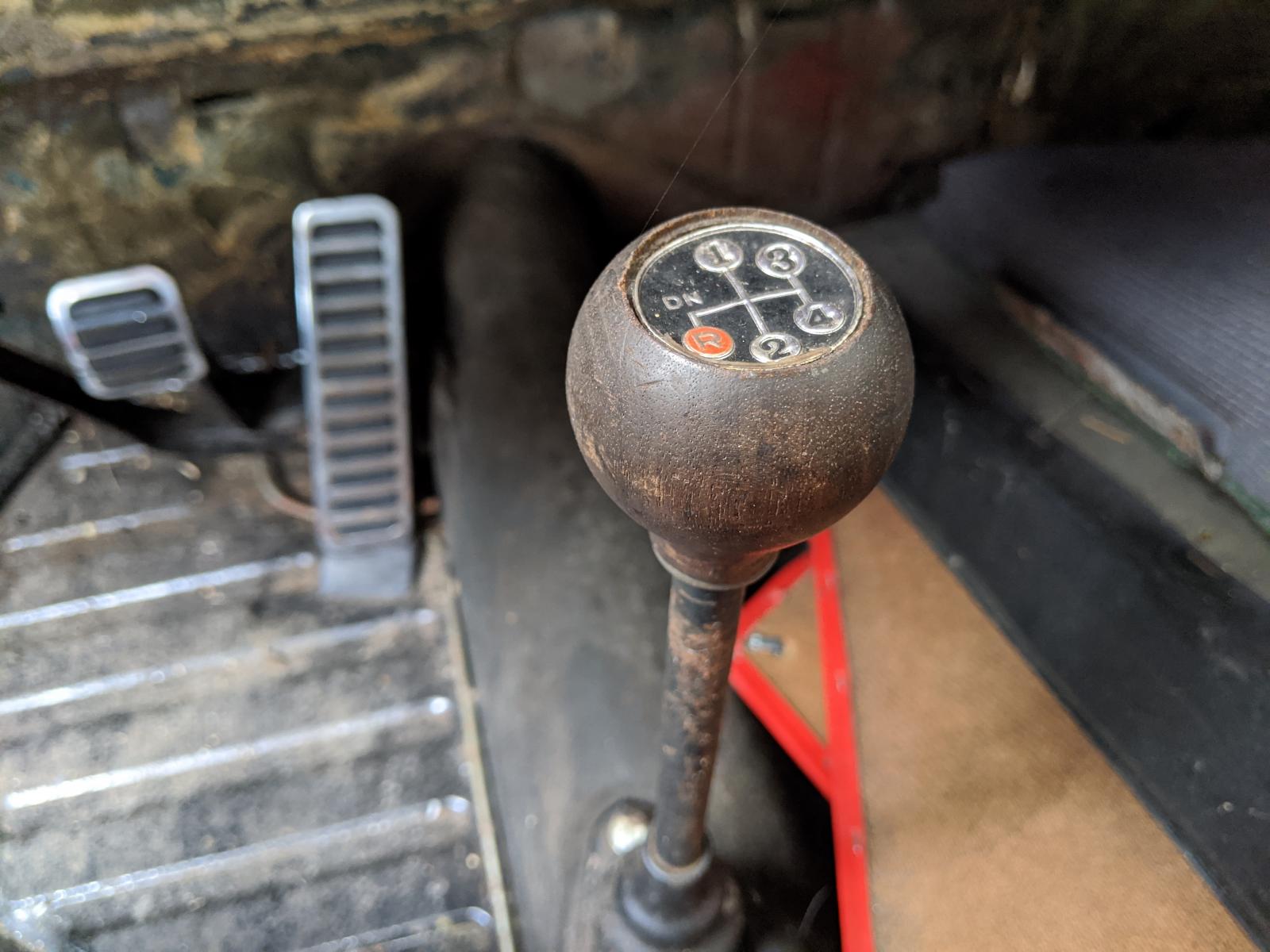

Same can be said if this aftermarket pedal cluster and gear knob - probably replace with Stock
What goes in that hole?
And how hard is it to find a descent period looking radio that works?
And did that pressure gauge replace something stock in that spot?

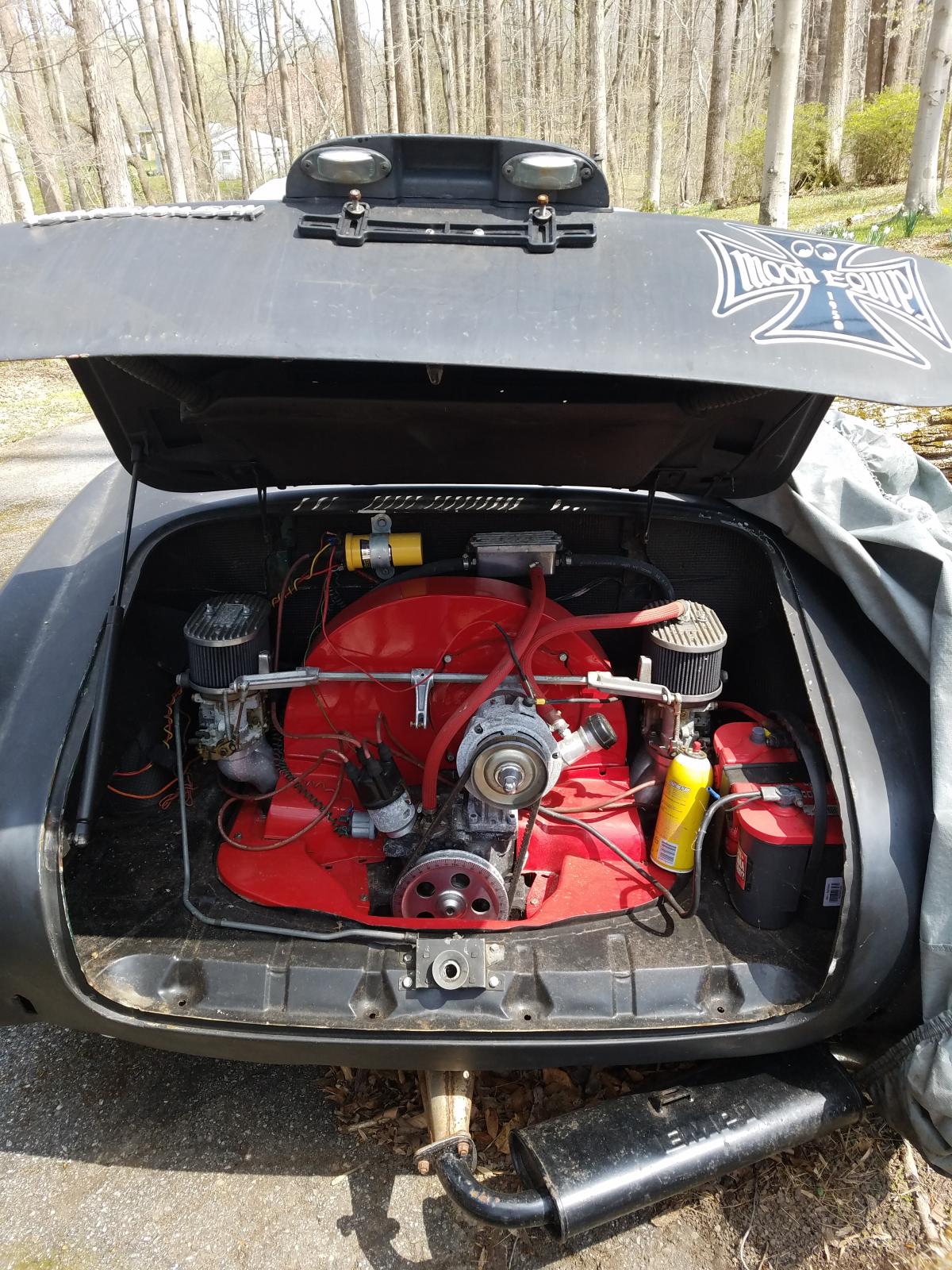

Here is the engine. Not sure yet whether I will keep this or return to stock.
The oil pressure gauge is a previous owner add on as is the red lite next to it. The rest looks good. Top of dash missing part is for a speaker plus a speaker cover, there are 3 and 4 row versions. 4 row for 65 as I recall.
https://www.thesamba.com/vw/classifieds/detail.php?id=1945447
Those are probably just covers on the pedals, its the original pedal cluster under the press and sticks.
Looks like a Beetle hood pull under the dash.
I like tachs, you could find a better fitting and looking one IMO. Lots of options, use the search feature in Forums and Gallery. Same for a radio, use Search button in classifieds.
https://www.thesamba.com/vw/classifieds/search.php...ords=radio

If you decide to keep the engine, give that exhaust some love. The muffler hanging out on the merge looks out of place. I built my muffler to hide under the engine.

Yes, the muffler looks pitiful. I'm a stock engine kind of guy, and that engine looks like it might get me killed one day, haha. I'd like to test drive it just once to feel it out before I decide. Maybe before the tear down *if* the brakes are solid. If I stick with it, then your muffler looks much better.

Originally the car had a black dash top. Your car has been apart and put back together several times. The windshield rubber is "Cal look: style, not original either.

The 65 had a dash pad and you can get a fiberglass one from KGPR I think. I went with a painted dash as i like it better.
there is a dash grab handle (you might have cant tell)
tach- can convert clock to tach or ISP might have them now (often clock doesnt work well)
The pedal pads will pop off.
Radios are available in classifieds or you can go retro radio and i think they work
your horn and horn bar are correct for 65
wood shift knob was a popular swap (not original but looks nice)

Your engine lid is from a later Ghia such as '70 onwards. It has the plastic water tray under the vents. It also has a single hydraulic strut to hold it open, because your dual carb air cleaners would've contacted the two hood opening springs so that a PO removed the springs.
Also, your engine sheetmetal surround to the rear of the engine- which has those longitudinal ribs- is also from a later Ghia such as '67 onwards. So look for signs of crude welding on that panel. When VW started with the 1300 engine for the '66 model year, it had an oil bath air cleaner that hung to the right. The '65 Ghia still had the 1200 cc 40 hp engine and its air cleaner hung to the left, with the battery on the right. So for the '66, the battery was relocated to the left side of the engine bay. If your battery does not have rust underneath it, that would be an unexpected bonus. What I did for my '64 Ghia Cabrio's dual carbs was to relocate the battery to under the rear seat cushion in the location where it is on a Beetle. If you choose the battery size carefully (Group 42) the height still allows the seat cushion to sit almost fully down. Having the battery out of the engine compartment allows much better access to the right dual carb.
The '65 normally has a black pebble-grain vinyl dash cover with perforations for the radio grill. My '64 has its factory original cover. The separate radio grill was discontinued early in the '64 model year; my car was built in spring 1964 so that it's "late" in the model year and has that newer style.
You have the Ghia-correct knobs for the wiper and headlamps- another bonus. Your dash holes for the radio are original and uncut- quite a bonus. I would strongly recommend not to cut the dash to fit a new style radio that usually needs a larger rectangular opening. In all the 35+ years I've owned my Ghia, I rarely turn the radio on and prefer to listen to the engine and the driving sound. In my first years for building my engine I had some failures, so keeping the radio off let me hear the engine better. Embarassed Some people find a period-correct original style Ghia radio that fits the dash openings, and have the radio guts fitted for 12 V and modern components.
I suggest to keep your current engine, at least keep it in your possession if not using it for the car ultimately. My engine is a nearly stock 1600 dual-port with Weber 40 IDF dual carbs, and loves to run fast on the highway.

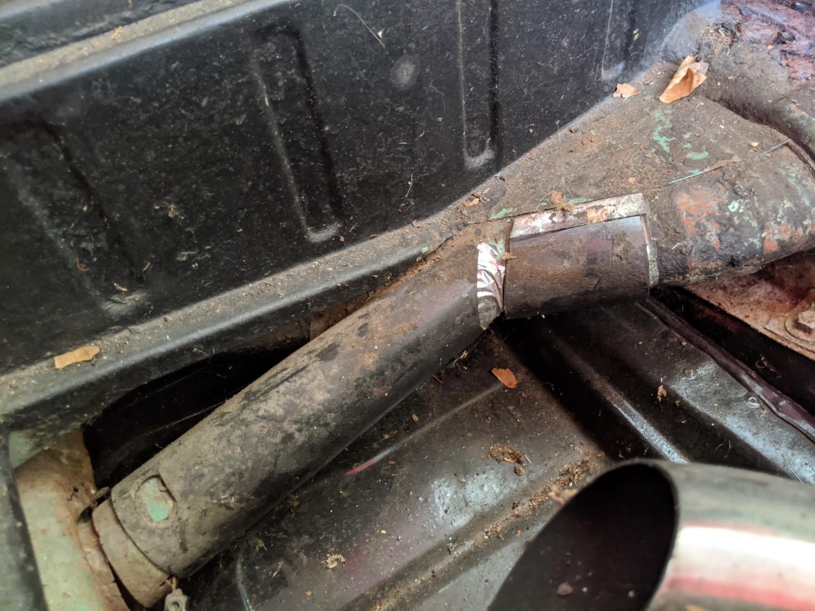

Thanks, guys, for your tips and info. I spent a few hours with the Ghia yesterday. I'm still in the process of assessing things and acquiring missing items before paint stripping and metal work begins in the spring.
I am missing the exterior chrome 'scraper' trim along all four windows. Expensive stuff. I'm also missing the scuff sill plates. And I am missing the arm rests on the door cards. Is this stuff any cheaper at the VW shows relative to Samba?
My dash does not have the handle - I'm guessing the mounting holes were filled in for painting. I have not seen the grab handle for sale anywhere
I removed a bunch of stuff. I'll start with what looks to be mostly good news. The package tray area looks pretty solid - this area usually rusts out in old beetles.

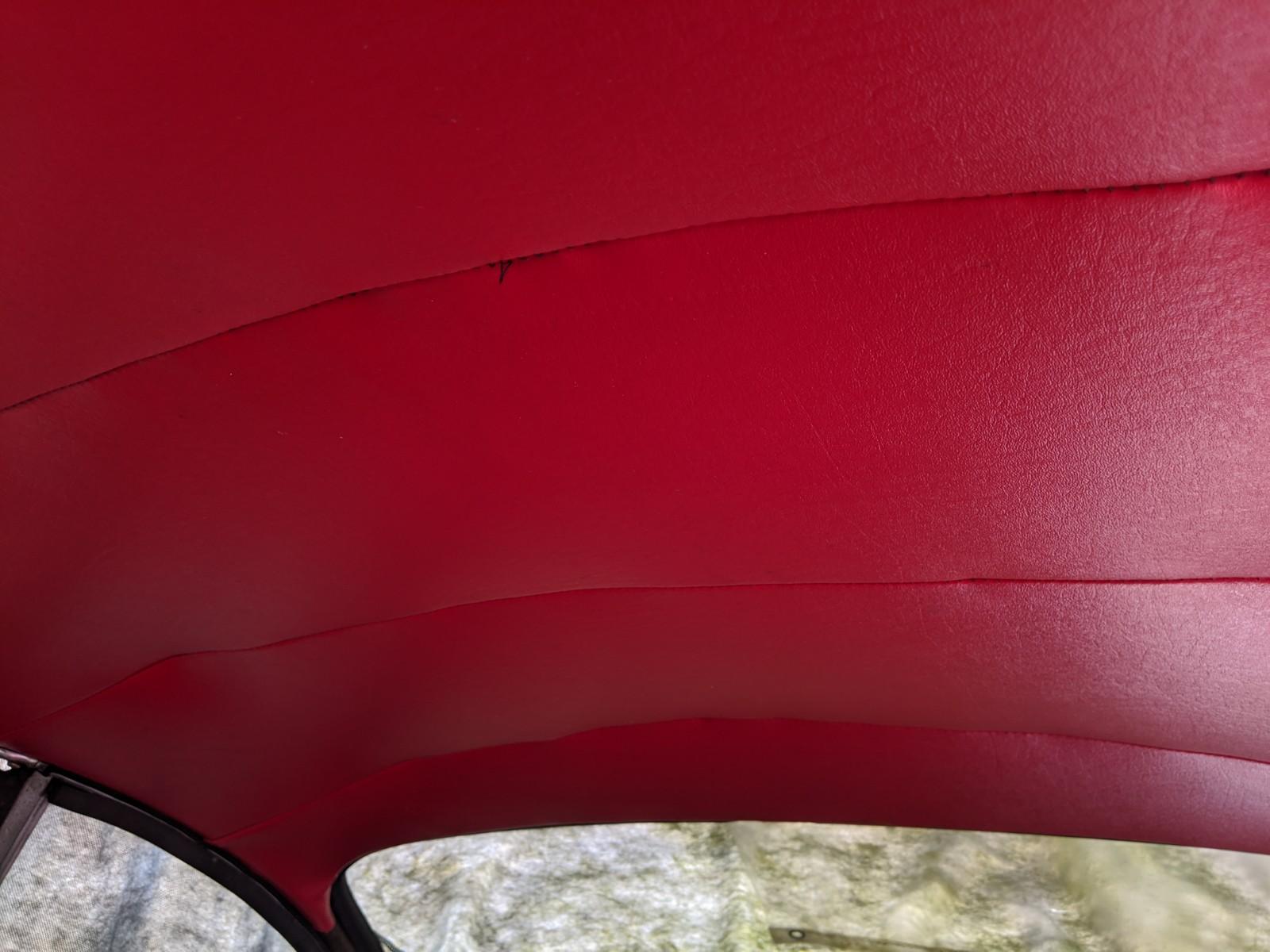

The headliner is fine (if you like red)

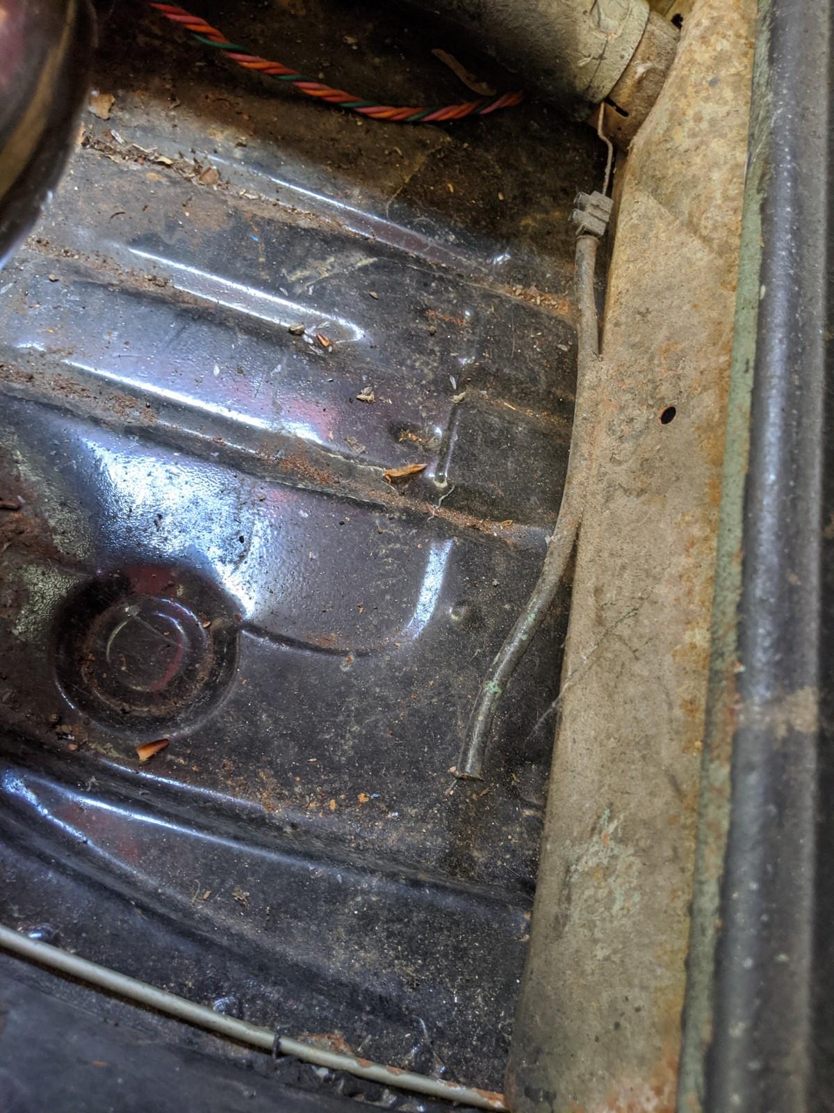

The floor pans look aftermarket to me, but the dogleg areas appear original and mostly solid. Some metal work will be needed but hopefully nothing too invasive. Note the extra wiring harness for the dash toys. Note also a blue paint behind the glue on the passenger side - a replacement piece for sure

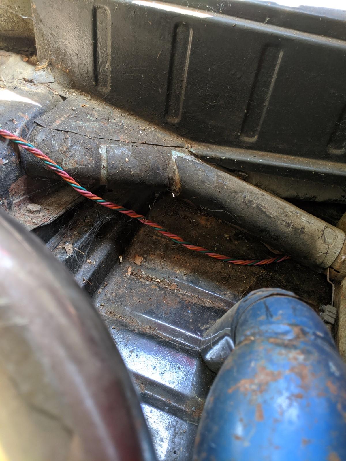

The heat tubes are intact - even the cable tubes are present and accounted for:

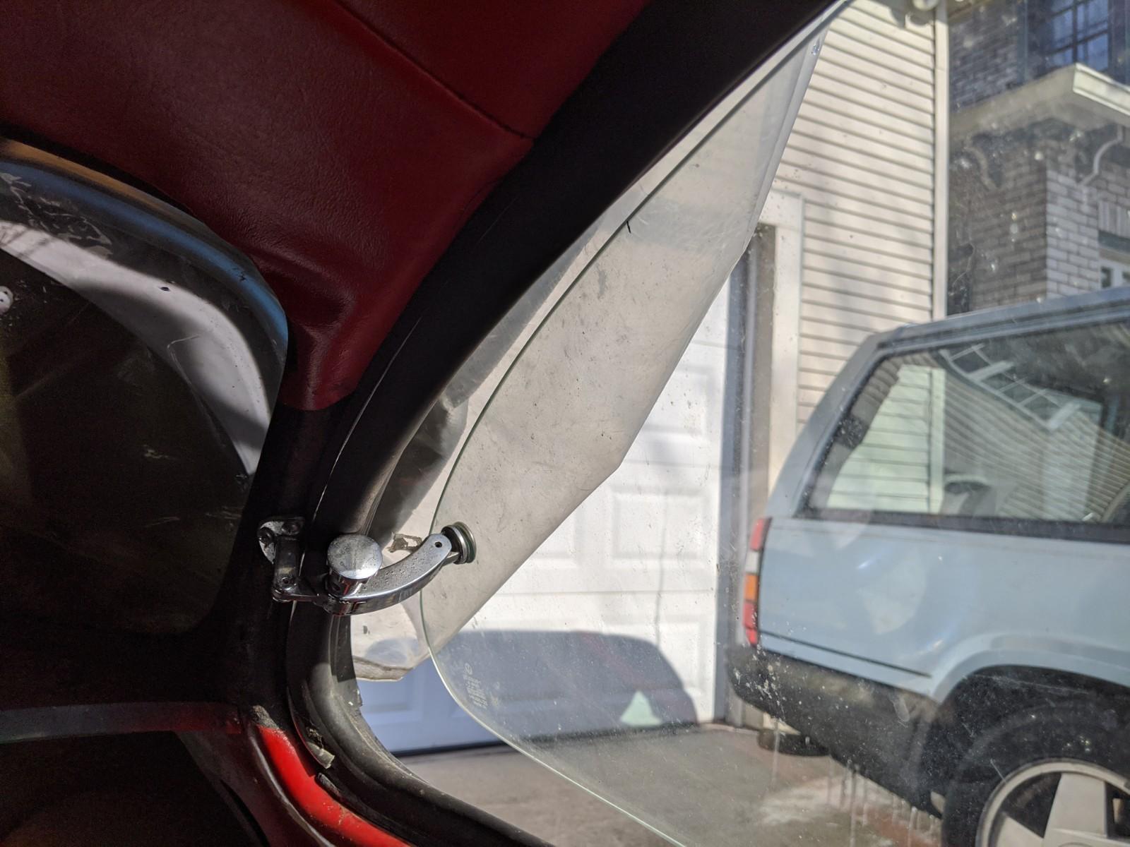

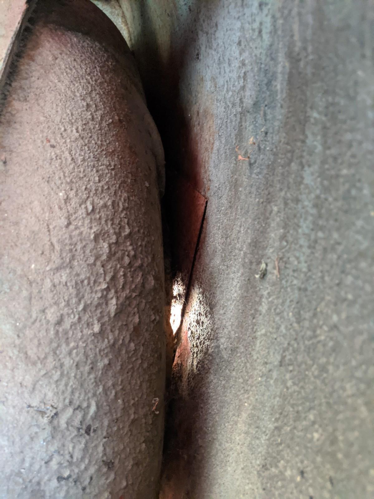

The pop out windows work
And the front crown section, when viewed from the inside, is largely unmolested although the lower metal probably needs replacing
Here is the front hood (no spare tire)
I guess I'm starting to feeling pretty good about this project - although I hope I don't get too cocky.

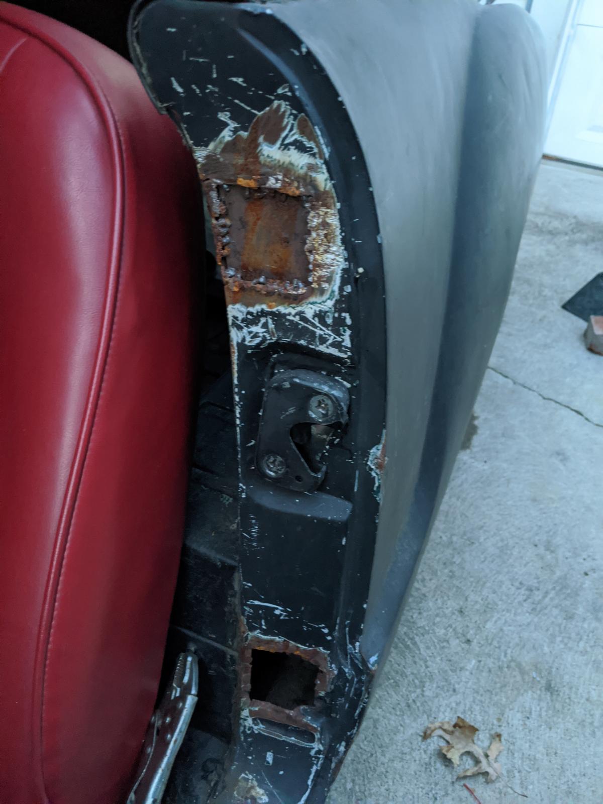

Some troubled areas for sure. First the spare tire well metal looks pretty bad - the big ugly hole is for the bumper bracket. The rest has POR 15 - I really hate finding that stuff.

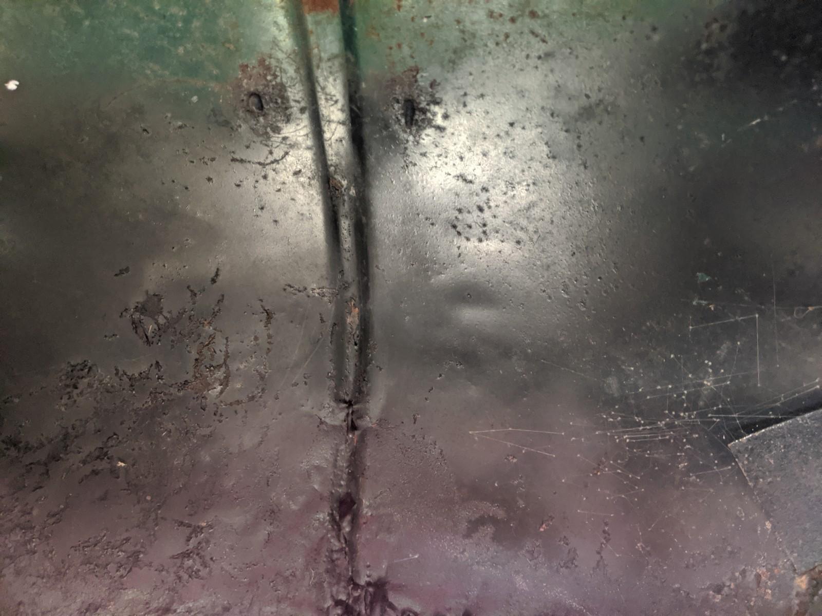

Second - I see an ugly sheet metal repair (see the corner?) when looking back from the quarter panel on the drivers side. I'll have to address that.
I also have a few questions. First - is this switch, located to the left of the pedal cluster, for high beams? Factory?

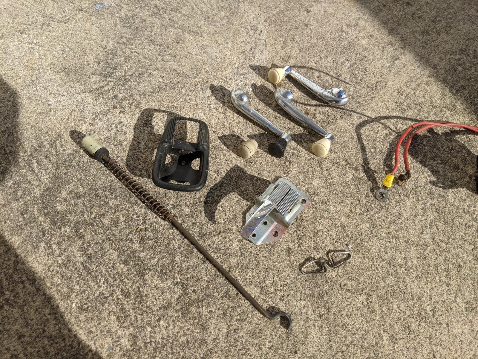

Second, with the door cards (also red - too much!) I found two arm rests. Factory?
Third, with the door hardware is that long pole with a white knob. What is that for?
Fourth, these rear seats and covers look original. Any value in trying to save these? Or is new upholstery the usual step?

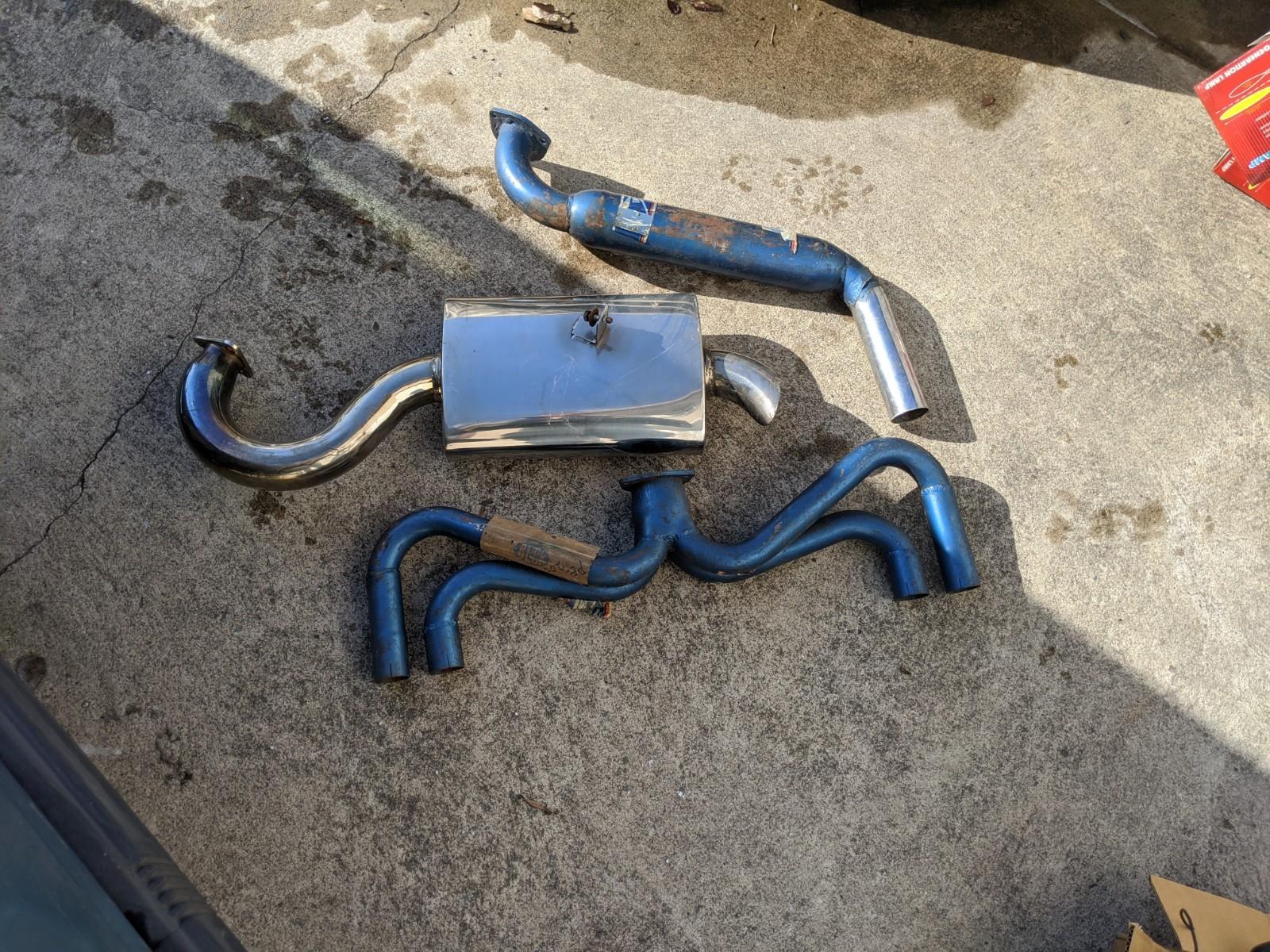

Finally, these unwanted mufflers were in the car. Is there a market for this stuff?

long pole with white nob = hand brake release
dimmer switch looks correct to me
others will know more

arm rests, aftermarket.
https://www.thesamba.com/vw/classifieds/search.php...s=arm+rest
Samba classifieds to off the stuff you wont be using.
Look from inside to see where dash handle holes are. Find replacement in classifieds, pretty common.
https://www.thesamba.com/vw/classifieds/detail.php?id=2432582

As far as the mufflers are concerned list as local pick up or sell on Crags list as the shipping now days will void any sale when you find out it's $50 .00 to ship a used muffler. If you are on a budget you can buy Vinal spray paint to get rid of that awful red.
