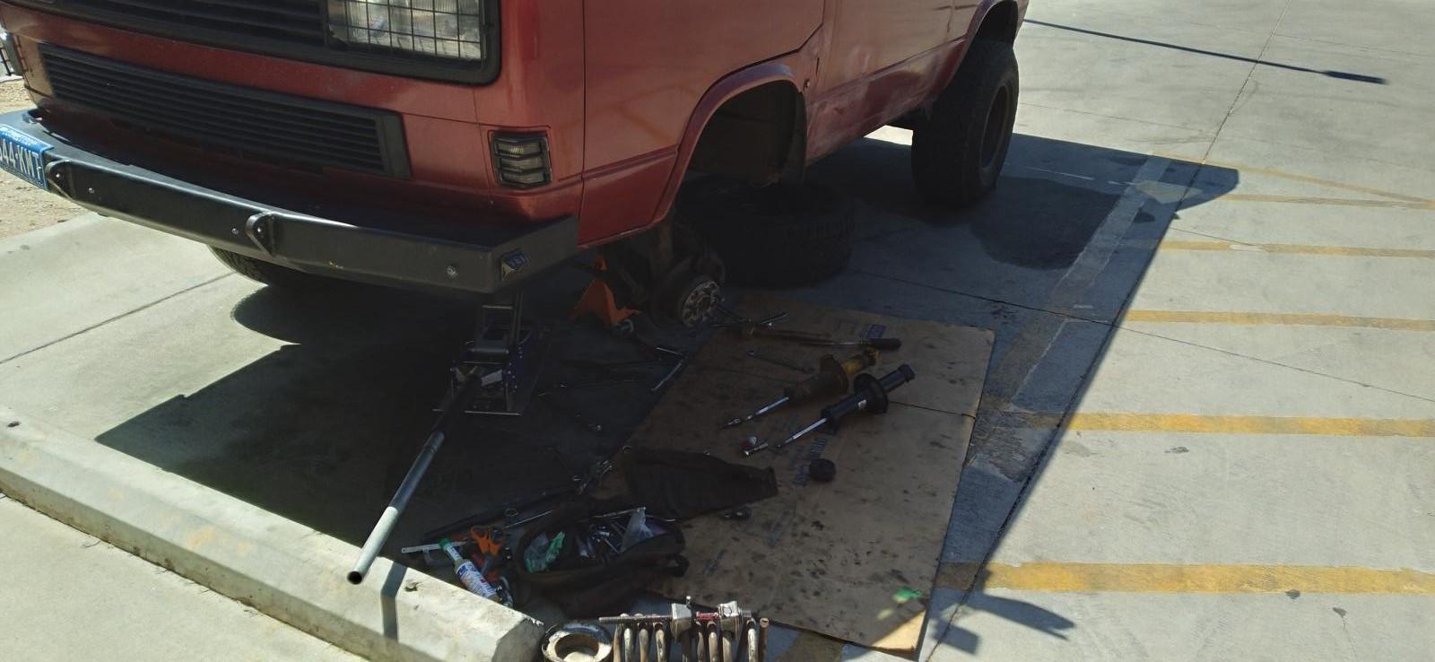

I broke a shock out in New Mexico last year. I replaced the shock in an Autozone parking lot using their rental strut compressor (link below). It worked fairly well.
Later, I bought the same one, and made some modifications to it. I keep it in the van with my other tools.

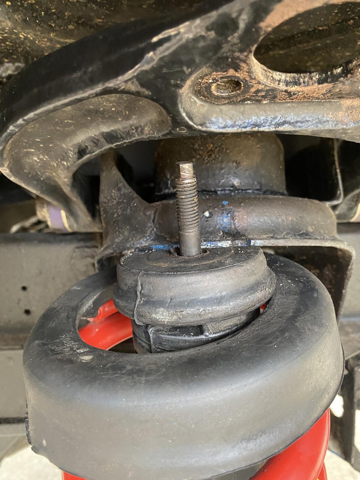

I put the whole thing together and slid it up into position. The shock is still loose in there at that point, so I was able to use the handle end of a rubber mallet to get between the coils and push/guide the shock shaft into the top hole. I did not compress the shock.
From there I pushed the lower shock mount onto the top hole of the control arm. With it wedged in place, I carefully jacked the control arm up (while NOT jacking the entire van) until the shaft was showing enough thread at the top to get the upper bushing and bolt on and tighten it.
I was very, VERY careful to make sure that the jack under the control arm was not ever supporting the weight of the van.
After that it was a lot of grunting, jacking, and a little bit of hammering to get the shock bottom down into the control arm and aligned, then I bolted it up.
