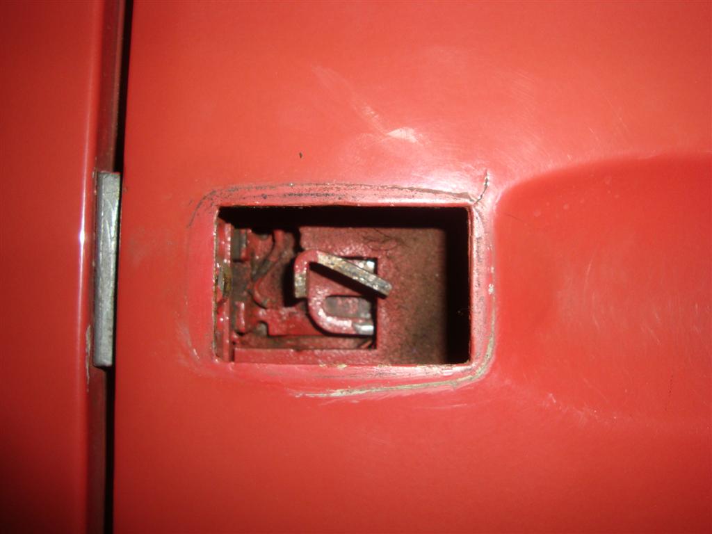

PostPosted: Mon Dec 13, 2021 5:56 pm    Post subject: Re: Front Door Install Help! Reply with quote
Alan Brase wrote:
It's been a while since I thought about this... but doesn't the lock act in kinda a funny way? Like when locked the handle still moves, but it just does not operate the release? The only splittie I have now is a December 1955 Wolfsburg so maybe that is different?
Yes, it's different than a later Bus.
On ice pick handles:
The driver's outside handle still pulls out when locked but it won't open the door.
The pin on the handle that connects things from the handle to the "finger" that pushes on the internal door mechanism is moved out of the way when locked so the "finger" is not moved on the handle
On the passenger side when the door is locked from the inside, the actual door mechanism moves out of the way of the handle so pulling on the handle would open the door except what gets pushed inside the door is moved out of the way
Passenger side:
Unlocked
Locked
It pushes on the piece in the center, you can see it moves down and out of the way when locked
