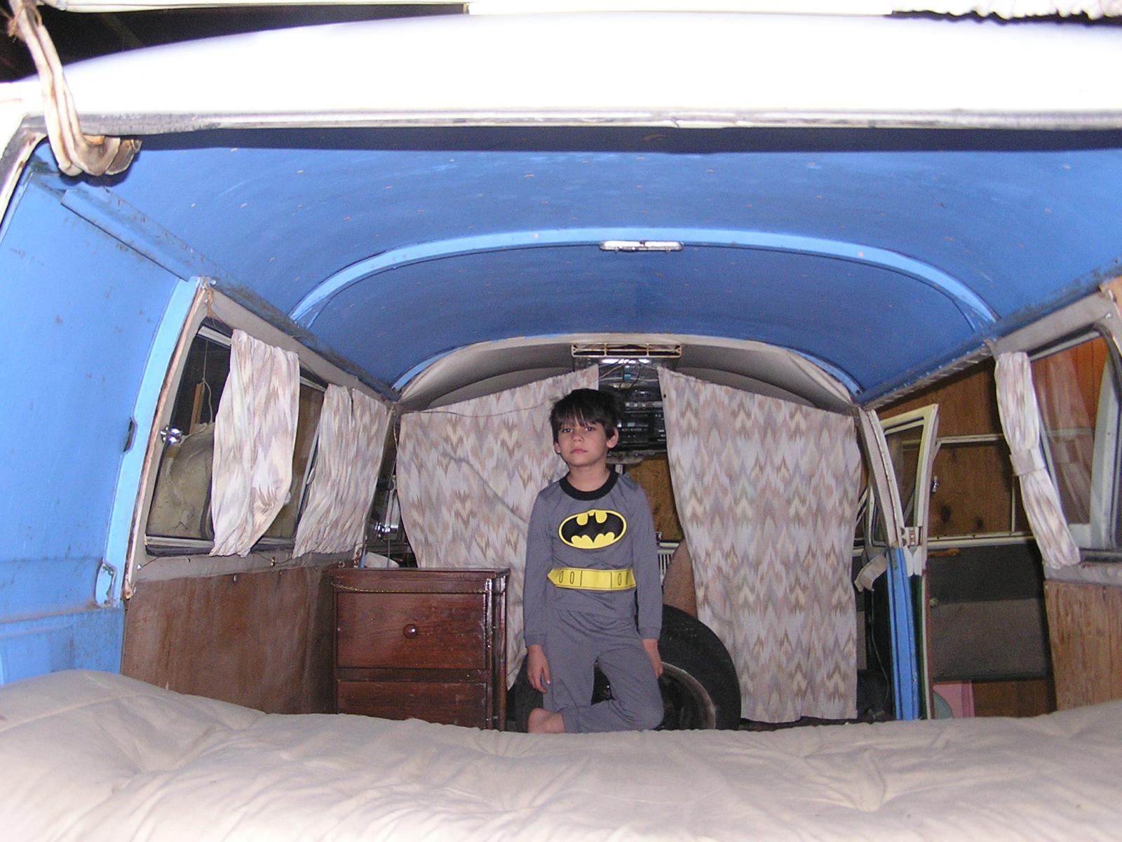

It might be hard to see, but there's actually an old double cassette boom box hanging from the fresh air vent that's wired up to a inverter under the dash.
The whole bus floor is covered in faux fur. It made for a great dog bed. The futon had legs that folded out. That hit the curb next trash day.
The night stand is still in my garage with it's original contents. extra spark plugs, oil, extra voltage regulator, etc.
The seats are buckets from an Chrysler I think and were bolted in with a few 2x4's. An old ammo can served as an armrest compartment.

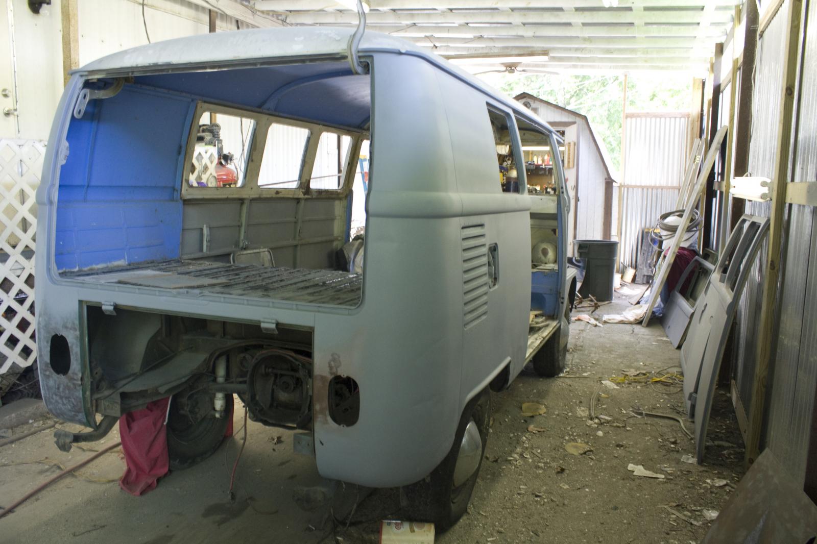

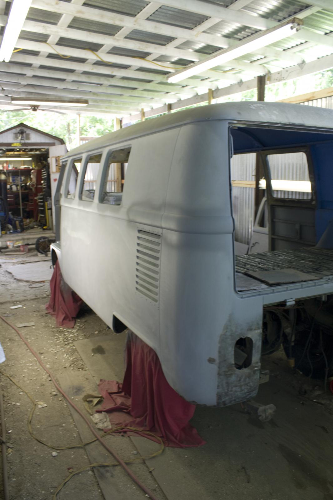

Fast forward about five years, I had gutted the wiring harness to convert it to a 12 volt, ordered some safari windows from Wolfgang International and a new 12 volt wiring harness from Jbugs. I also bought some front seats.
A good poker buddy of mine said he could do all the body work and paint so I towed off to his place - for another few years. Surprised
It sat at his house shop with him working on it when he could but he got too sick to work on it further. He did a great job and I'm forever grateful. With that though, it was time to tow it back to the garage.

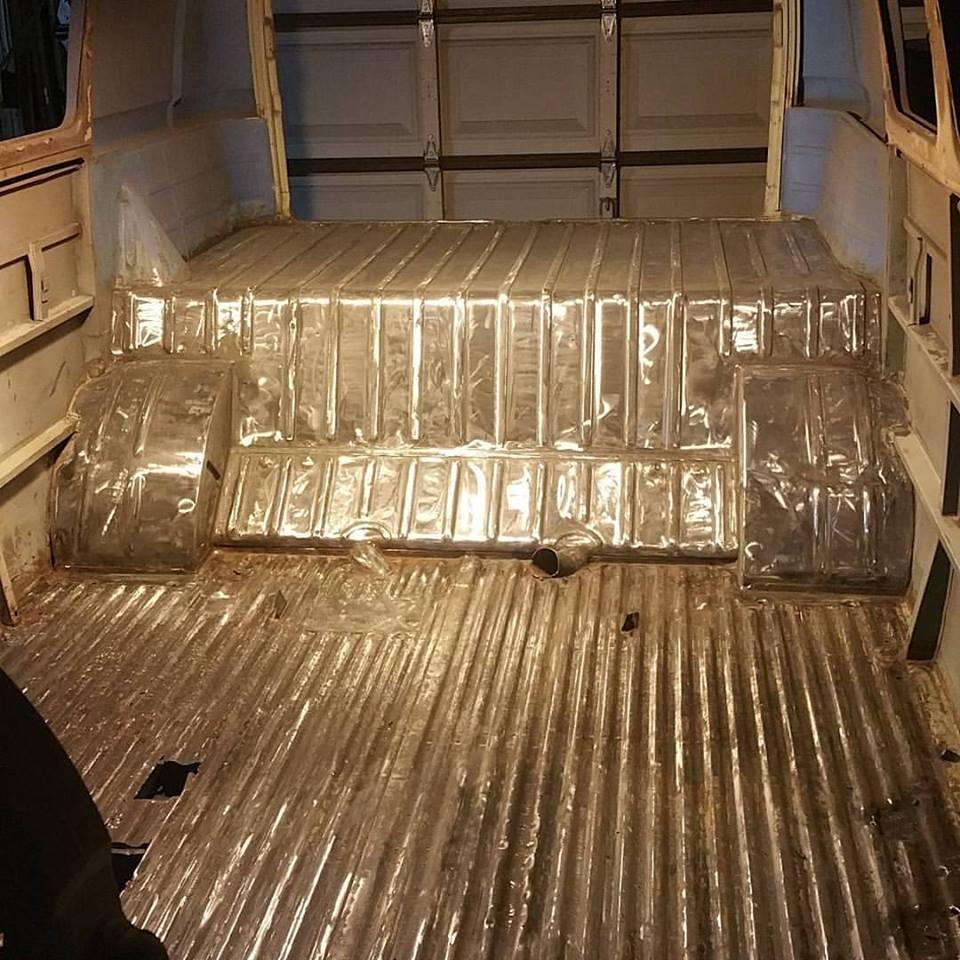

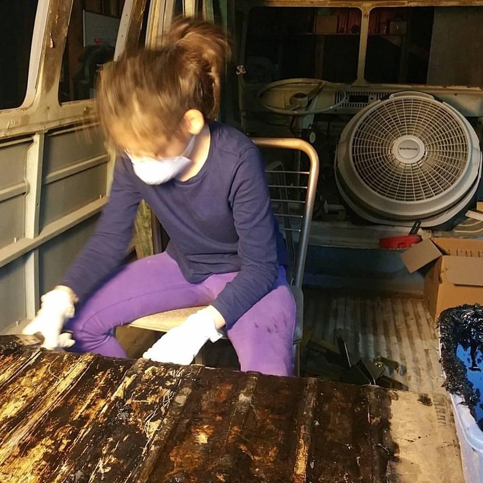

cleaned up all the tar boards out (It took weeks and even the kids got in on helping)
When I cleaned up the tar off the floor pans, I cut out the badly rusted spots as well.

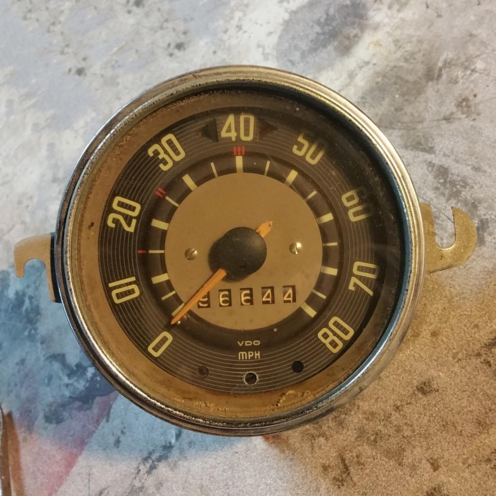

Speedometer rebuild (much easier than I thought it would be)

Batman is most certainly driving age now!! And yes, he's already asking if he'll be allowed to drive it. My only comeback, for the moment, is "you can't drive standard. It's not even standard for a standard..."

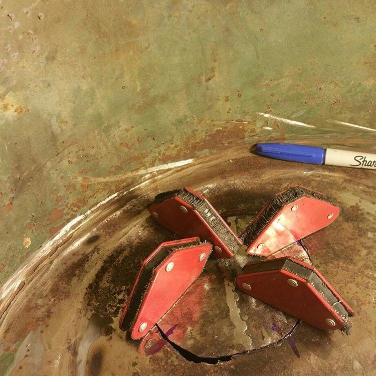

Today I worked on patching the left side of the engine compartment. The plan is to have my deep cycle battery here, once it's patched up.
I don't have any large pieces of scrap metal laying around, so I scavenged some smaller pieces and welded them together to make this patch. This is my first attempt at welding since hooking up C25 to my MIG 135 and using .023 (I was running .030 flux core before). I have to say, it makes a huge difference.
It's not a perfect fit, but I'm going to go with it. It's extremely hard for me to work in there. My angle grinder is awkward and my Dremel just doesn't have enough umph. Time for electric shears??

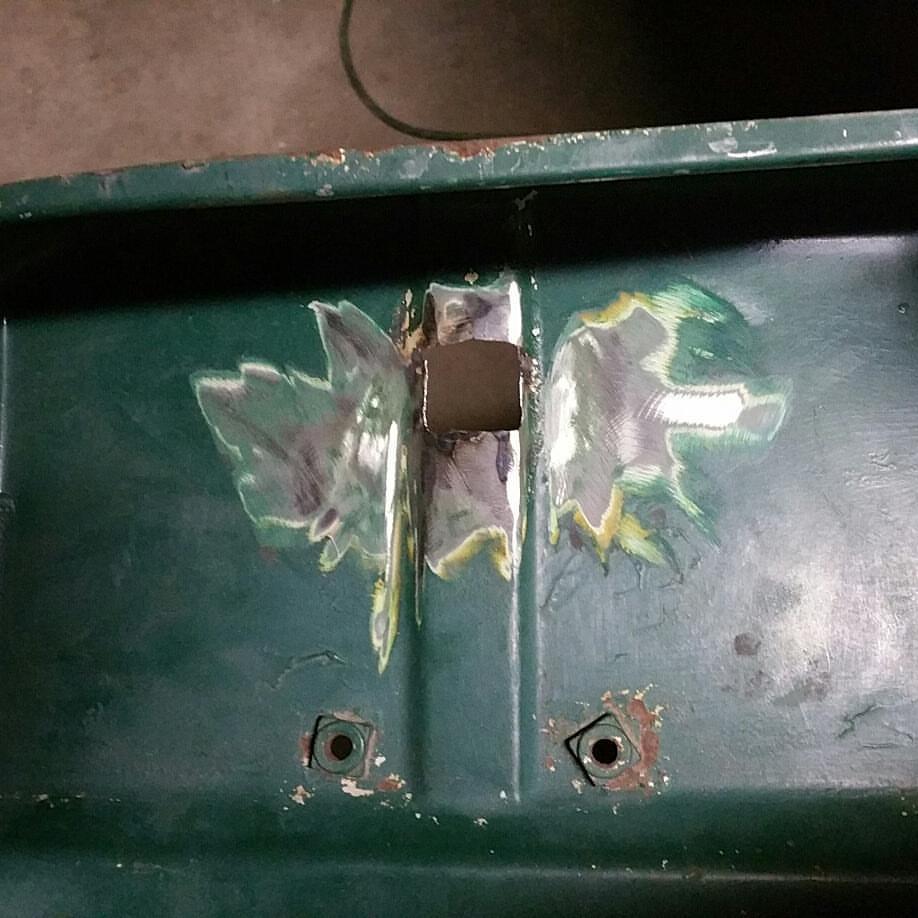

Last night's mission was to make a patch for the rust hole on the left side of my engine bay. When I bought the bus, the battery was actually there. The battery tray side had actually rusted away so badly that there was a sheet of plywood there haphazardly since even the lip of the rusted away tray was very unstable.
I don't have any decent-sized pieces of scrap metal around so I had to patch some pieces together to make a patch. I'm going to have to get some sheet metal very soon.
It's not perfect but I'm happy with it. There's some minor pitting, since I'm not very good at welding, but I figure some metal filler will fix that and prevent rust down the road?
The bottom reveals the true horror to my welding abilities. I'm going to grind that down some more, metal filler, then spray paint it with some Rust-Oleum.

If I found that repair on my bus I'd think the person knew what they were doing. Super hard area to work in even with the taillight removed.

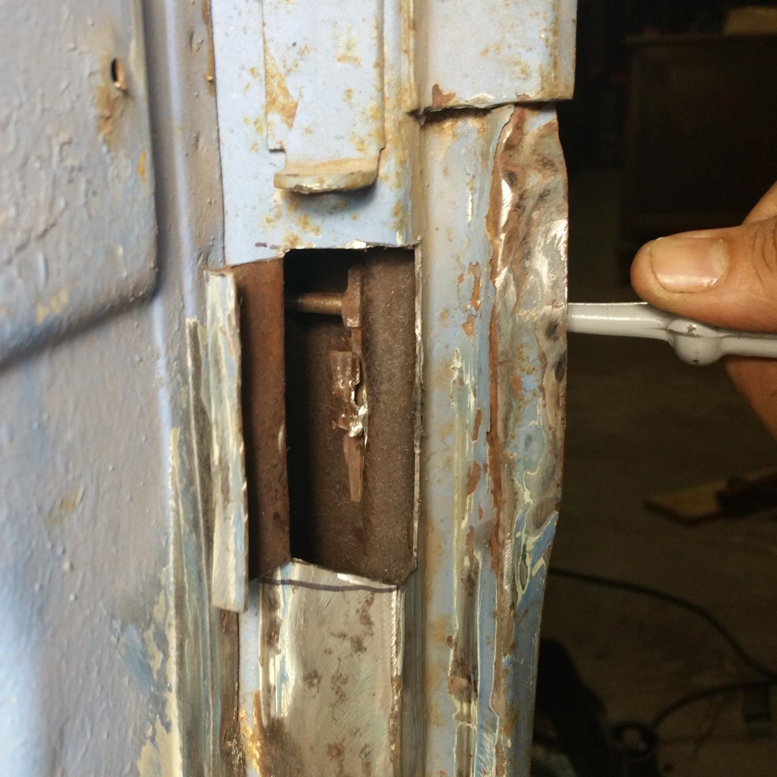

Today I tackled the other cargo door. I ran into a number of problems here. The first being that one of the little brackets inside the pillar had a broken bolt still inside (It's the bolt hole on the top). It looked like someone attempted to drill it out at one point and gave up.
I bought a set of screw extractors but had no luck. I decided to go in with my Dremel on the panel to access the bracket. Once I got the bracket out, I attempted to unscrew it from the back since there was quite a bit of bolt on the back end I could grip with a pair of locking pliers. No luck. I don't have a torch, so I took it to the kitchen and placed it on the stove to heat up, then cooled it in a bowl of water. I heated and quenched it three times before it finally started to move.

Stopped at my local welding supply store, Big Tex Welding Supplies, and got a refill for my tank. So today, it was back to work.
I decided to get a small win today and tackle something relatively easy. I cut out the rusted speedometer cable hole, patched in a new piece of metal, and drilled out a new hole. Afterward, I sanded it down and sprayed it with a fresh coat of spray paint. It's not the baby smooth finish I'd like but it'll do for now. I may sand down the rougher parts with some find grit paper and spray again down the road.
It's a small win toward the finish line, but I'll take it. Next on the list is cleaning and sealing the gas tank, then cleaning the engine bay for some fresh paint. Getting there slowly...

There was lots of welding, grinding, sanding, cleaning, and cursing, but it's finally done. I was able to kill the rust I could reach and get it all painted up. It's rattle can Rustoleum paint but it looks great.
Now to clean and reseal the fuel tank, then install it. I'm even thinking about one of those fancy Blazecut Fire Suppression systems.
I think I might be done for the day. It's raining and I got a slight headache. Tomorrow I start on the fuel tank...
