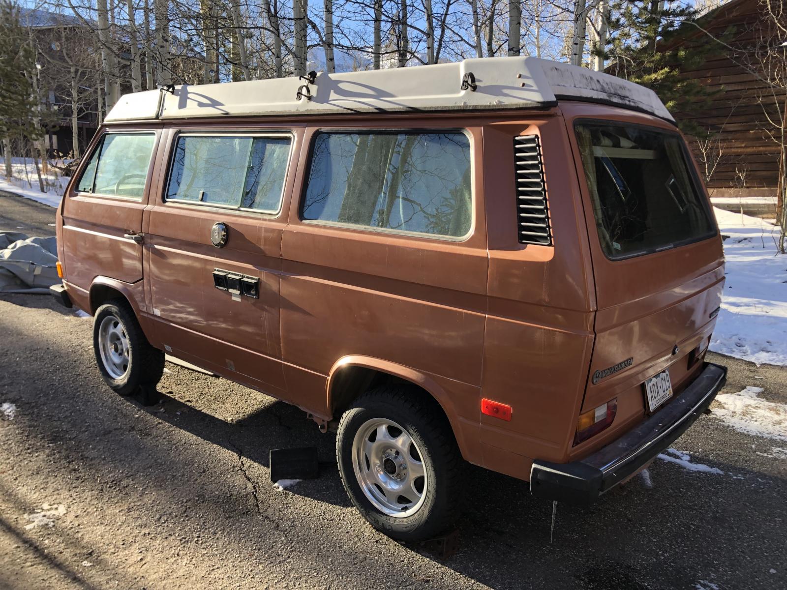

I've been on here for years, mostly as a lurker. I had my 1984 West parked for many years, always wanting to get it going but never making or finding the time and resources to get it done.... Lots of reasons/excuses but the time has come. Along the way, I've been inspired by reading the Samba and keeping my eyes out for parts to add to heap.
During an early burst of activity, I bought a 1993 Legacy with 163k that had been rear-ended for $300. Pulled the engine and harness and sold $500 in parts from it. I sold the running but overheating 1.9. Then life happened and it had to go back into storage.
Through all of this I would read the Samba, peruse Craigslist, watch the Pick n Pull's and continued to accumulate parts.
Here's the project as it sits now.

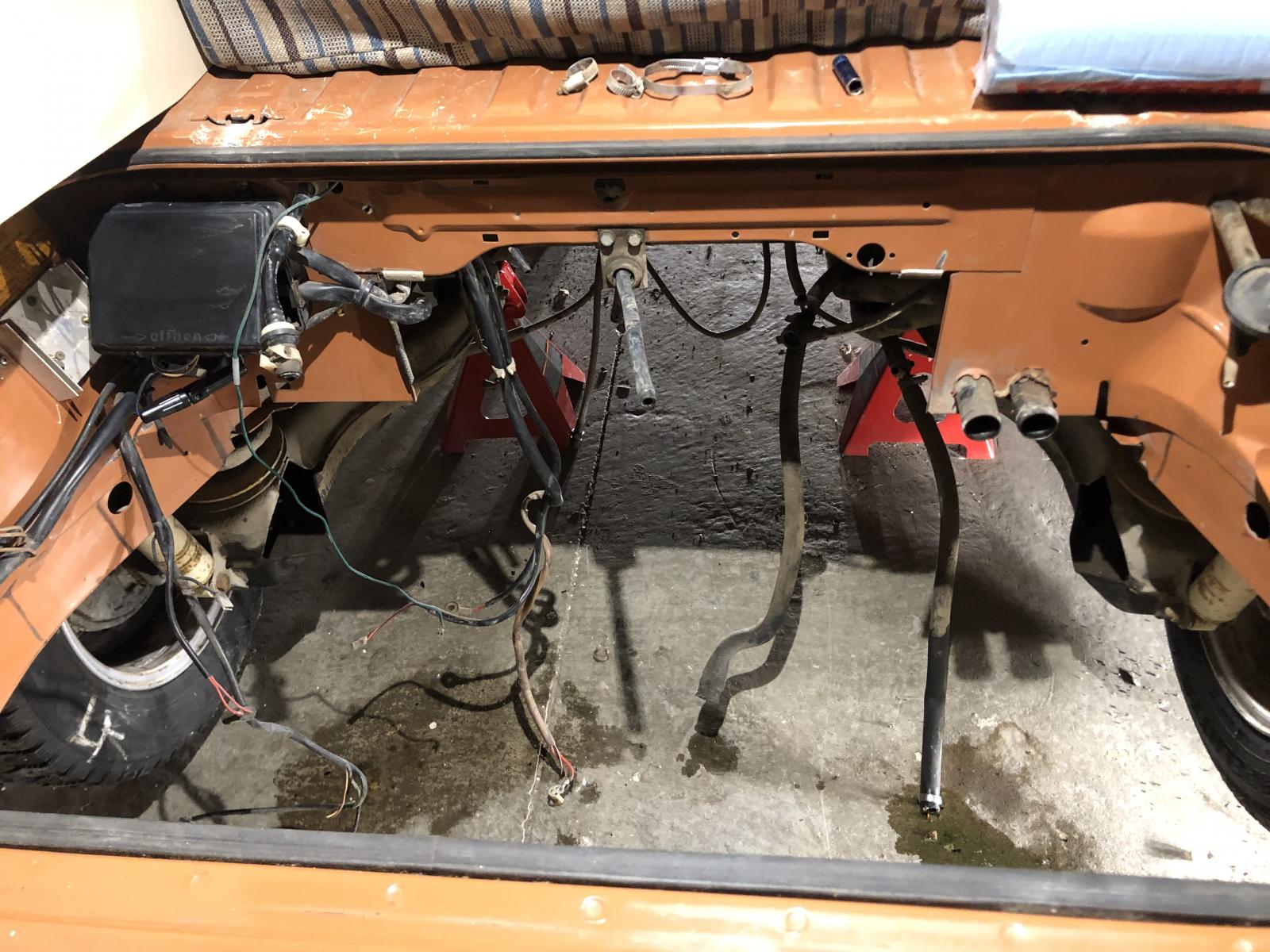

I recently pulled the radiator, gas tank shift rods, etc in anticipation of moving it into an indoor space I hope to have available for a couple of weeks.
Stage one goals are to get the ej22 I rebuilt with new rings, headgaskets, water pump etc installed along with a Subarugears trans.

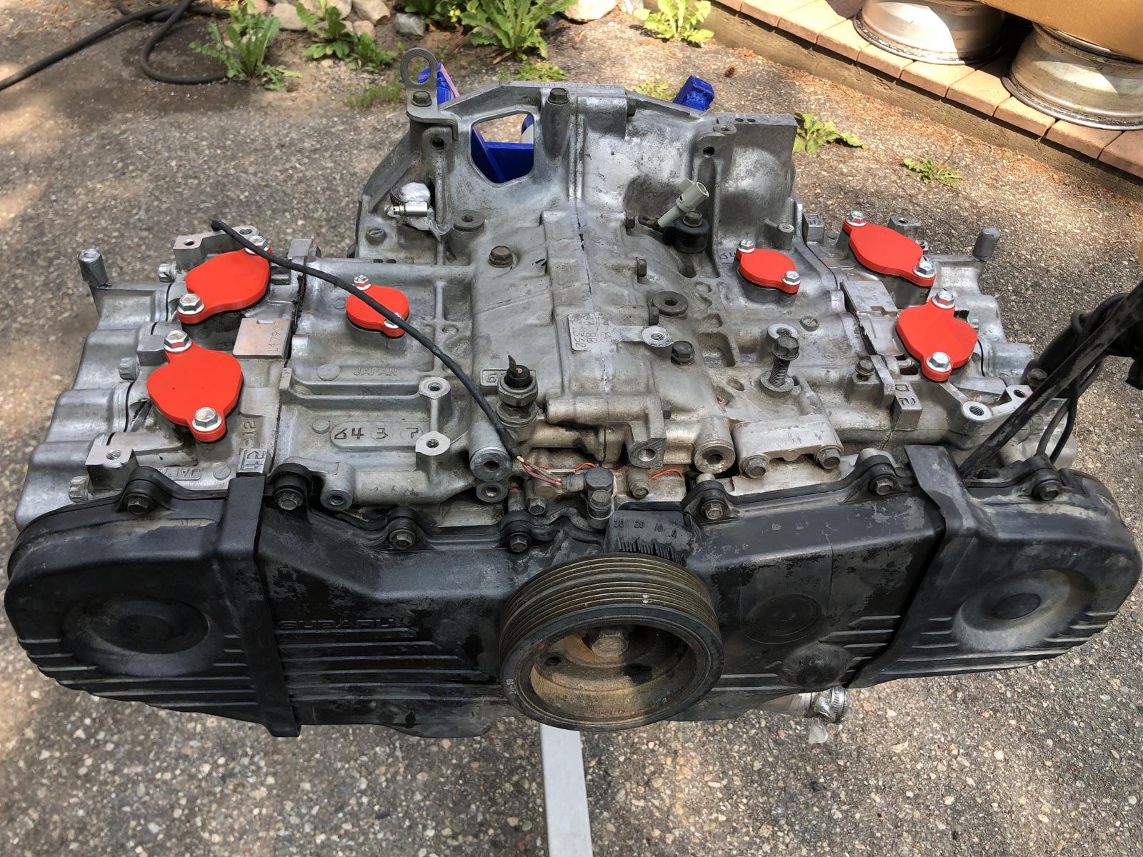

The engine sat for a long time in storage. Along the way, I bought a second engine off Craigslist "just in case" for parts. It was only $100.
I started in on it this summer. Pulled it out of storage and into the driveway for cleaning and teardown.
I wish I had taken more picture but once I get going on something, I'm not good at stopping to take pictures.
Dirty engine:
Cleaner engine:

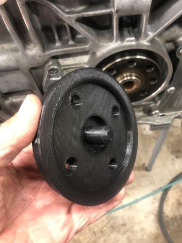

I do a lot of 3d printing so I made up some covers to help keep water out when pressure washing the engine. The printed TPU gaskets didn't work that great, I'd probably just cut some out of epdm if I were to do it again. Happy to share the files with anyone.

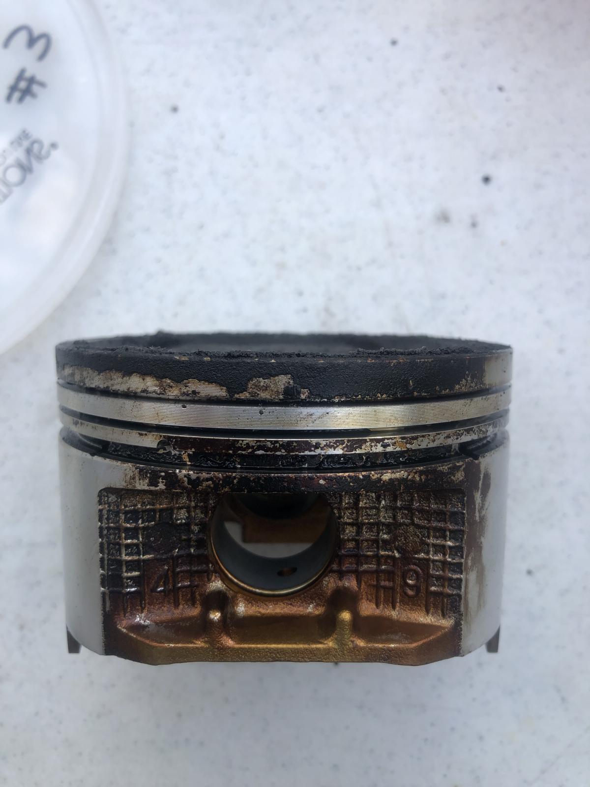

In the meantime, I pulled the heads off the spare engine, which turned out to be a 1995 and took them to a machine shop to get rebuilt.
Pulled the heads and made a slide hammer to pull the pistons Discovered this was a really good thing to do. Pistons mostly looked like this:
Rings were pretty locked up. I used Berrymann's parts cleaner to do much of the cleaning. I set up four small paint containers and put enough into each one to soak the top of the piston. A parts brush removed the easy stuff and I used a few sizes of zip ties cut at an angle to scrape out the ring grooves. I would let them soak and rotate through them, cleaning one, putting it back and on to the next.
I finally got them this clean.
I then masked them off and used the bead blaster at fairly low pressure to clean the tops of the pistons After blasting, I washed them in hot water and soap to get them totally clean of media.

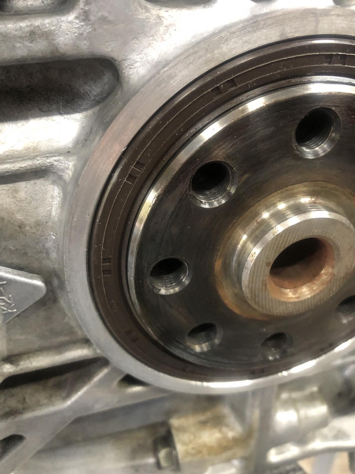

Rear main:

This is a great piston ring tool!

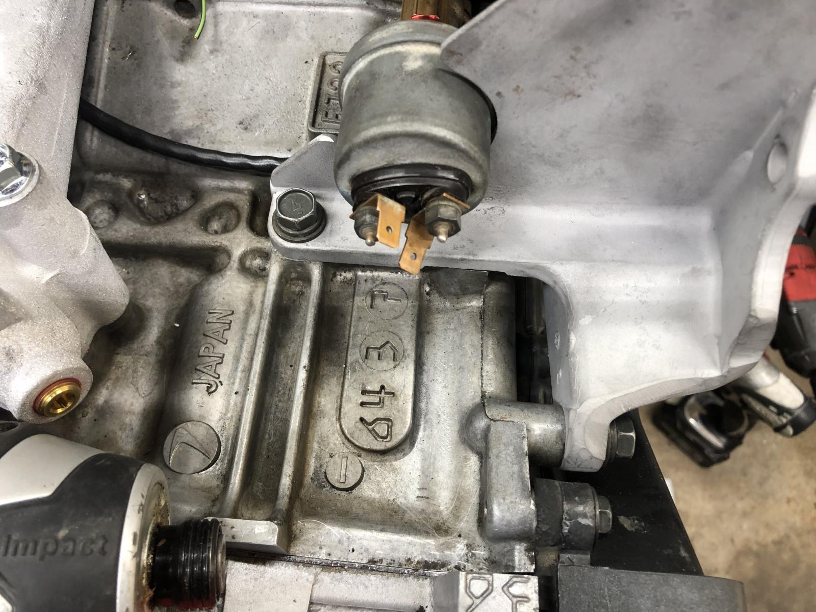

Since I want to use the oil temp gauge, I picked up an adapter for the center oil galley plug on top of the engine, under the manifold. Here you can see where it sits. I thought this would be a good place to check oil temps and not too hard to access. The RMW manifold has a nub right over this. I wanted to be able to remove the sender if necessary, without pulling everything, so I cut it off and tapped and plugged the hole. Warranty successfully voided...
On the other side, as I was putting stuff back, I saw that the heater coolant outlest was a bit close to the crankcase breather,
I asked RMW about this and they said they had not had any negative feedback but I just didn't like things this tight together, so...

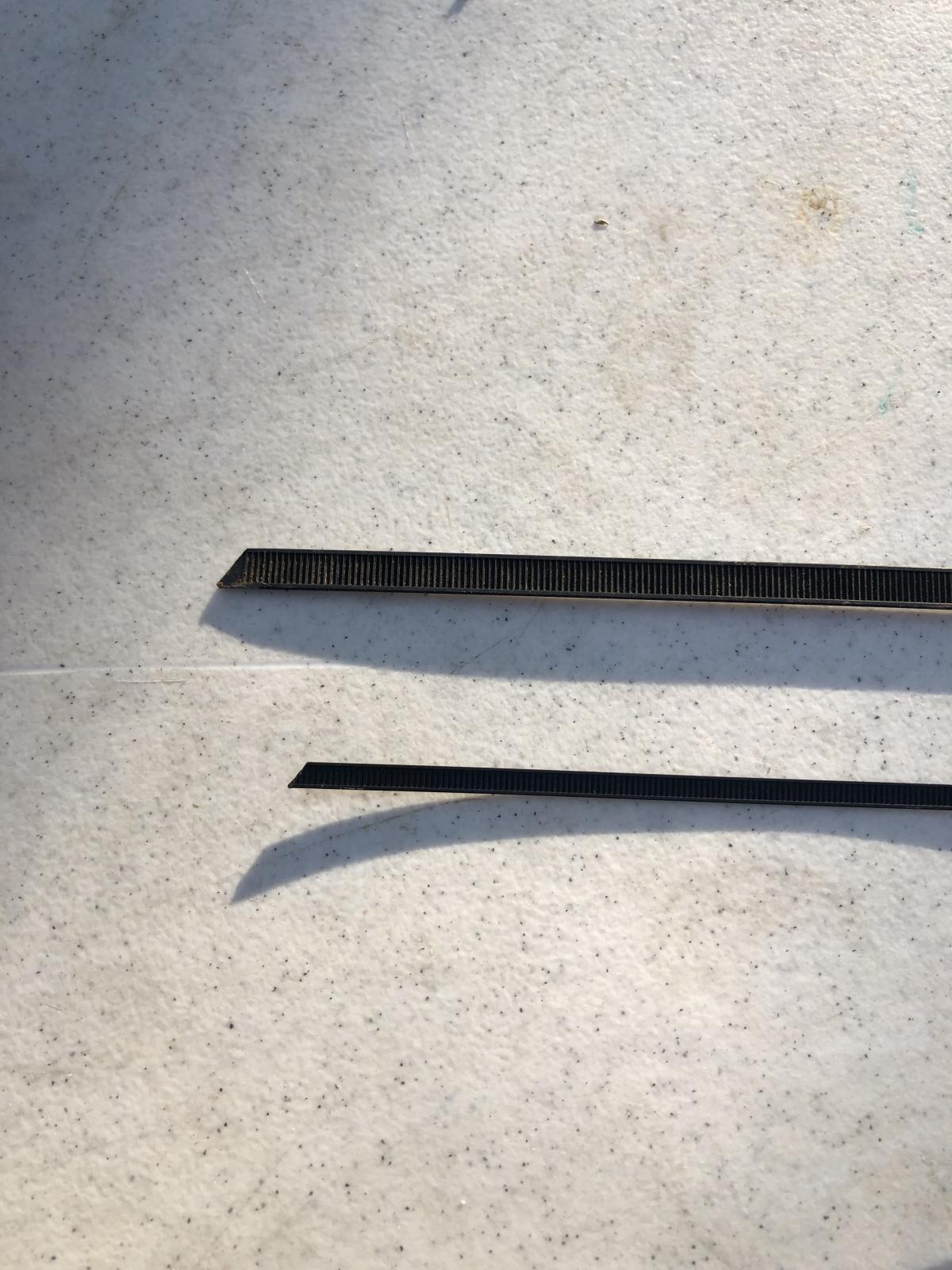

Since my Westy has manual steering, I only needed the belt tensioning parts from the PS mount. I cut it down and modded it to use the Bosch dual sender I scored with the VDO gauges. This sender has both the low pressure switch and oil pressure sender. I mounted it like this.
For the longest time, I was determined to do the wiring harness myself. I did modify the manifold harness to put the plugs at the driver's side of the engine, but sort of stalled on the main harness. A few weeks ago I decided to just send it off to Jeff at AutoVentures. I wanted to get the engine in while I might have time to use some indoor space over Christmas and New Years. I did not want to work my butt off to get the engine and trans in and then have a no start and have to wonder if I had messed something up on the harness. It was such a relief to box it up and send it out. Jeff is another one of our stellar vendors and just let me know yesterday I can expect the harness next week. Knowing that this will be guaranteed GTG will be great!

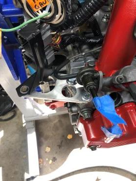

I did make a bracket to use the original mount for the engine plugs. I didn't want the plugs just hanging off the engine.
You can also see I flipped the fuel pressure regulator. I have also cleaned up the metal fuel lines on the intake manifold as in ChesterKV's thread. I kept the small metal line and did a little cutting and bending to reuse it to connect to the vacuum port.

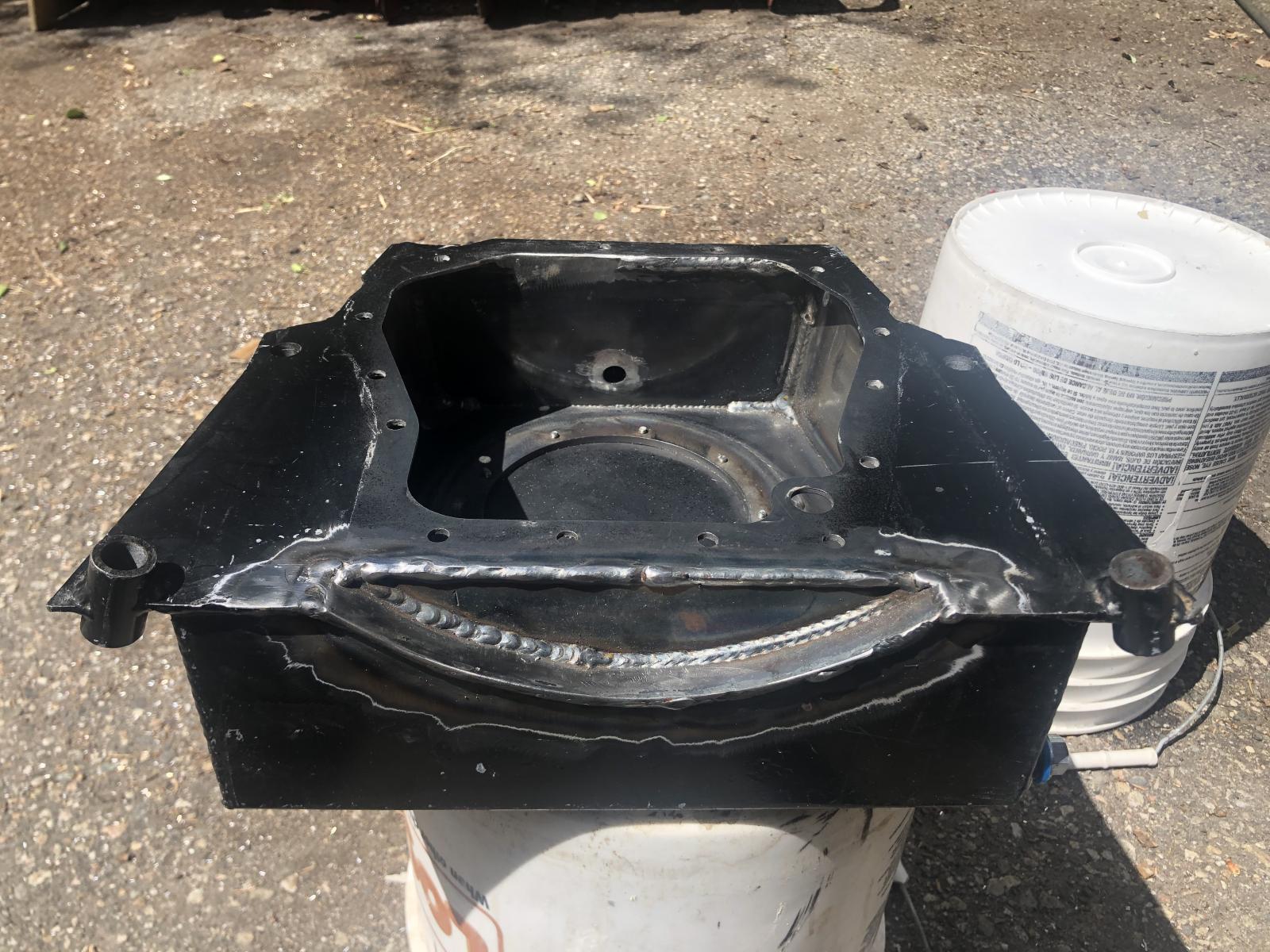

Hi Vanis, I love acquiring and making tools and jigs. Having the 3d printers for prototyping has been a game changer for my work. It's fun being able to draw something up and have it the next day!
A few years ago I picked up a Burley Modular oil pan/engine mount from Joel Lane. It seems to be a pretty stout way to increase oil capacity and mount the engine. I've been back and forth with Burley with questions, especially after I pulled the trigger on one of SubaruGears Black Friday sales. This was designed for use with the VW trans and had to be modified for use with the Subaru trans. Because an adapter plate isn't being used, the pan needs to be recessed to allow for stock flywheel clearance. 1st pic I took from Joel's review.
This will use the stock moustache bar and engine mounts.
Since this is very similar to the Smallcar mount system, I'm not 100% sure about the heat shield yet. Thinking of following SC and modifying the stock heatshield and adding as needed. I'm also looking at coming up with something to mount on the Burley pan/mount.
I'm lucky that one of my suppliers has a powder coating facility and I occasionally take advantage of slipping some of my stuff in to get coated. This time they asked if red was ok and I agreed as it should add at least .025hp. Hope it doesn't look too much like the backside of a baboon....

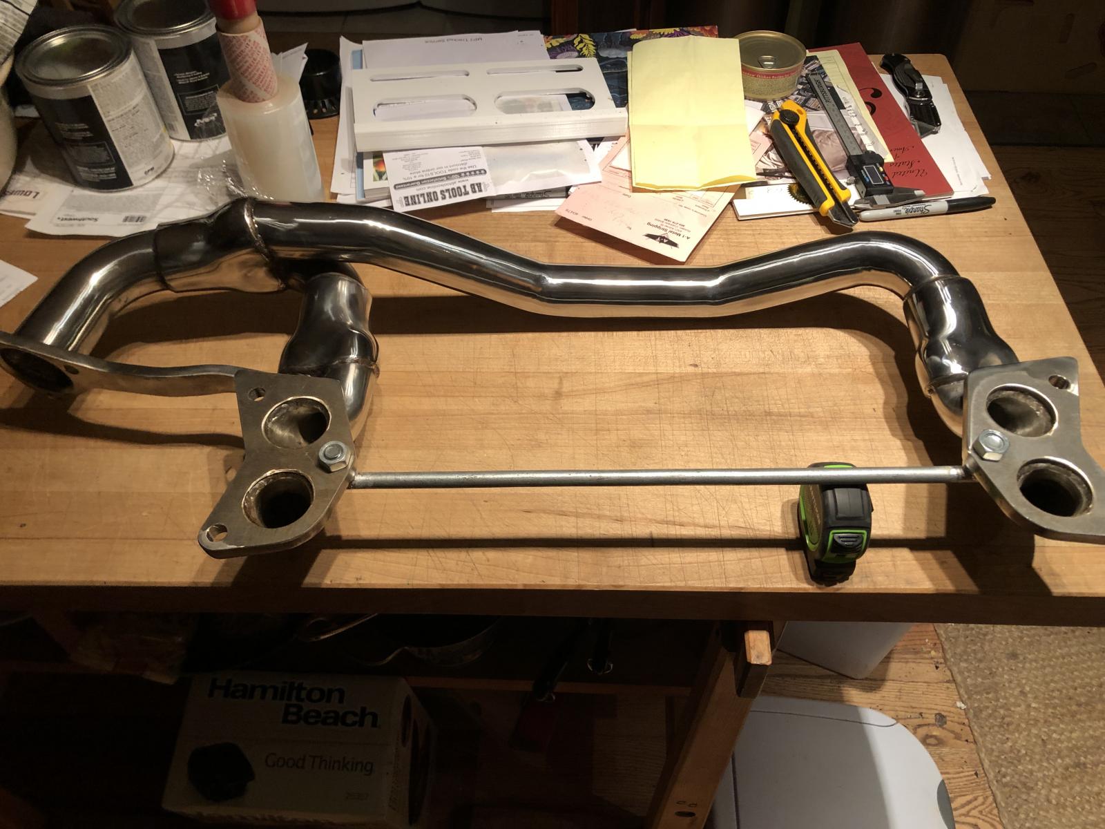

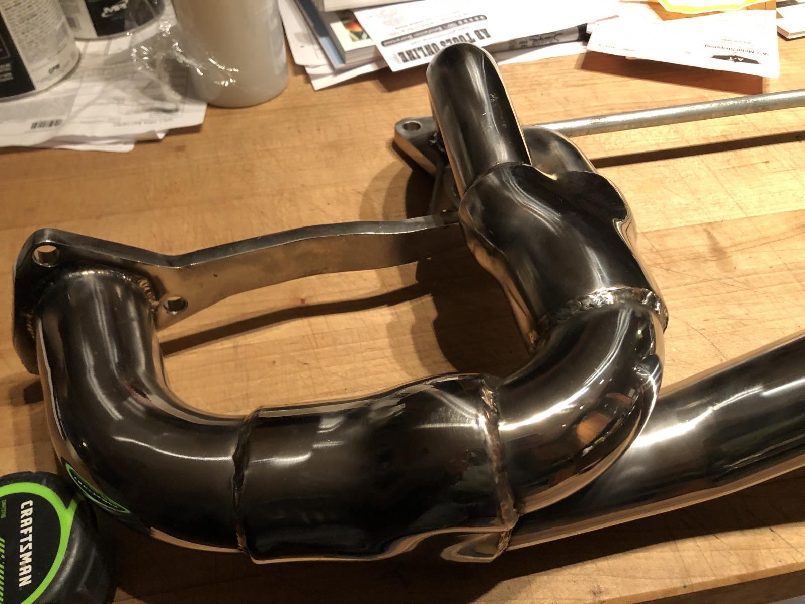

I haven't decided if I should mount the exhaust header now or after getting this into the van.
I decided to go with the SC stainless header as that is what Burley suggested and there don't seem to be the issues with it since the current version came out. It seems to be pretty stout and well built. I'll be running a Magnaflow cat and muffler since I picked those up off the Classifieds as well. I would have used the RMW header if it would have worked with the Burley pan and stock mounting bar.

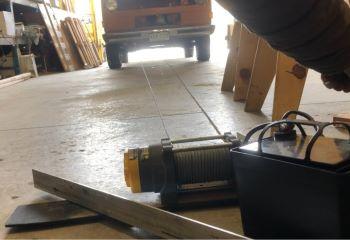

Since it was snowing the last couple of days, and I don't have access to the indoor space til tomorrow, I thought I would do something easy.

PostPosted: Sat Dec 25, 2021 7:05 pm    Post subject: Re: Just another '84 Westy Build Reply with quote
mtnhome wrote:
that seal is backwards. it gets installed groove out, like so:

skills@eurocarsplus wrote:
Damn! Appreciate the sharp eyes Skills.Thanks for taking the time to comment, I always like feedback from the pros, especially when I screw up!
I guess I'll pull the timing belt and oil pump while it's on the stand. I used the original oil pump that does not have the threaded bossed for the timing belt guard. Worth replacing? Any reason not to reuse that seal?
you have the older 2.2 tensioner setup and i don't think belt slip was as much of an issue on those until they went into the "all in one" tensioner/idler design.
that said, i think the pulley on your style won't allow for the hoop but it may be worth researching. not too many of that vintage subaru rolls in here so i'm not as well versed on the smaller details of the 2.2 as i am on the 2.5
what i can tell you is the late 2.2's with the shared 2.5 tensioner assy for sure did have that hoop on M/T cars
personally, i'd replace the seal. they are stupid money from subaru, like 12 bux or some such thing but seeing it's on the outlet to the pump and feeds the engine i'd be pretty pissed if something went wrong
gprudenciop wrote:
[email protected] wrote:
Jake Raby wrote:
Brian wrote:

It's been snowing almost nonstop for 4 days. I had to wait a day to get a flatbed tow truck since they were all busy pulling people off I70 and out of ditches.
Used a small winch to pull it into the space I have for a couple of weeks.
Got it up on jackstands and spent a bunch of time crawling around underneath with a shop vac trying to get as much dirt and cobwebs cleaned off from underneath. Amazing how much dirt builds up on every surface.
Also did a clean of the engine bay and started pulling the heater hoses, coolant pipes and some leftover engine bay wiring.
All the cruddy looking stuff is original undercoating which is all over many fasteners and the suspension parts. It's starting to flake off and all the metal is spotless. This is a very rust free van. It was purchased new in the PNW and then spent a few years in MT and then WY. Don't think it was driven much in the winter even though it has some funky ski holders mounted on the sides of the pop top.
Also, the coolant pipes have been open to the air for years and still dumped this out when I rotated them to pull out the back.
The pipes are in great shape but I had already bought SS pipes.
I also pulled the rear heater as I'm going to delete it. No kids and I'm planning a Propex or CDH for camping.
It didn't look like the rear heater had leaked(yet). I have been pleasantly surprised that I have not found any evidence yet of mice, no droppings anywhere. there was some bedding stored in the cabinets and I was cautious pulling it out expecting to find a nest.
Found this under the rear heater cover so it appears this van has been to Alaska.
Ready to actually start installing parts rather than pulling things out!
I have the gas tank and cooling system out and the only place that might have any fluid in it is the front heater core, so no more spills or leaks.
Things I am planning to get started on:
Install Intrepid Overland(10c) heater valve
Install RMW SS coolant pipes
New heater hoses
Replace/upgrade battery cable to starter
New wiring to fuel pump(possibly replace fuel pump with Jaguar pump)
Run larger cable from starter battery to aux battery space under driver's seat for Lifepo4.
Run RJES throttle cable
New steering couplers
Install ej22 with SubaruGears trans with 5SpeedBus shift kit.
Install AutoVentures harness
New gas tank
New radiator
I was prepared to replace brake lines but they are in perfect shape but I do need to flush/replace brake fluid.
And, and, and....
Immediate goal is to get this running so I can at least drive it to someplace to continue working on it as I have time/space.

PostPosted: Thu Dec 30, 2021 7:19 am    Post subject: Re: Just another '84 Westy Build Reply with quote
I always enjoy the point where the parts stop coming off and the parts start going on. It's like cresting a wave.
See if you can lube the cable sleeve for the 10c heater valve mod. It's a big valve to push and I bent the cable and now it constantly rebends and/or doesn't slide into the sleeve very nicely.
