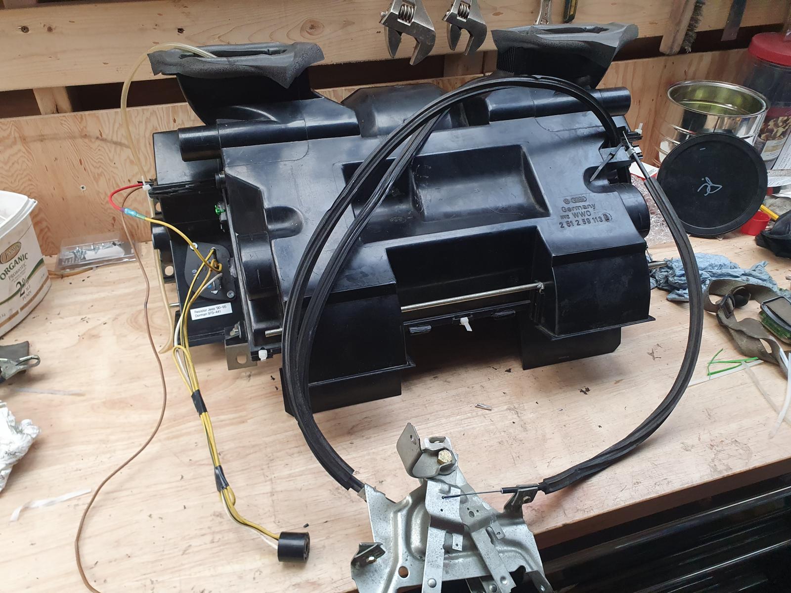

I've had all sorts of heater problems since I purchased my van, so it looks like my next project will be to tackle the heater core/blower/fan resistor. It appears that the clips to reseal the box are sold out everywhere other than Vanagain, and I'm looking at $80 just for these clips! Has anyone had any success resealing their box with other methods?

Some folk glue it back together.
They originally were sealed shut by heating molded on tabs until they melted together.
I stepped up and spent the coin fir the clips from VanCafe very recently.
The first time I needed them I got them from a VW dealer.
If I didn’t have clips I would drill holes at each clip location and use small zip ties.
I would NOT GLUE!!!! Ever Ever Never.
You aren’t seeking 100% air tight.
You just want to keep both halves firmly together.

Thanks Dave. Work has been slow this season so I am on somewhat of a budget and I think I might try the zip tie route. Would that combined with some RTV be sufficient?

No RTV!
No need field any glue or sealant

or you can pre-drill holes and put in tiny screws. i wouldn't RTV it, you'll be back into it sooner or later. it was 3 years for me!

its the same clip up to the new beetle and beyond
321819059
any dealer should be able to get them. you need 10 according to ETKA

I just got done rebuilding my third T3 heater box, and the first box that didn't have clips from the factory. The first box I did was on an '86 Syncro, and the second on an '84 ASI. This third one was on another '86 Syncro, so there doesn't seem to be any coherent guidelines as to which boxes are clipped and which aren't. I just so happened to have had enough clips in my stash, though I haven't a clue where I harvested them. I seem to recall that Mk1 Rabbits used those clips.
SCREWS!
What a fantastic idea!
Stainless sheet metal pan heads would work marvelously for a mere fraction of the clip cost!
NOW you tell me......... Rolling Eyes
BTW .... I was back into mine after less than a week..... NO GLUE OR RTV!!!!!
Dave

Small holes, and zipties.
Don't spend $80 on clips you don't need!

Thanks for the advice everyone! I think I’m gonna go the screw route. Any advice so I don’t have to go back in the next week? Hoping I don’t have to do this again for a very long time…
Do NOT USE AN AFTERMARKET HEATER CORE!
Pressure test and repair the original.
Do not use rubber for flap seals. Closed shell foam (camper shell foam) or Felt weather stripping,
Do the Jeep resistor mod.
Carefully free up all of your cables so they move like lubricated silk.
Clean your ground trees while the dash is off
Lube your wiper linkage while the dash is off
Renew your washer nozzles and hoses while the dash is off
Replace your crappy plastic Ram Air intake screen with an expanded wire gutter guard to keep the mice out.

Screws work, FTW!
FWIW: I may have a bag of clips I once got in a karma deal; if you (or anyone else)
really want, I'll spend some time looking through the parts department tomorrow...

i just got back from an 8 mile vanagon jaunt for the sole reason to drive with heat from my refurbed OE heater core that heats so darn well! i was grinnin' and putting my hand over the heat vents the whole time. anyway.
i'll add that when the heater box is out, jam stainless steel or copper pan scrubbies into the inside recesses of the air scoop to keep mice out. they pack in nicely and mine haven't moved/unravelled since i put them in 3 year ago. there's some open corners that aren't covered when screening the front intake. my heater box had ZERO debris from mice, leaves, etc. with the intake screened off.
you may want to consider leaving the baffle plate out. for those of us in cold climates, removing it slows air flow for a given volume thru the heater core by exposing more of the core to the air flow. but understand that in removing the baffle, ram air can push a HUGE quantity of air thru the core and result in tepid air. so partially block off the ram intake to reduce the quantity of air when max heat is needed. in the summer, open the ram back up for fresh air flow. the combo of baffle removed and blocking some ram air makes for terrific heat.

A previous owner glued the heater box shut on my 83 1/2 using plastic cement all the way around. It probably took me 2-3 hours to get it open by carefully tapping an Exacto knife along the seam and I still did some damage in places. RTV doesn't have much structural strength so in combination with screws or clips would help to seal the box, I wouldn't hesitate to use it here.
I removed the baffle plate on one of my Vanagons and drilled extra holes in the plate in another, both ideas got more heat into the cab. Somewhere I posted about doing this. There is a thread from a dozen'ish years ago, where I talk about this.
Sad that VW didn't supply every Vanagon with a small bag of clips, it would have cost them about 50 cents per vehicle and saved a whole lot of aggravation.

As for the clip issue. My 81 has clips, my 82 diesel had clips, my 87 was cemented/no clips.

PostPosted: Sun Jan 16, 2022 1:31 am    Post subject: Re: Question about heater box clips Reply with quote
There is zero reason to seal the box seam.
VW sure didn't, why do you feel the need to do so?
Just hold the two halves together with something. Why ruin the next guys day fighting sealer?!?
Dave

PostPosted: Sun Jan 16, 2022 7:38 am    Post subject: Re: Question about heater box clips Reply with quote
Self tapping screws.
