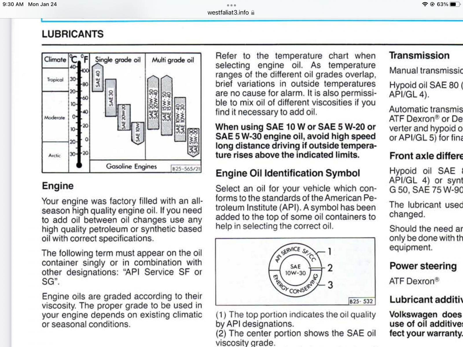

Multi-weight oils.......
If you look in the owners manual it lists both single weight and multi-weight options.
But on the multi-weights, the upper weight safe usage limit stops short of the comparable single weight safe use limit.
In particular look at the 30 weights.
