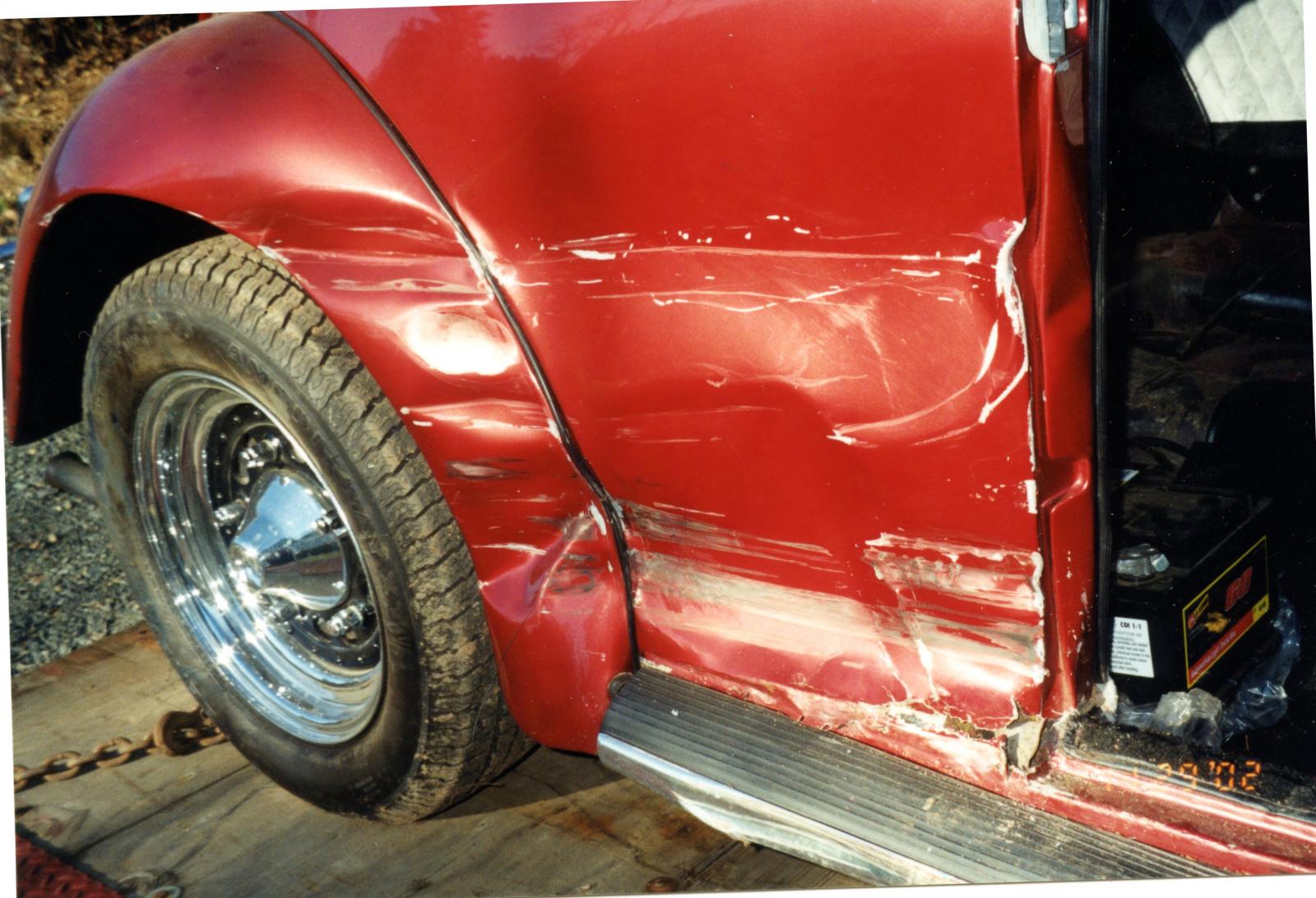

A sad chapter happened in 2002 when out on a short joy ride. Coming back from my dad’s place, a drugged out meth head sleaze decided she did not need to stop at a stop sign. T-boned the passenger side, and slammed the driver’s side rear into some heavy duty mail boxes. Both sides of the car were heavily damaged. I was actually thrown out of the car but was fine except for a few scratches. In a big way the car protected me because the driver’s door became an outrigger and stopped it from rolling over on me. A higher power of some sort or at least great luck seemed to be in play. The car landed back on its wheels, and amazingly it was still drivable but barely. I discovered I broke the master cylinder push rod when slamming the brakes so hard, but I was able to get it home using the e-brake. There was only about 750 miles on the car since the life in red paint. Moral of this chapter: Put in seat belts with shoulder straps, and drive like you are on a motorcycle where no one sees you and everyone is out to kill you. It could have been much worse. The b^##$^ was caught and arrested and later found guilty.

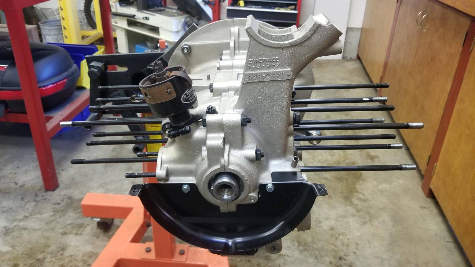

I started with the engine restore and currently have the engine 99% complete for a June 1955 born date. It is not the original block but I do know the original case # (original paperwork!). Some parts are original to the car on my engine as they were transferred through the cycle of engines it had. I put a short video on YouTube of its first start. Mr. Okrasa helped with the case machine work, if you recognize the magnesium coating color. I did all the mechanical assembly.

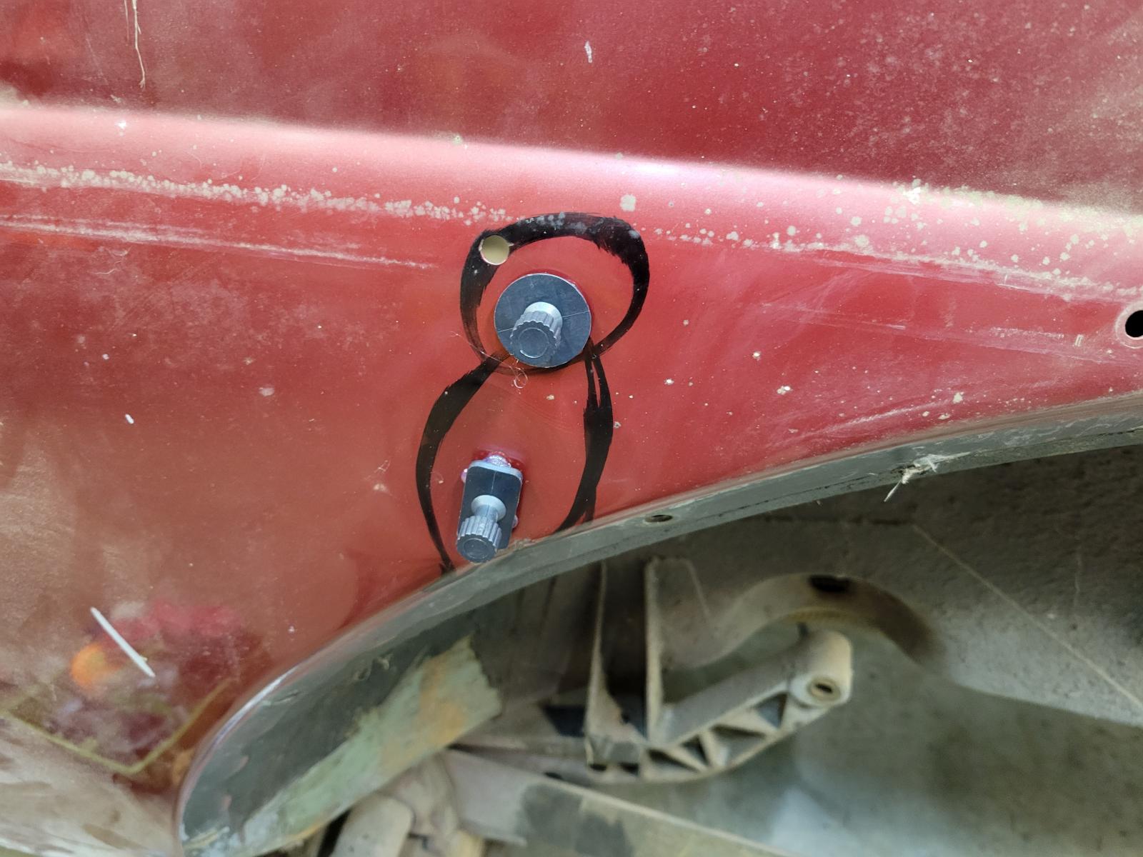

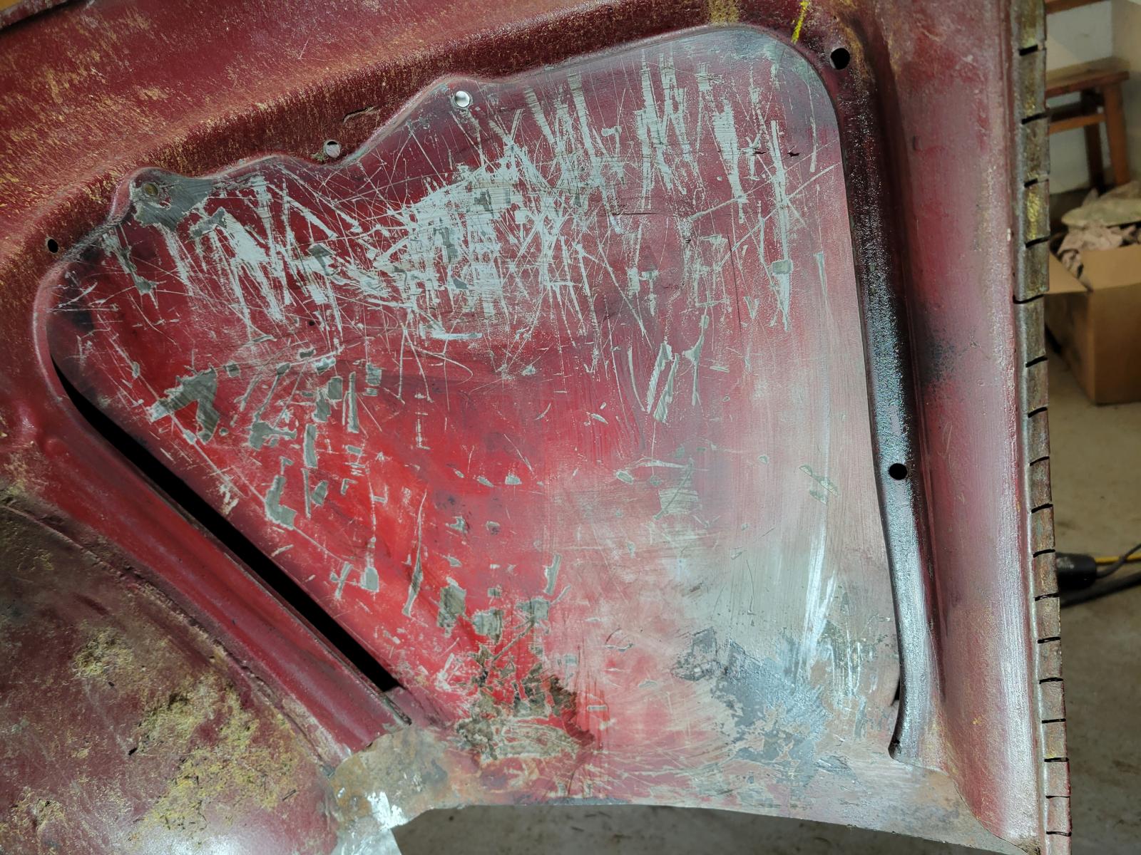

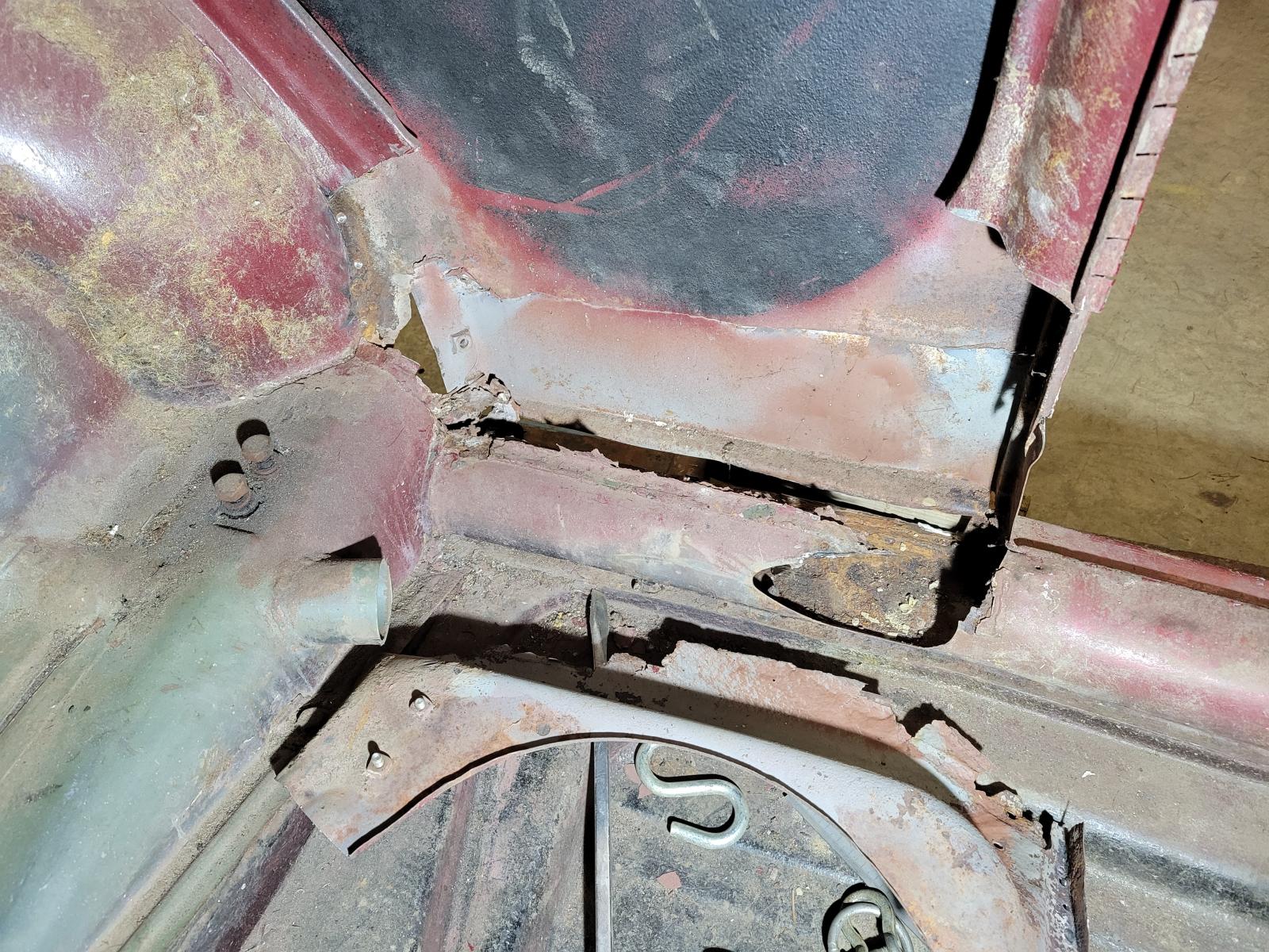

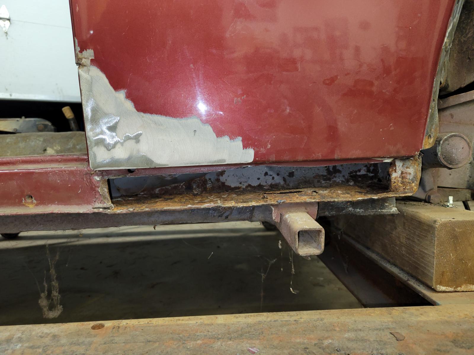

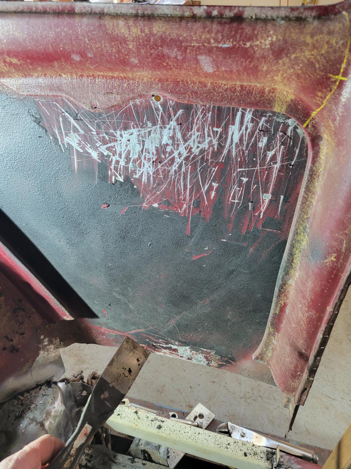

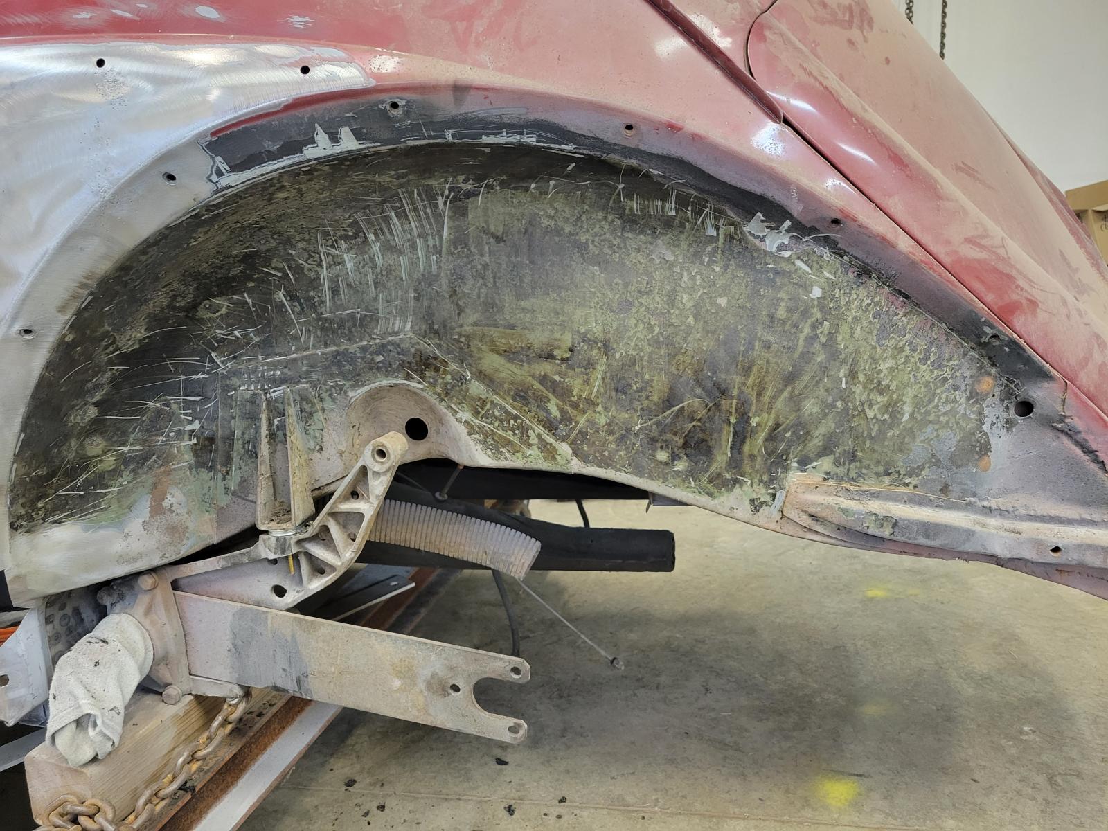

Some painful images here to show. My poor car took such an undeserved beating. Believe it or not, the passenger door still opened and closed after this. I had to cut the drivers door off at one of the hinges.
It is important to me though to share these so I can tell the full story. One A-pillar and one B-pillar are heavily damaged. All four quarters and the doors need serious help. The back seat pushed out the drivers side rear quarter. (It was weak with a rusted heater channel.)
Believe it or not, I recently removed the fenders, and straightened them out with an air hammer and manual hammer/dollies, and promptly sold them on Craigslist. Main task for me was just to see how well I could get the back to a reasonable shape, ready for filler. I removed my bullet turn signal bases and patched in the hole too before selling. Razz
She will drive again someday!

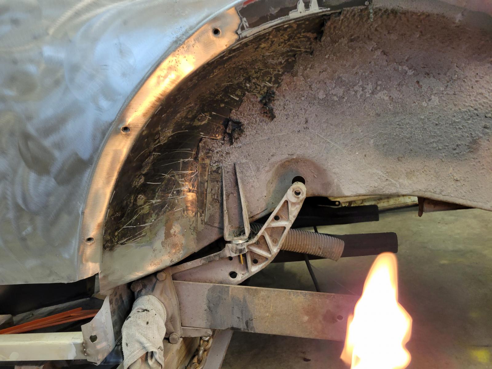

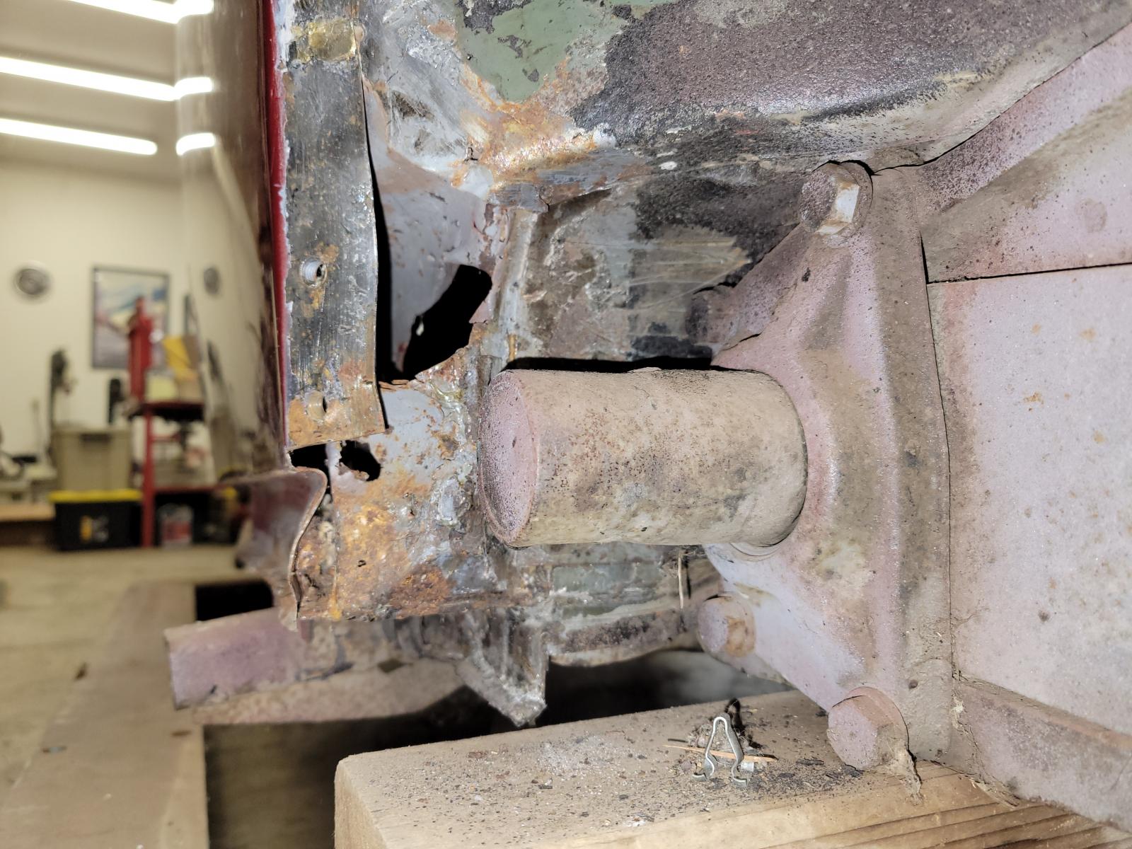

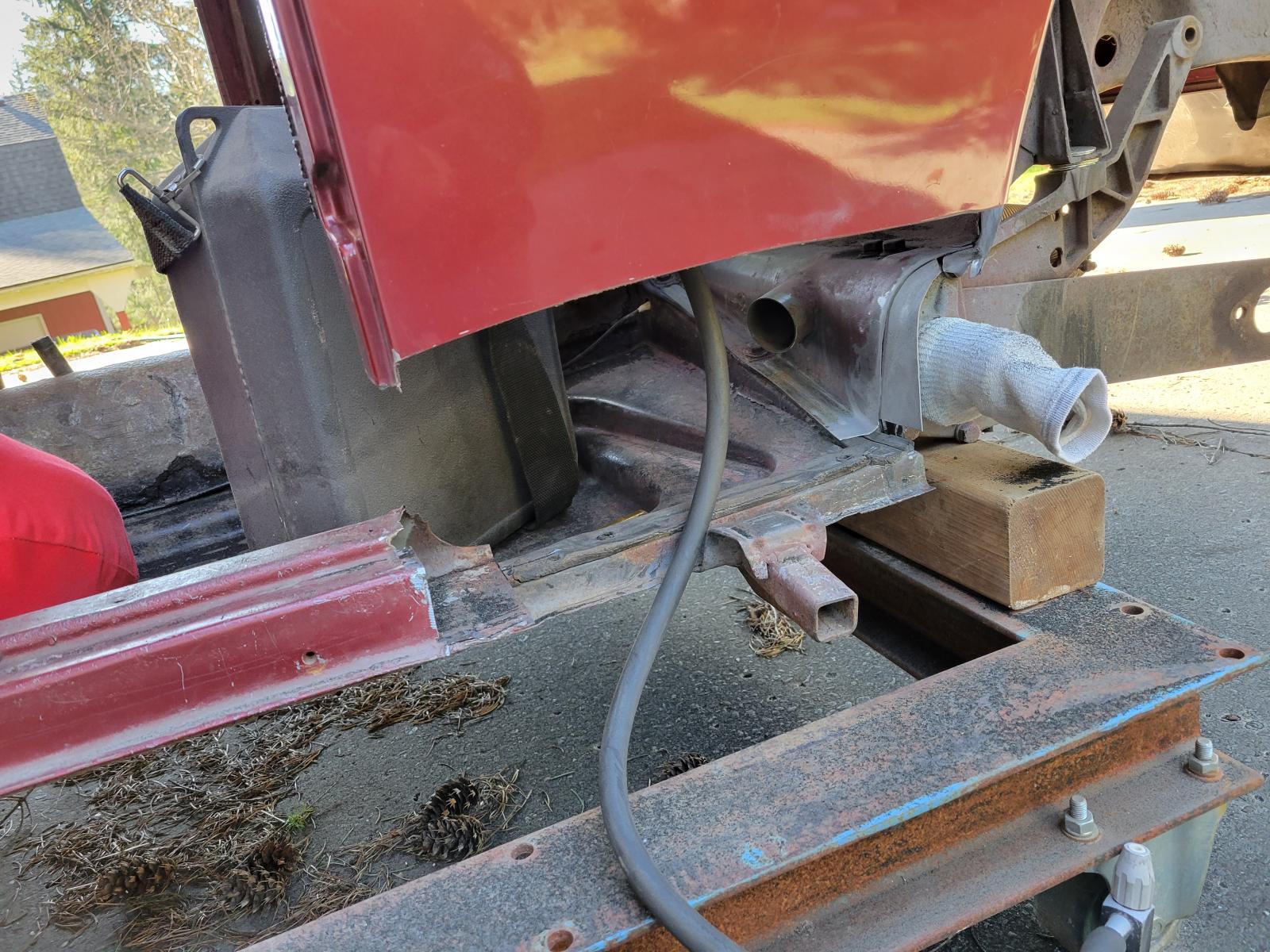

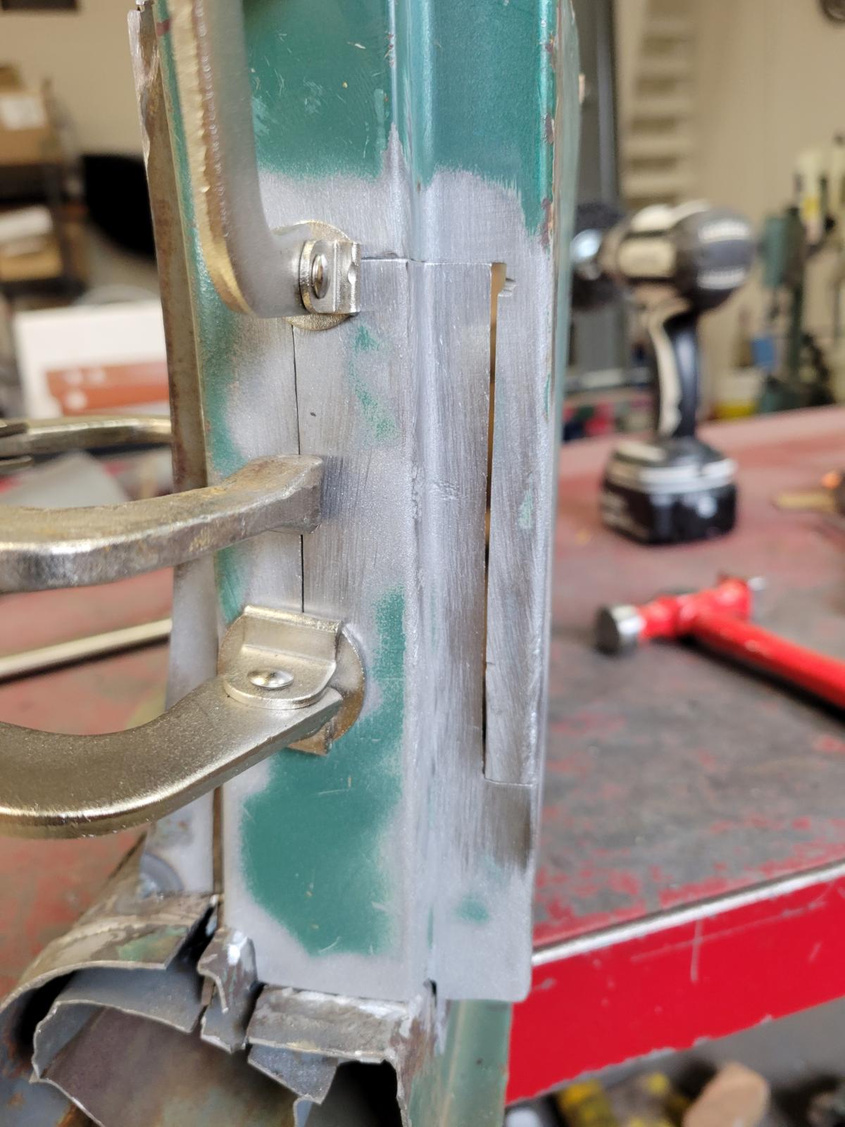

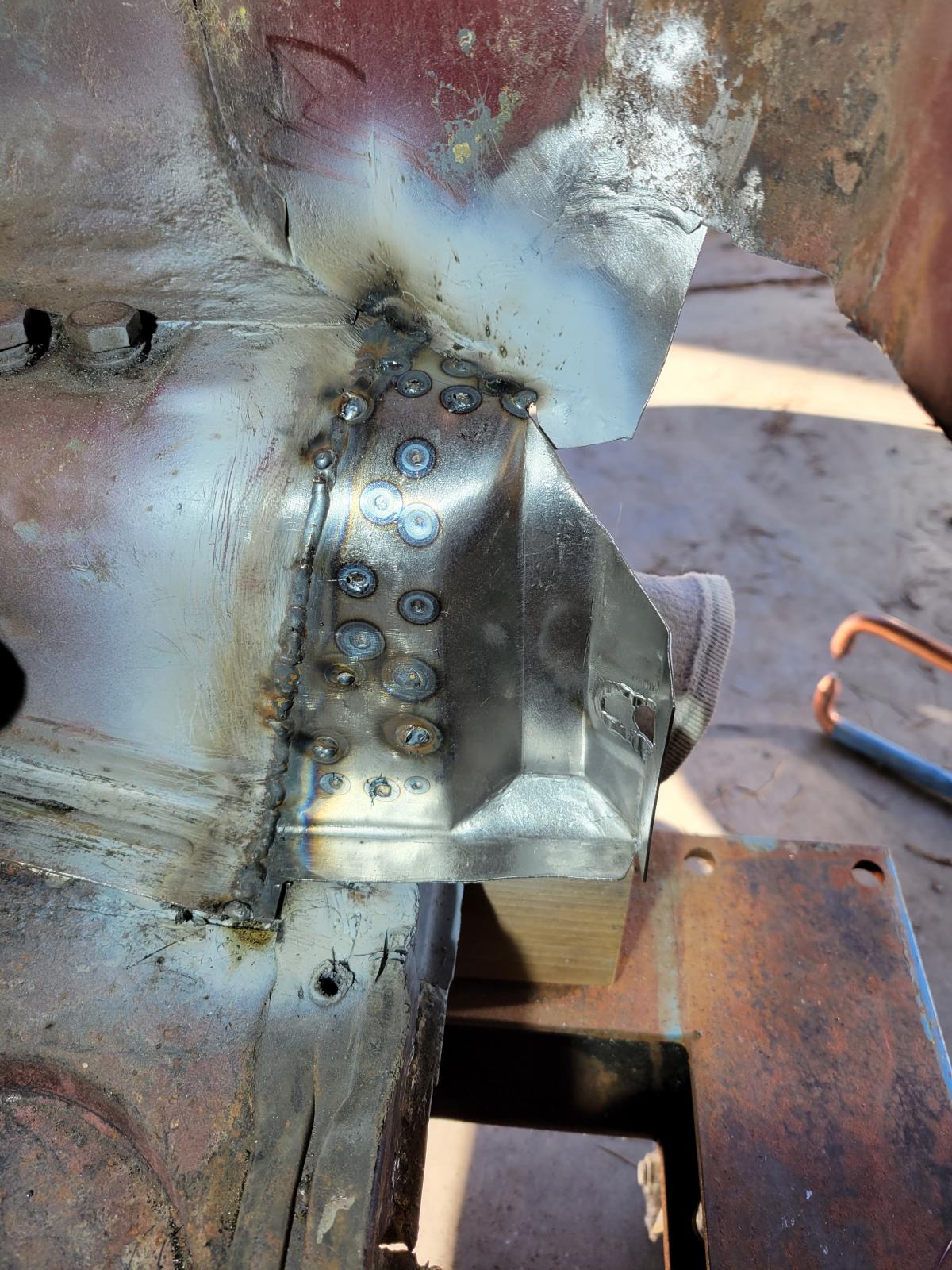

Got the car mostly stripped down to the sheet metal. Here are the immediate challenges I will focus on. Drivers side quarter and heater channel prep for removal. I thought I put them in order but evidently not. I will let the pix do the talking. SO NICE getting rid of that rust.
My old high school level repair.
Cutting away to see the best way to approach. Cautious to preserve as much as possible of good metal.
Side Saddle work position!

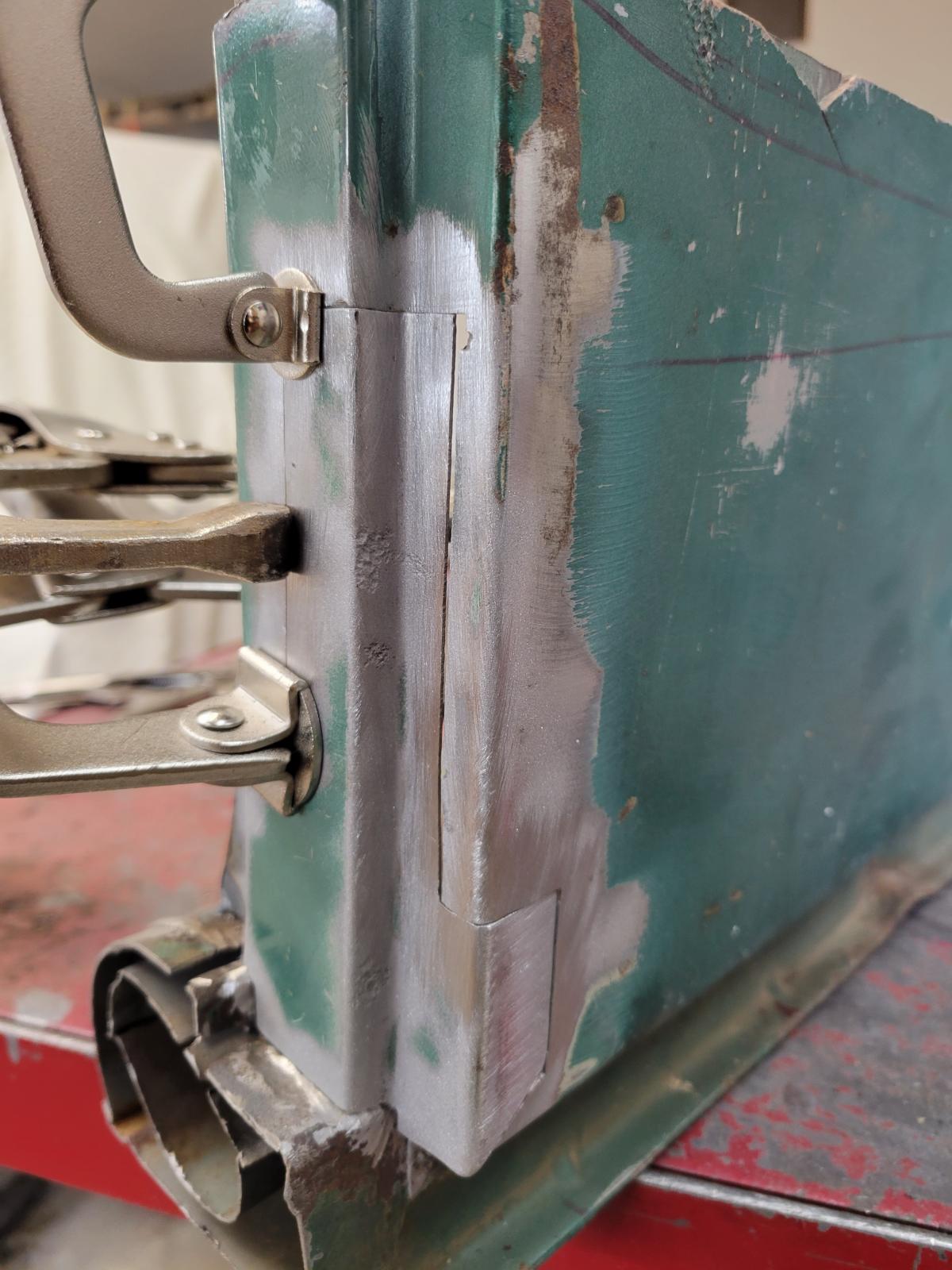

Small patch made in the inner fender that laps below the other new part.
One of the many test fitups. That trapezoid shape and outer flange must be exactly 57mm wider than the (hidden) doubler edge in order to locate the heater channel and later quarter panel flange.
How I modified the new KF heater channel flange to close the opening of pre '56 shape body.
Sandblasting and prep with weld through primer.
Finished this part!
Next is prepping the new outer quarter panel metal I bought from Virtanen, and my attempt at rebuilding a usable 1960 lower panel. I am still debating on which to actually use. I had to make significant mods to the new panel to match the shape of the original VW.

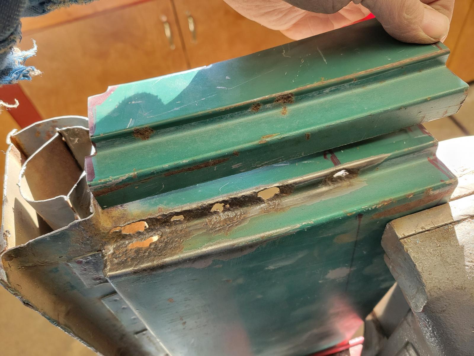

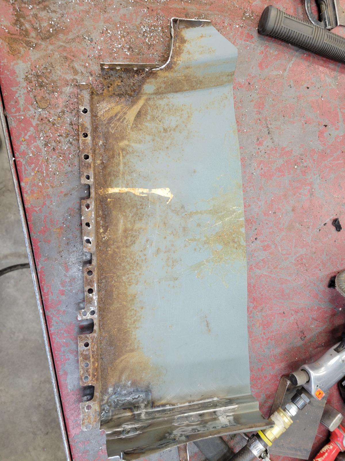

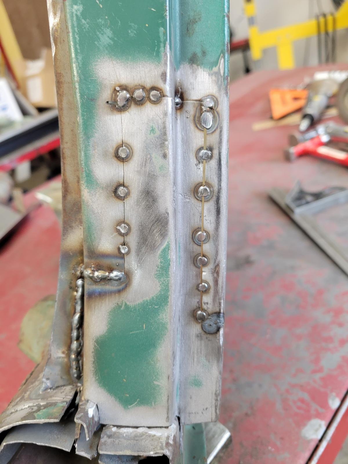

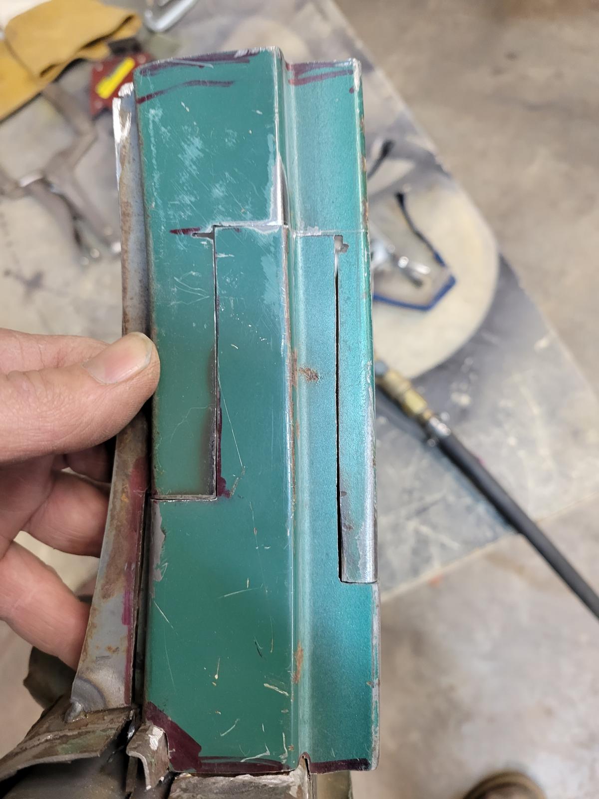

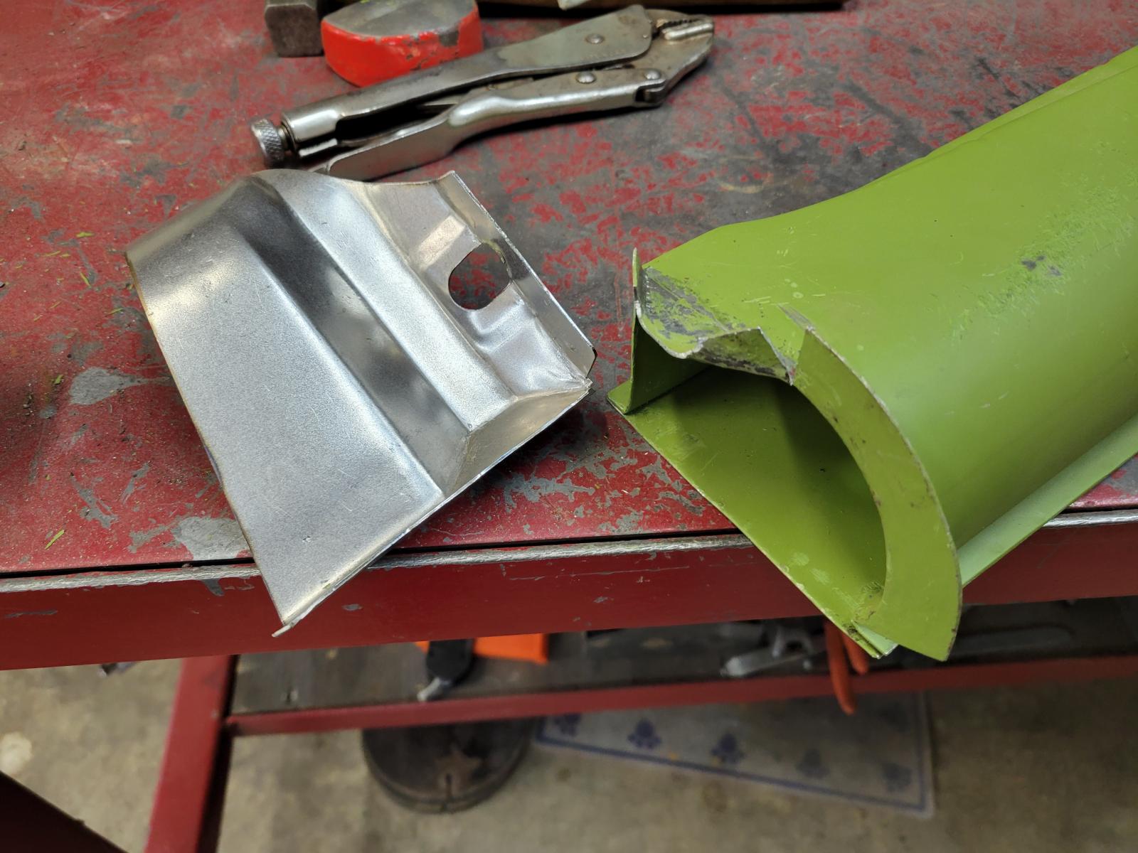

So here is my thinking for the next phase on this quarter panel. I intend to fit the new piece in while leaving the remnants of the heater channel in place. This way I think I can get the best match to the original position, and use the new cross member metal at that precise 57mm. To mimic the heater channel surface and make a clamping edge, I temporarily put a channel piece in place.

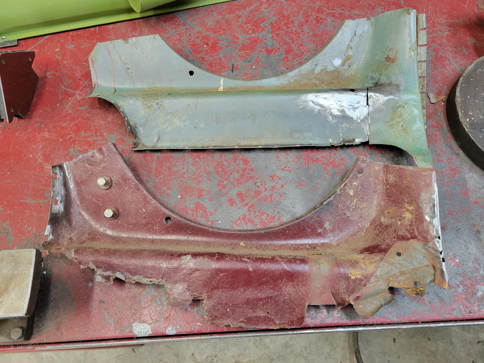

So here is one of my donor parts. It is a section from a 1960, but it needs repairs before taking it any further. The door jamb had some rust through just in spots so I work figured out a graft from another part original metal of that jamb which should match the bend radius and overall curve.

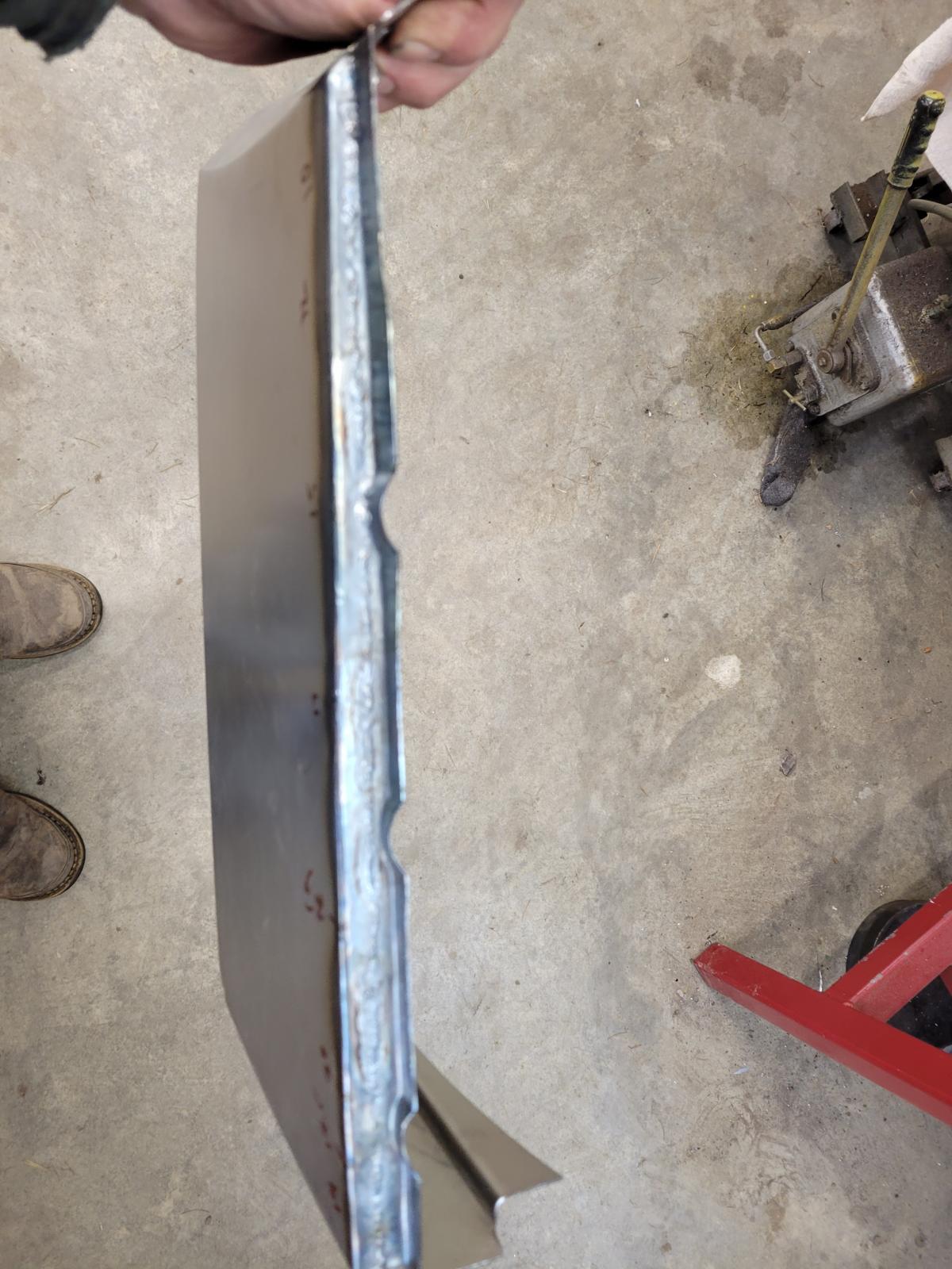

Figuring out what others have said to do to butt weld sheet metal with minimal warping.
Finish welded, ground smooth then separated from the old heater channel, ready for the next thing to do.

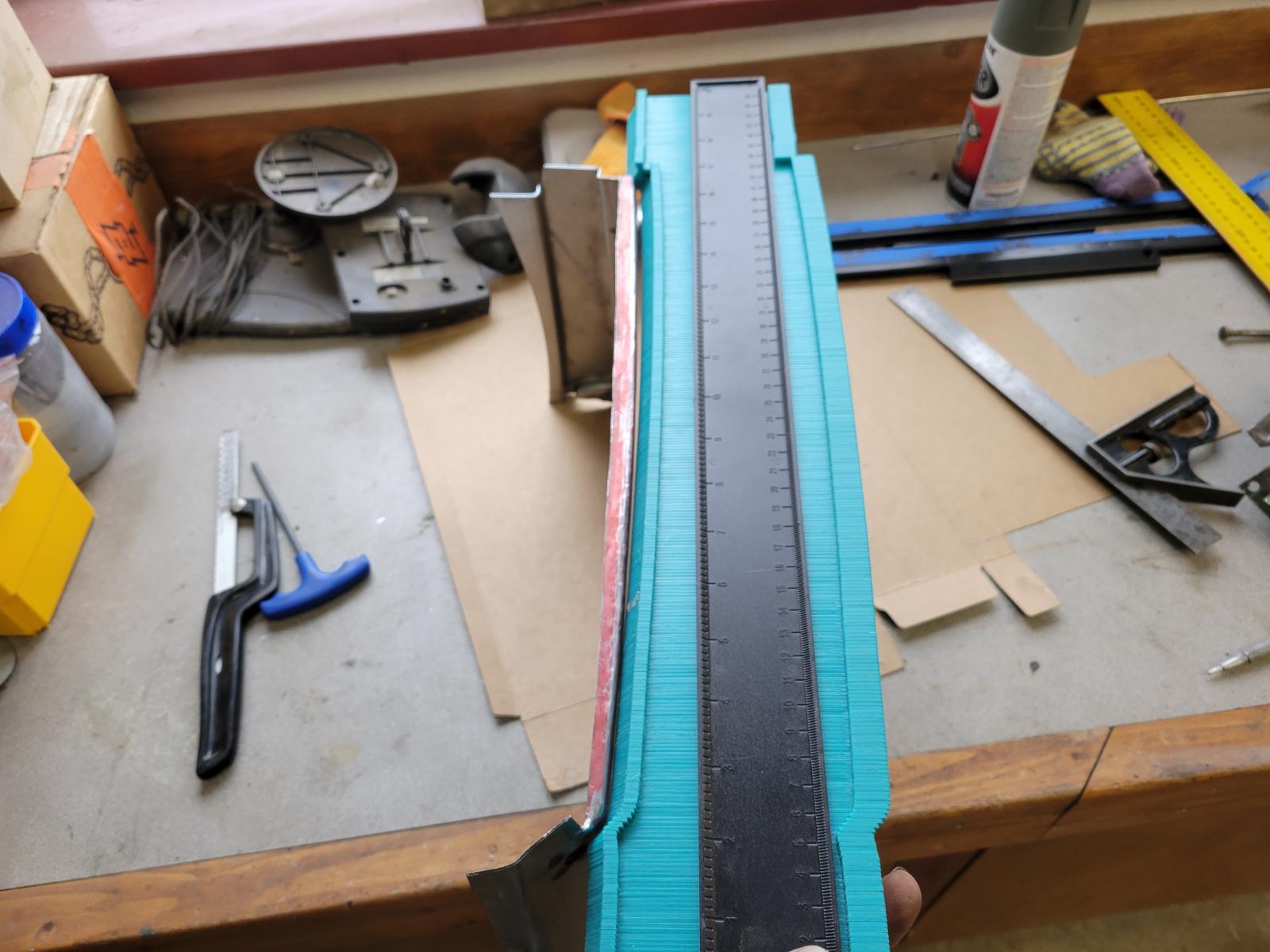

So then I saw how different the new panel is from the shape of the original. The bottom flange where the drain holes are is 3-4mm wider than the original. After much thought of whether to do more repair on the original (more rust), I decided to bite the bullet and trim out a strip from the new. I measured the profile at various points and essentially made the new match the old. Very easy to weld on that new metal for sure.
The lower edge of the flange was not straight either. I used a thick steel bar to reshape the edge to a straight line and good corner.
Edge comparison.

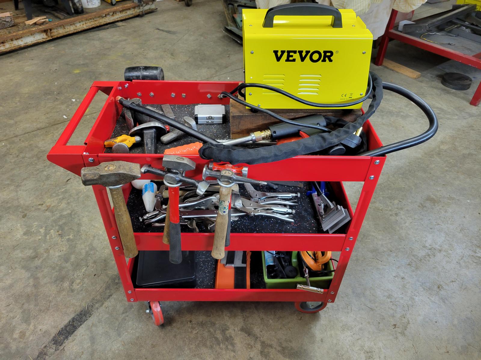

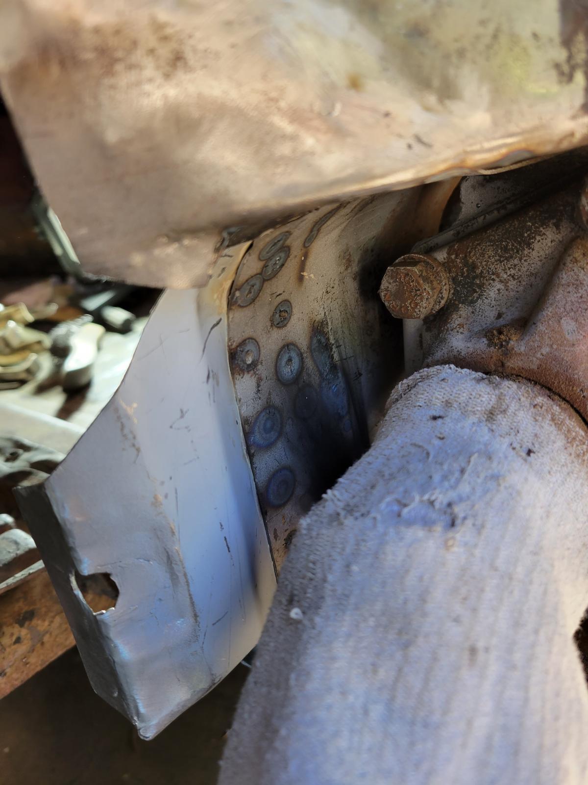

Some LR quarter side work that I have done. Had a couple of dents up near the trim that needed attention. I had a cheap hot glue dent puller kit as a first attempt. After many tries, it just did not work. I think the metal was just too cold for good adhesion. Plus the curved shape and sharpness of the dents made them pretty solid. Plus I am a noob with those and may not realize their capabilities and limitations.
Thanks to this site though, I saw another member who bought one of these spot welding dent puller tools. I have seen commercial ones in use but thought they were way out of my budget. Shoot these were about $300 shipped! And they work! Has keys and zig sag wire, washers, shrinking carbon rods. Mine is the 240v version. I made up this cart with my new spot welder and most of my body work tools. Again inspired by other members.
My first use of such tool. Probably a bit too pocked up but heck it was more or less a blind side pull.

A little progress this weekend. Not as much as I hoped but heck, progress is progress.
Still nervous about taking action on "the big cut" so I decided to do some less technical work. Stripping the 67 year old tar undercoating from the wheel wells. Glad that stuff was there as it probably saved much of the metal from the Pacific NorthWet climate. Used a weed burner torch for heat as the heat gun was too slow an wimpy. Xylene works good to dissolve the tar.
It is interesting to see more of the color it once was.... Someday... Some Day..
Then I got started on fitting the new panel at the left rear quarter. Got the front edge close to fit. Found out though that the zig zag door seal shape is different by 2mm. I will have to cut it down and reweld. Dang. The wheel well line is off by about 4mm too. Double dang!. All three sides of this panel need modification for proper fitment.
1-0900722 die langsame grüne Schildkröte
