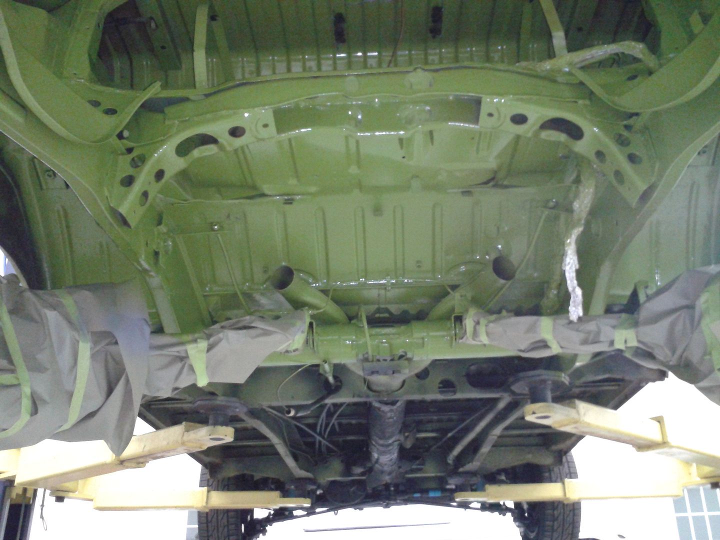

Looking for suggestions on cleaning up/paining the suspension and underneath here. What’s the best way to get rid of the dirt, oil, grime, rust, etc? Does it come down to some good old fashioned manual labor? I’ve started with purple power, and a wire brush lol. I’ll probably bead blast and paint the bearing housings and brake backings since they’re out anyway. I was thinking about using POR15. Let me know what you all think!
"No description available for special paint jobs"

I used POR-15 on my undercarriage 20+ years ago and it appears to be holding up well. I used the marine clean + metal ready stuff that POR-15 sells (followed instructions to the T). I ended up using a half face respirator and safety glasses as I was under the bus b/c of close quarters (VOCs from the paint) and drips in the face. Good luck with it all - keep up the good work!
Thanks for the input! How did the cleaner do? Still lots of scraping? I'll probably go ahead and order the kit and give it a try.

POR-15 is shit these days. look lit up, it comes off by the sheet.
I would soak the hell out of everything with Super Clean. Not purple power, not grape Kool-Aid real Super clean. Hit it with a pressure washer. Heated pressure washer is better if you have one.
i've done this a few times
I was thinking about pressure washer. I'd have to set up some curtains and a trough system or something as it's in my garage lol.
