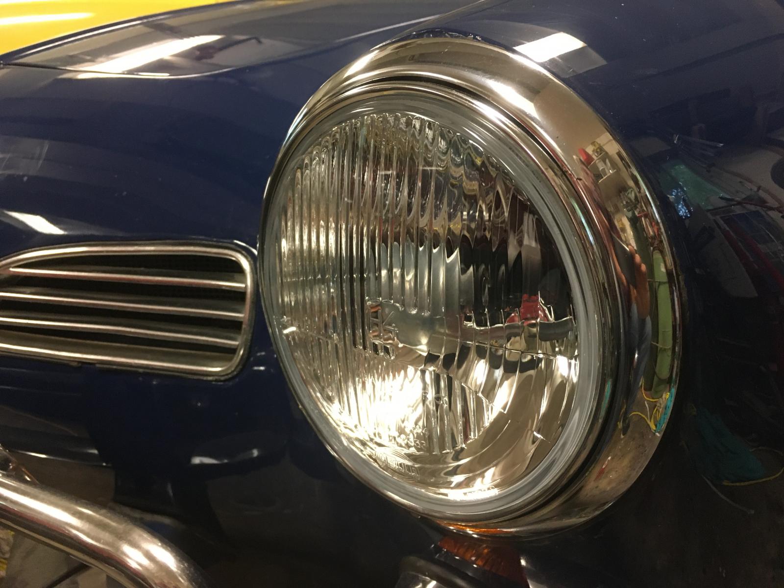

I put these in my '70 convertible, and they are definitely brighter than the originals so far, but I have only had it out after dark a couple of times so far. The only thing I don't like about them is the bluish tint, like a lot of the newer lights I see on the road these days, but I can live with it as long as I can see to drive. They are 12 volt, but I'm pretty sure they also have a 6 volt version.
https://vintagecarleds.com/shop/7-inch/vc3500-classic-kit/
When I talked to them, they recommended the classic lens upgrade, because it is more rounded and looks better in cars like ours where the headlight is exposed and becomes part of the shape of the car, and the standard lens is just flat and doesn't look right.

Not sure if your current lights have removable bulbs or not, but if they do, you could try upgrading them for more light output.
If not, consider installing some H4 housings & bulbs, similar to these below ↓
https://www.jbugs.com/product/9311.html?utm_conten...gKvWfD_BwE
https://www.ebay.com/itm/6-Volt-Halogen-Headlight-...0#viTabs_0
The 6V H4 bulbs are only 35/35W, but should still be an improvement over standard headlights.
Dave
I bought the same with the Hella lens upgrade. They are not quite rounded enough for me but still very nice. I will probably buy a set of the classic to put in and use the Hellas in another car where it won't matter.
