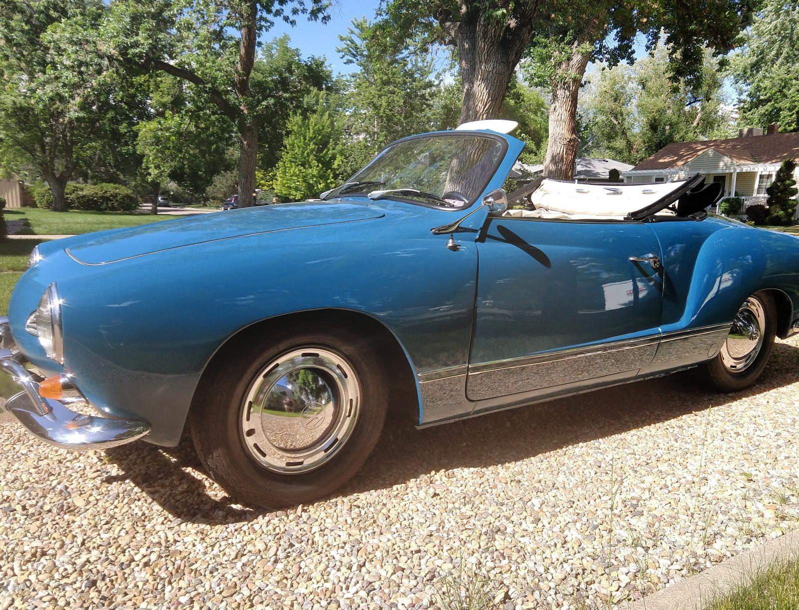

I like to use my headlights a lot, even in daytime. The car is low and dark and other drivers just don't seem to see it. Kinda like a motorcycle in that respect.
My 6v charging system doesn't seem to actually charge when the headlights are on. In fact, I think the battery actually goes down, even on the highway. I just put in a "new" rebuilt Bosch generator, but it doesn't seem any more powerful than the old one. I put in a new wiring harness not long ago. When the car is idling, switching on the headlights drops the voltage at the dash to around 5v. I don't know if that is normal. I'm running an Optima Red Top AGM battery:
Also, the headlights are not all that bright for night driving. Sometimes it's hard to tell if they are even on!
With all the great innovations in LED lighting, I've been toying with the idea of putting in something like this:
https://www.amazon.com/dp/B016H43O0U/ref=cm_sw_em_r_mt_dp_U_QqCoDbCSPKVB0 (Damn pricey!)
Has anyone tried fitting something like these to a 6v Ghia?
