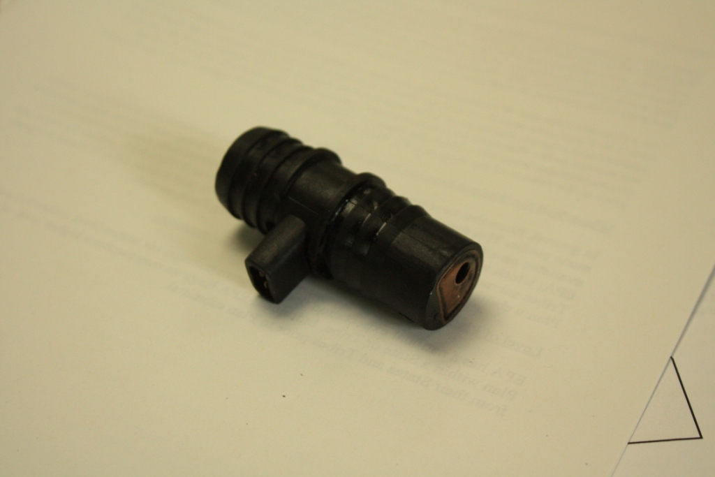

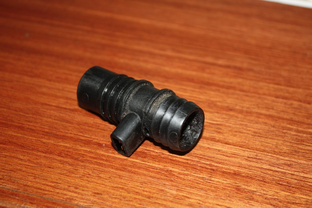

Don't know if anyone will find this valuable or not, but as I begin to fiddle and diagnose my own Vanagon troubles I sometimes come accross parts that I have no idea who, what or why they are. The Bentely may show it, but its not labeled; I'll see it listed under a half dozen names in the classifieds, and usually even my local VW mechanic is stumped. Nevertheless the Samba is a rich source of experience and it is threads like these that get me good and "learned."
So, perhaps this thread could be of use for those in similar situtations, perhaps even a "sticky?"
This past weekend I was once again tinkering with my 89 2.1L tintop, cleaning up the FI parts from an earlier tranny oil cooler fail (oil in the coolant) when I pulled the following sensor off of the intake boot. This sensor sits between the oil/case tower hose and the intake boot to the throttle body. It showed the oil/water deposits of my latest problem and a whole bunch of other gunk; it was not until I pulled a clean one off my spare 2.1L that I noticed that the interior of this hose adaptor has a copper shield that receives a current. What is it for, what do you call it and how does it work?
Terry Kay in his ad ( http://www.thesamba.com/vw/classifieds/detail.php?id=302892 ) calls it a vent line heating element. What does it heat the pressured air from the case?
I already replaced this one with a cleaner one, but I would still like to know what this component is. Thanks in advance.

PostPosted: Tue Jun 12, 2012 2:06 pm    Post subject: Reply with quote
pg 17
http://shoebox-electronix.com/sitebuildercontent/sitebuilderfiles/8385_UMTG_9-26-08.pdf

that looks like the gizmo in the oil breather line that heats up the oil vapor

PostPosted: Tue Jun 12, 2012 2:15 pm    Post subject: Reply with quote
Vent Line Heating Element (Canadian vehicles only)
A heating element is used on the crankcase vent line to prevent icing during cold engine operation. This element can be checked with an ohmmeter. The circuitry to operate the heating element is protected by an in-line 5A fuse, located in the wiring connector box in the engine compartment.

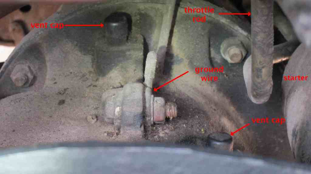

PostPosted: Wed Jun 13, 2012 3:22 pm    Post subject: Reply with quote
Here is a view of the top of an automatic trans. equipped 1986 Van, take by looking forward from the engine compartment just under the firewall.
Is it labelled correctly?
Also, if that is a gnd. then where does it go?

PostPosted: Wed Jun 13, 2012 3:45 pm    Post subject: Reply with quote
If that "ground" wire is a curved piece of steel it is a support for a hose that goes across the top of the tranny on some models.

PostPosted: Wed Jun 13, 2012 4:05 pm    Post subject: Reply with quote
Thx Mark - that must be it.
