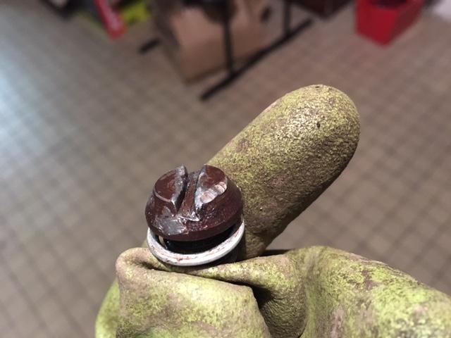

Well I do not know for Belgium but in France the knowhow of those machine shop are really limited... not to say inexistent. Here are pictures of my plug :

Why not have someone weld the top and cut a new slot?

If I do not find the part, that's a good idea. I would weld a nut in this case to be able to dismantle it without damaging it anymore.
