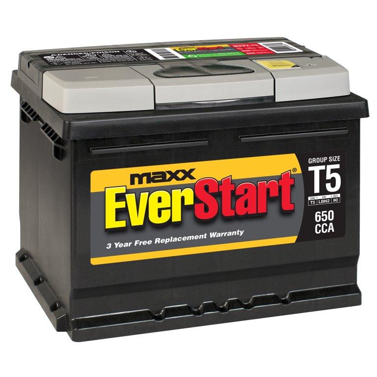

Try a walmart T5 Maxx battery 149.84 3 year warranty

Group 42 batteries are some of the shortest car batteries made. Everything else is usually taller. This becomes a problem for the Beetle which places the battery below the rear seat. Too tall and the rear seat starts to rest on the battery. Either applying weight to the top or shorting the terminals to the metal frame under the seat.
The T5 is probably the closest modern battery to the old Group 42. It is short and has posts that do not stick up proud of the top of the battery like most top post models.
Power wise, the Group 42 was rated at around 400-450 CCA. Pretty much any modern battery will exceed that and will work just fine. Note above the T5 is rated to 650 CCA! More than enough power for the Beetle engine.

I just bought one of the T5 batteries at Walmart this morning for my 70 bug convertible, it fits perfect!
