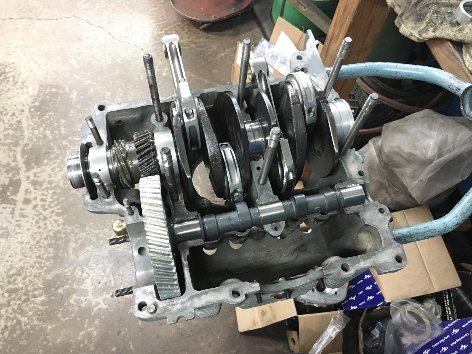

I used aaperformance h beam rods on my 74x83 36hp. I clearanced the rods for the cam lobes. cam is a web cam grind 1630 for a porsche 356 pre a 1500 sport ground on a ww blank. .335 lift 290 duration 268 duration at .050. If you want more lift use ratio rockers. I used the aaperformance 1:1.15 to get a little more.
