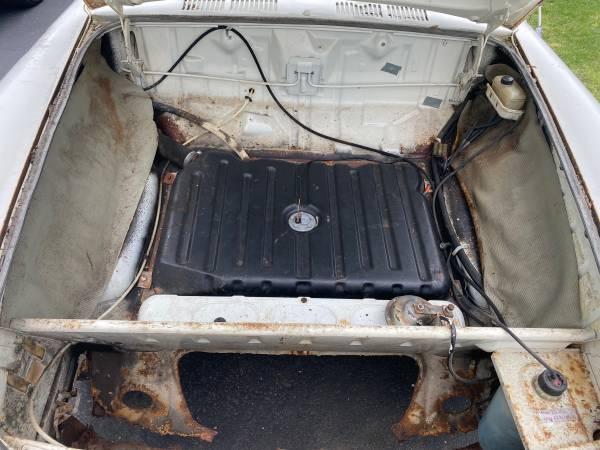

FINALLY.. got her home!
Engine Running: https://youtube.com/shorts/JnjxeMCbG6M?feature=share
the rust on the "load floor"? is the worst I could find, which for New England is "no rust" .
I guess this is technically a project or build but more like a tinker thread cuz i have been known to gets shipwrights disease.
There is a bit more "whiffs" of gas then Im comfortable with, could it be the runner seals? theres no gas puddling, or should I tackle the charcoal and evap cans?
I looked at that thread that seems to bypass the evap canister and vent it into the atmosphere, but isnt that still going to contribute to the gas smell?
First drive
anything that jumps out right away as being problematic or wrong?

For the gas smell, check the vent tube that leads from the end of the filler nozzle in the fender back to the filler pipe. These are rubber, and after 50 years they get cracked and/or just fall apart. If that happens, your tank is just open to atmosphere all the time, so smelling fuel even inside the car is a regular occurrence. This was the case on mine when I bought it, and it was worse every time I filled it up and then made a left turn, since the fuel level was high enough then to slosh through that vent line and out through the break into the right front fender opening.
If this does prove to be the source of the fuel smell, then you can buy a replacement vent tube from ISP West, or I think Jim Adney makes a kit for the same purpose.

Yes, that hose is a common source for a fuel smell. So is the larger filler neck hose, as you can't see any cracks in it since it's cloth covered. The kit from Jim includes the vent hose with a much better type of hose and includes everything you need to install it but the actual labor. You do need to tell him the year of your car, as some kits have more parts (hoses) than others. I'd also replace the large filler hose with one from ISP, as it's almost 50 years old now.

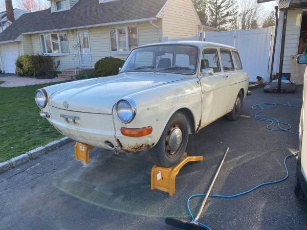

Its a 1973 that was originally texas yellow (the inside still is, more pix in gallery)
PO said he had it repainted "sunshine yellow". It kinda looks like it? Id have preferred he left it the original color, but new englanders cant be choosers.
Ya, its really solid overall, especially for up here. Its the first VW ive owned that starts, runs, drives, stops, and doesnt have rust holes you could throw a dog through.
The decklid (?) is about the worst of it.
The guy who bought the buses and alot of the parts hoard has a few type 3s, and he brought me over a set of 73 seats, and a hatch. Hes going to cut me a decklid out , but for now im just going to wire brush it, ospho it, maybe Por Patch the pinholes and then masterseries it.
As Jetfxr69 told me last night "DONT tear it apart and render it unusuable..just drive it and have some fun"
It looks like the front where the jack goes and on the other side have been patched, but welded metal and not bondo.

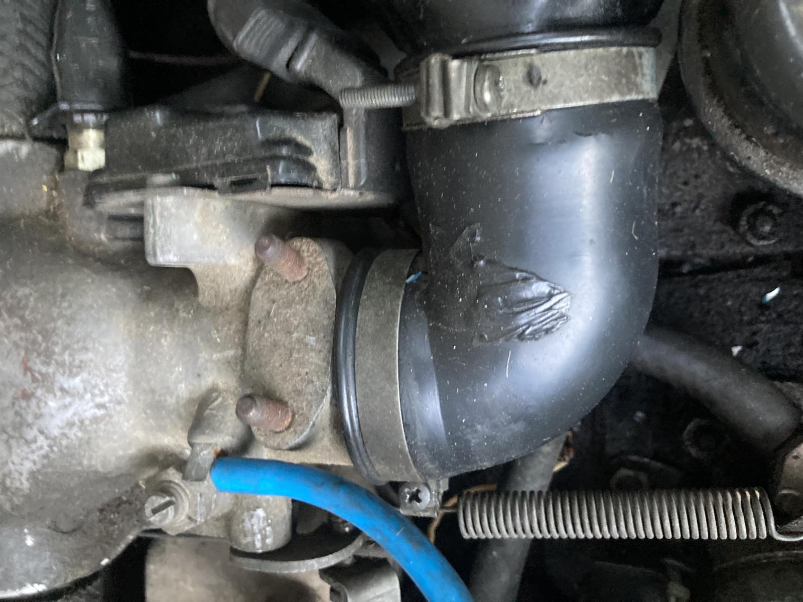

3. a few of the vacuum hoses on the engine werent on too well (one of the head vents?) and the long one that sits up agains the firewall is actually some sort of radiator hose, so I gotta change that too.
4. then theres this funky one? is there an actual hose for that?
5. So then i started poking around a bit, and I notices that this is missing. I think its an EGR thing, as it was once a california car
that aircleaner elbow is also super skethcy

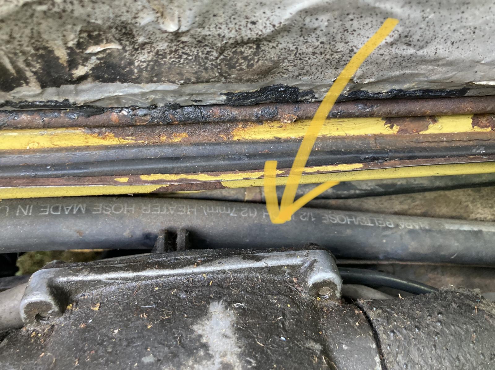

I suspect the stink is multifactoral, and one place might be the evap hard line along the pan.
Jim had said its kindof a project to try and redo that, but that is one thing I am good at is making weird stuff work.
I can, for now, just do it over the top as his kit does, and "for the winter" redo the whole thing as I found this picture on the samba
and it kindof makes sense to me how it all goes together.
He had said bending the copper/nickel brake line to recreate the factory line "could" be done, its just time intensive.

Keep in mind that some of the later cars got a plastic line (tubing) that ran in the pan edge indent with clips to hold it in place. Not saying it can't be done in steel either. As for the canisters (yes plural), the front one usually rots out from collecting dirt and water on top, then while rusting the metal canister, the rust starts working on the inner trunk wall. One of the reasons VW didn't put the canister in the front trunk, is that in some colder climates these cars got a gas heater located in the trunk. Most didn't, but VW kept that space open for one anyway. The under the rear load floor canister usually had it's hoses fall off, and didn't really work like it should, as it was hidden out of sight, and never got changed. By now most of the charcoal is gone, and it's just an empty can.
That large hose you see in front of the plenum is a vent hose for the left (3-4 side) head, to pull air from the air cleaner. Same with the split hose on the right (1-2 head). They're part of the EVAP/PCV system, which was only used in 72 (California models) and 73 models to meet emissions standards. That hose shouldn't be a cause of the fuel smell, unless you have a leaking injector, and it's contaminating the oil. KTPhil has posted the later model hose layout, but it's also in the Brown Bentley manual. Earlier versions of it are in color, while later versions of the manual are done in black and white, so keep that in mind.
There should be a throttle slow down valve bolted to those 2 studs on the plenum (like later buses used) to slow the throttle down from closing on "over run" according to Ray. It's a California thing. As it is, a good chunk of the Cal only stuff is missing, and the 73's were the last version of the type 3 which is why that 70 belonging to your new friend's car looked simplified compared to your own car.

Those thin metal fuel vapor lines are probably rusted internally and do not pass any fumes. So the charcoal canister and expansion tank aren't actually doing anything. You could remove them and vent the tank to the atmosphere without too much of a guilty conscience.
Another leak source is the filler neck, and the thick filler rubber pip. The filler neck is vital in that with cracks the water and dirt that get thrown up find their way into the tank. Then they migrate to the low spot, which is your expensive fuel pump, which then rusts/wears out. Best to apply preventive measures!

Where would they have put the overflow canister in the trunk if they had done such a thing?
On the drivers side , like a thing, or on the passenger side, like a Ghia? or someplace else?
If it would be cold enough up here for a gas heater, its cold enough to have the brine on the roads, and im not going to have this out on the roads then.
One thing im a bit puzzled on is I cant seem to find the "elbow macaroni" tin looking things, instead I have that tinfoil like stuff going to/from the shroud and the heater boxes.
which I think is why one of those vacuum hoses is just dangling.
No idea of what an overfill canister is on a type 3.
As for the "elbow macaroni" tin pieces, they're mainly for use with the stock muffler, as the elbows connect the fan outlets to the "pre-heaters" that are attached to the stock muffler (have a screw on connection). The hoses to the under rear load floor connect to the elbows too, which is why 1 hose is just hanging there. You can look in the Samba Classifieds and see if there's any in there, or contact Joel Mitchell (aka Boo-Koo-Z) and see if he has any.

Overfill: I meant the metal evaporative canister that is under the fender that the gas tank vent feeds to, but that you had said they left room in the trunk for with the possibility of a gas heater? where would the gas heater have gone?
Macaroni: got it, thanks!
