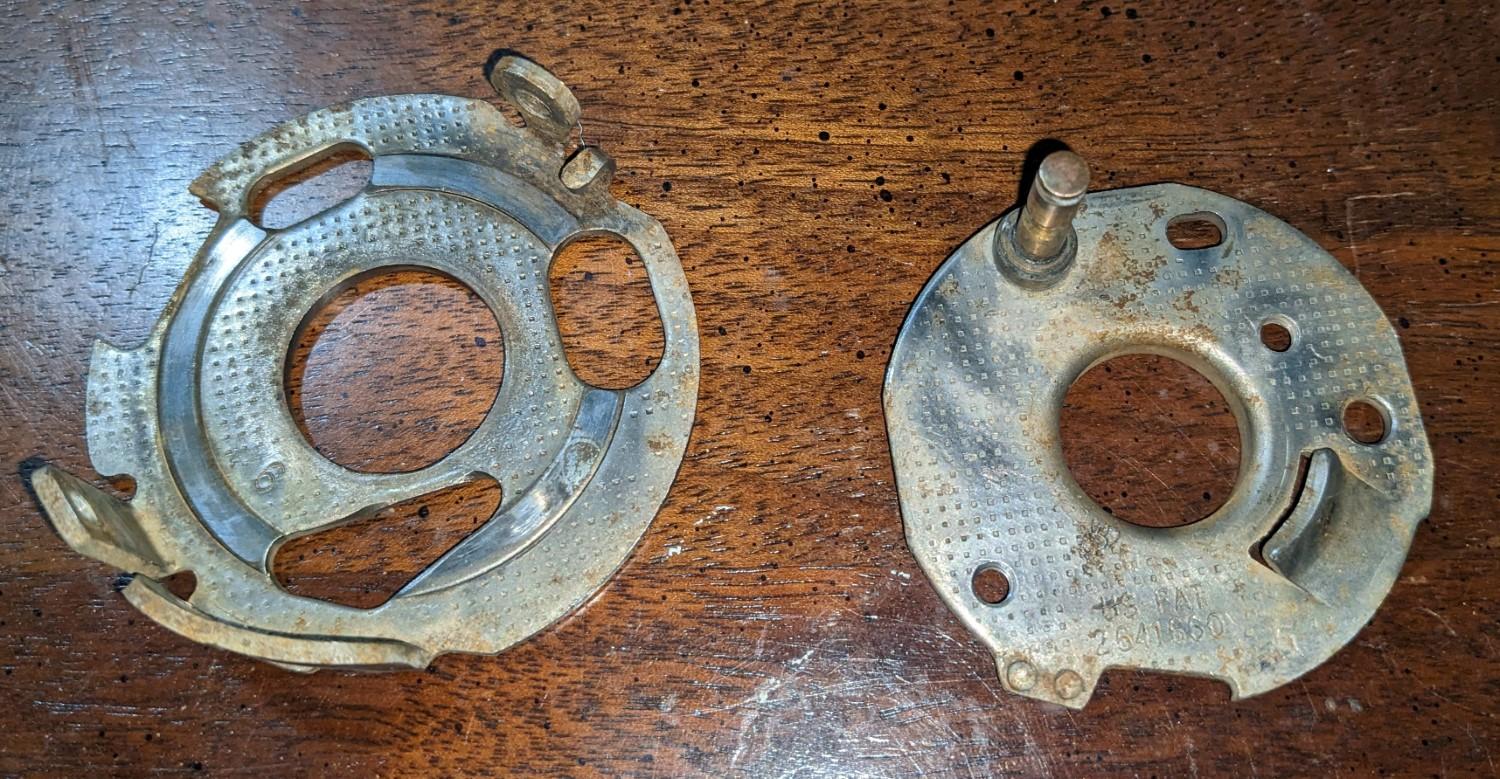

PostPosted: Sat Feb 25, 2023 12:57 pm    Post subject: Re: Going there: Rebuilding a ZV/JCU 4 R 3 Distributor Reply with quote
Ossipon wrote:
Your breaker plate has the "nubs" for adjusting the dwell as we discussed on the phone.
