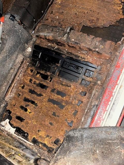

3.) anyone selling any newer ones, or at the very least, one's in better condition. Here's my passenger's side for context:
The bulk of the part is held in on the backside, which lives under the seat and faces the rear footwells. But again, would these come off as I cut out/completely remove the pans, or are these in some way attached to the body? Either way, they're inconvenient.

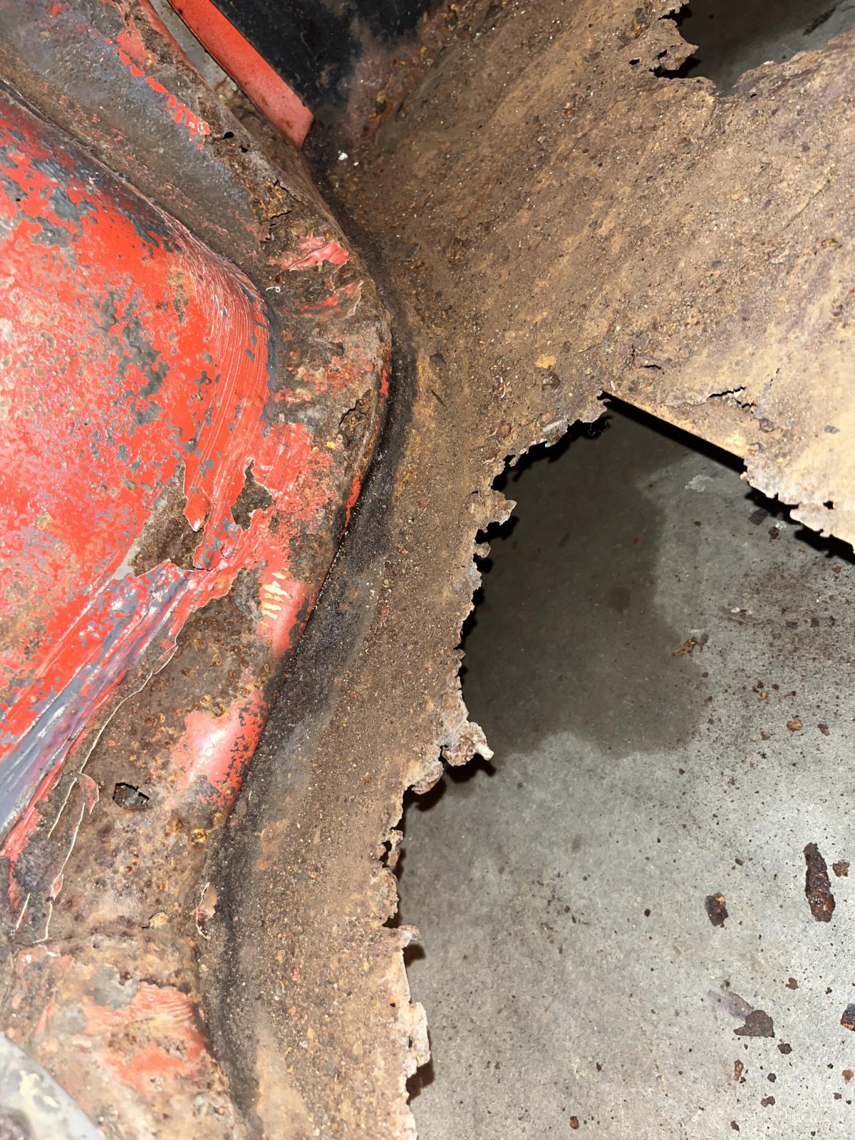

I'll be starting on the passenger's side, that way I can still potentially drive the car while I'm first experimenting with the rust repairs (just took the thing on its first test drive this past Saturday. Runs like a champ, much to my surprise). So first, the seat comes out, then the hump... and then we figure out what to do with this:
The driver's side has more body than the passengers, but the passenger's side has more floor I could welp bits into. I have the passenger's side heater channel as well, which could be used to help patch the big hole in the corner where the door hinges.
I know you're all probably looking at this and wincing, it's a ***lot*** of rust. And some of you may wince even more when I say I really don't care if the fix is ugly. That's why, as nice as it is that the pans bolt on and off, I'm fine just patching and spot-welding sheets of metal in to make something that resembles a floor (though, I do have a full driver's side pan, so that's useful material). Besides, I'm led to believe I have to take the whole body off to get the pans out, and I simply don't have the resources to do that. So the question is how I can fix it with the means I've got.
The rear footwells of the pans are structurally sound (previous owners must not have had kids). The bars that run across the fronts are sound. The edges of the driver's side floor pan, as slim as they are, are sound. All decent places to weld things onto. And I'd even consider going "half and half," cutting at the old pan where it's weak and unbolting it there, then using a new pan at those sections and welding in other spots. But the aforementioned humps are literal walls between the weak parts of my floor and the strong parts. So I need to know how to tear those down (and replace them properly so my seats don't slide around like some kind of ride at Disney world).

Oh boy, I get to fabricate new sliders... I guess those just weld right onto the pans, yeah?
Speaking of which:
Took all of 5 minutes to get the passenger's seat out. Super easy. And gave me a good view of my pans (especially in the rear). Gonna clear off the surface rust. But again, on the passenger's side at least, the rails and that middle section of the pan look solid enough to weld things too.
How do you get the risers off (thank you for the technical term)? That's one of the main things holding me up on how to proceed...

Yes they do. As you can see, they're not very long. Maybe talk to a sheet metal shop and see if the could bend you up a set or 2 out of 10 or 12 gauge metal. You'd need to get one off, so they could get the dimensions of it to make them.
The risers are spot welded to the floor pans, so you can drill them off, if you don't find any replacements. Keep in mind that these parts are similar to those used in rabbits, golf, and jetta's. So, that could open up some options on finding parts and even seat replacements. Wink
