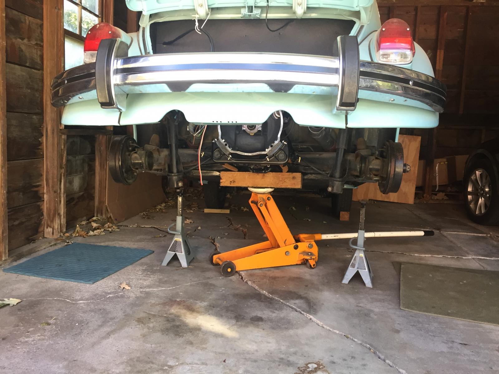

One helpful item to have when dropping an engine is a dolly for it to rest on, so you can easily remove jack from under it, plus roll the engine out from under the car and move around on garage/shop floor. I made one from scrap lumber, along with some relatively cheap castor wheels (from Harbor Freight) attached underneath.
I usually lift the rear end of car up to a “medium” height, and support on jack stands. Then I place a small piece of thick plywood on my floor jack’s lifting pad, and center the plywood and jack pad at c.g. “balance point” of the engine (i.e. more-or-less centered under oil drain sump).
I use the jack to lower engine onto the dolly, and then move the jack to just forward of the front transmission mount, and lift car high enough to roll the engine out from under it. I find that a short section of 4x4 works well for bridging the frame “forks” at that lifting point, just forward of the transmission.
See pics below for details:

That's pretty much my plan. I don't have the dolly but I have a motorcycle jack to bring the motor down and wheel it out. Then I have a way to transfer it back to the floor jack to lift it to my table mounted yoke.
I realize this is all old hat to the pros here but I'm documenting the "doing of it" for less experienced people like me. And I'm not physically able to slide 250 lbs around on the floor without some hydraulic help. Thanks!
