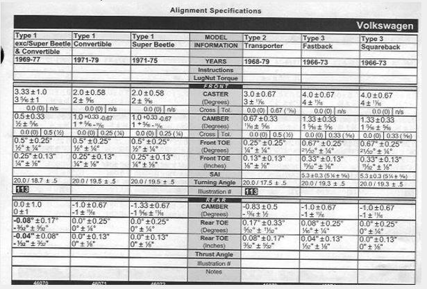

Insufficient caster will cause the vehicle to want to go anywhere but straight ahead. With the notch forward you have significantly more caster than with the notch facing back.
To achieve maximum caster, what I recommend is that you always have the notch facing dead forward +/-45°, if you can't get the camber in spec doing this then try to get the camber on both sides the same, all the while keeping the notches on both side within 45° of dead forward. It won't hurt much if the camber is a bit out of spec so long as both sides have the same camber.

Actually you would want to mark the original 90° location towards the wheel, measure the angle between the 90° position and the notch, say 50° and then turn the eccentric until the notch was 50° in front of the 90° position. This should give you close to the same camber as you had originally, but yes going to an alignment shop would be best.
There are some good DIY threads and it doesn't take much in the way of tools to do a front end alignment, I just use a tape measure, a torpedo level, and an easily made jig. A dead level surface is require if you aren't comfortable with math.
Have the alignment done with the weight you typically have on board, remember to put some weight up front to simulate the driver and passenger.

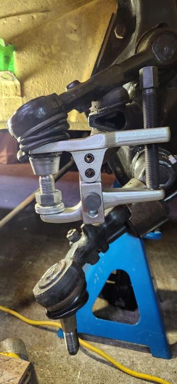

I used a ball joint separator to remove the bushing from the ball joint.
The question I have now is, should I put anti-seize compound on the outside of the bushing before reinstalling it into the steering knuckle?

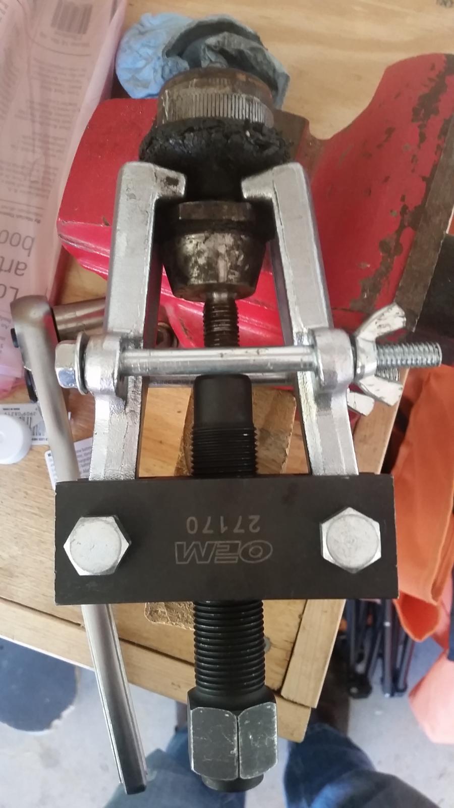

PostPosted: Tue Dec 13, 2022 11:36 am    Post subject: Re: Eccentric camber adjusting bushing Reply with quote
or use one of these and a press or BFH
