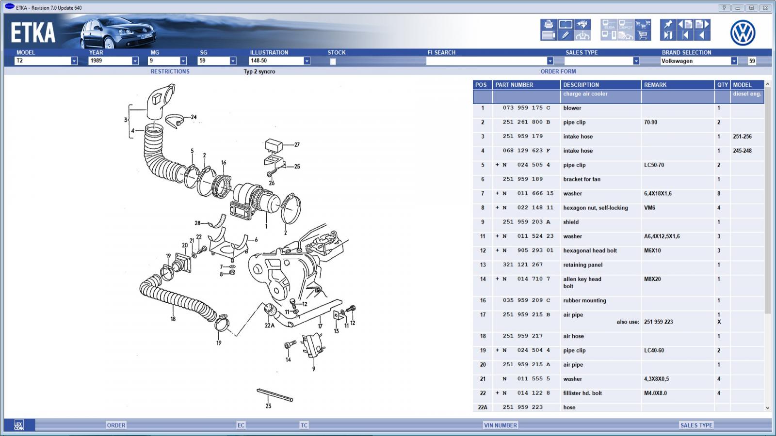

Here is the page from the VW parts microfiche for this component of your JX.
Does this help with your questions?

No it don't as that is the same picture as in the question, and I have the parts in the picture I just do not figure out how I should assemble them to the engine, as I end up with two parts(9,13) wich do not find a place and one(17) is attached with just one screw.
The main issue is that this picture just shows the parts needed but not how to assemble it.

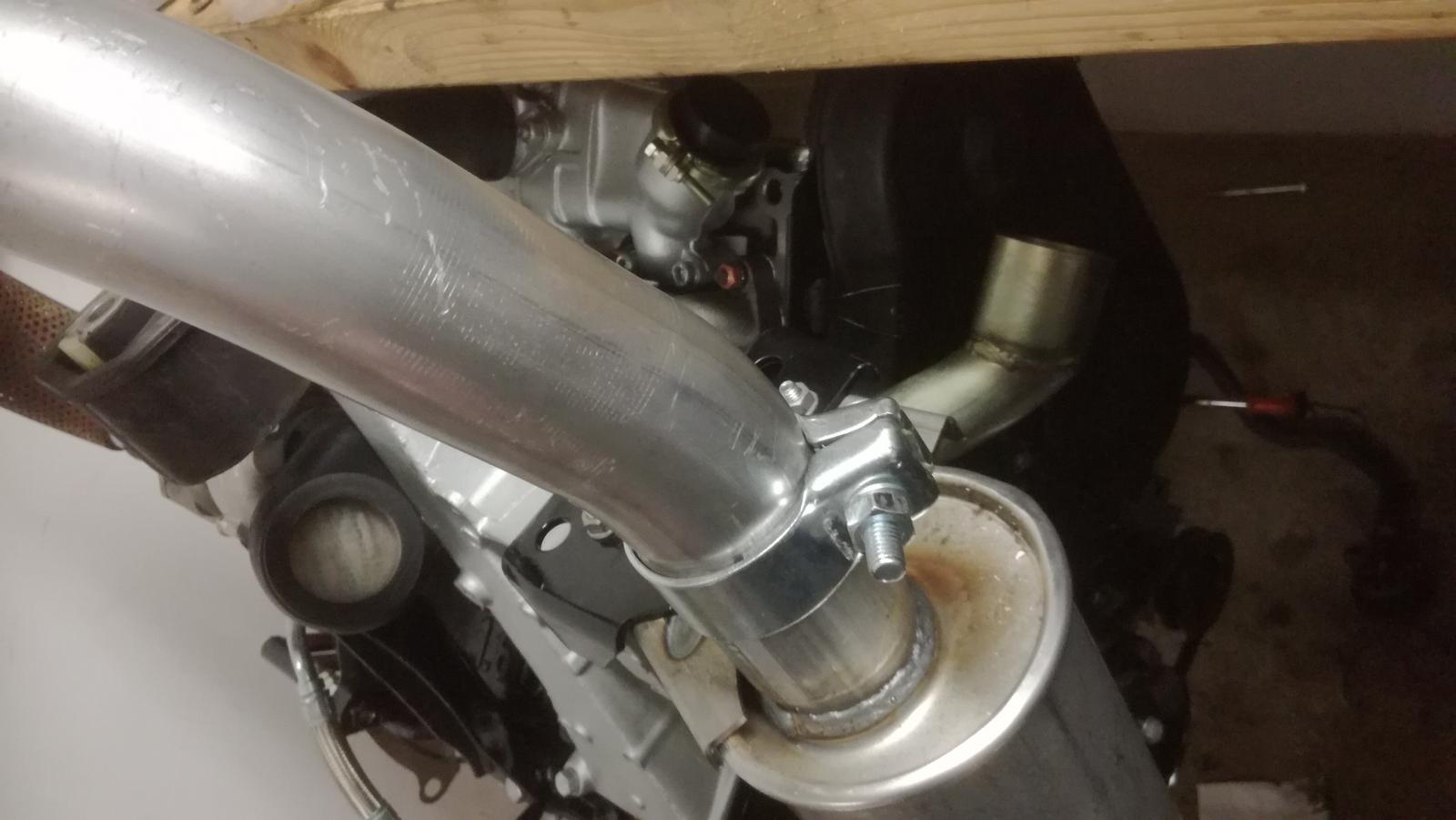

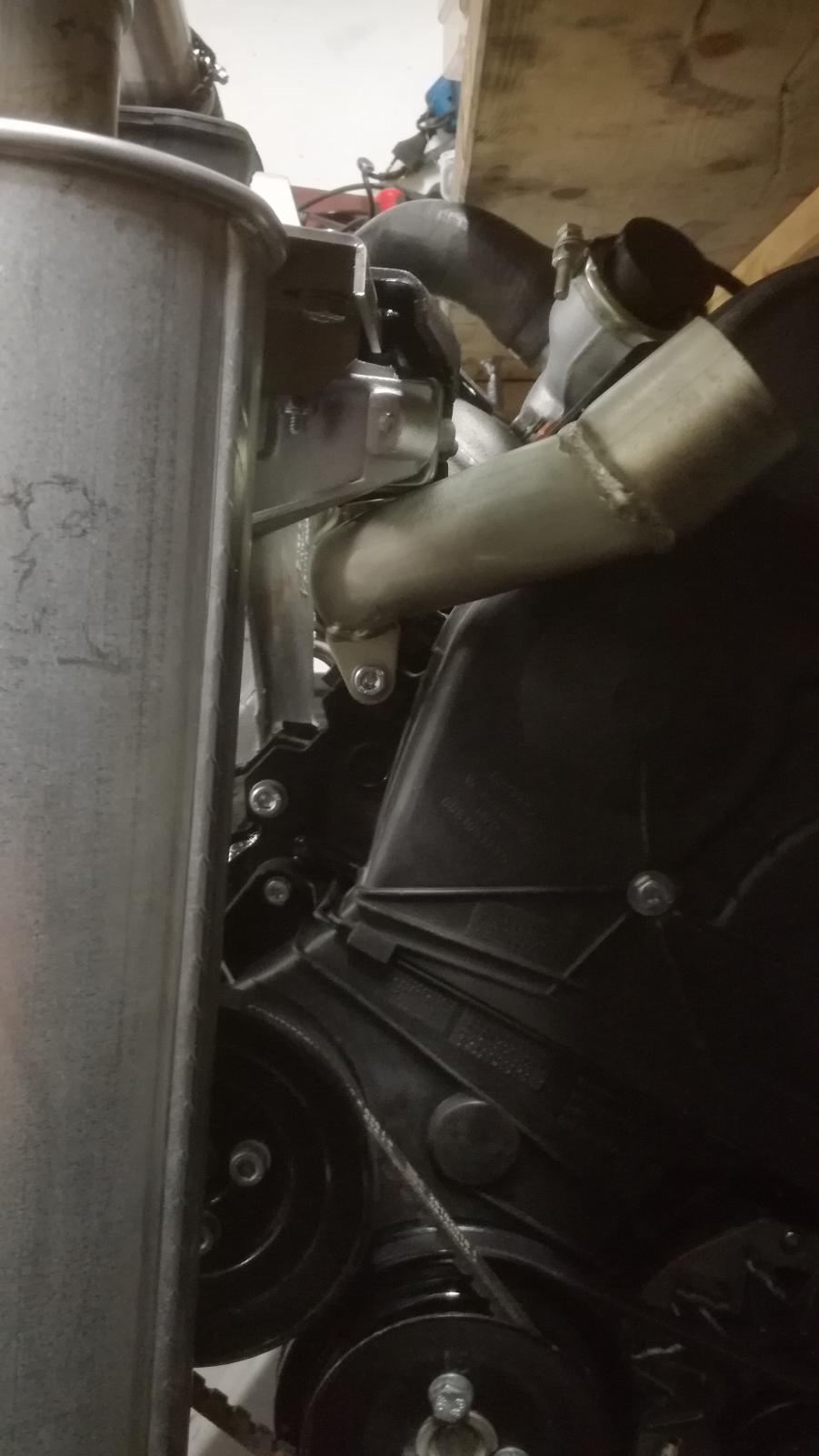

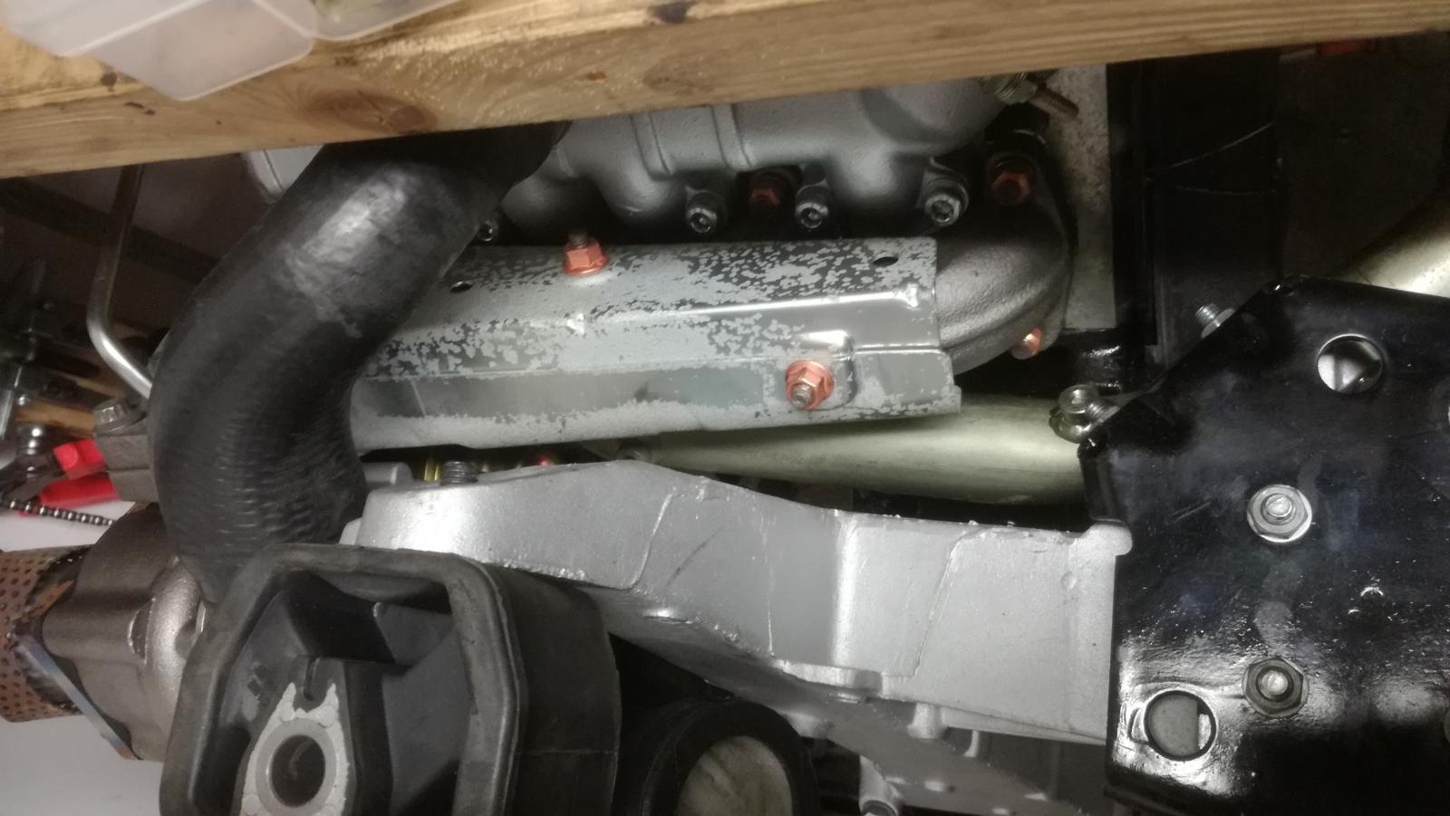

I thoght I would a couple of pictures with the pipe where I think it should maby it helps and if not atleast the topic stays active and more people will se it.

Oksu
Aren’t those parts 9, 11, 14 in the diagram provided!

PostPosted: Wed Jan 01, 2020 6:47 am    Post subject: Re: Osku's Vans Reply with quote
Yes but Do you understand where they should be installed, that is the issue.
I started to install this assembly but I did not get the pipe installed so I found that diagram and realized there was two parts I did not have so I ordered them. When I got the parts I was even more confused as I started with one part that did not fit and ordered two more. So I'm looking for assembly instructions on where exactly and how the parts should fit. In the instructin attached twice to this cahin the engine where everything should be mounted is depicted should I say a bit abstract. And we are talking about parts 9,13,17
