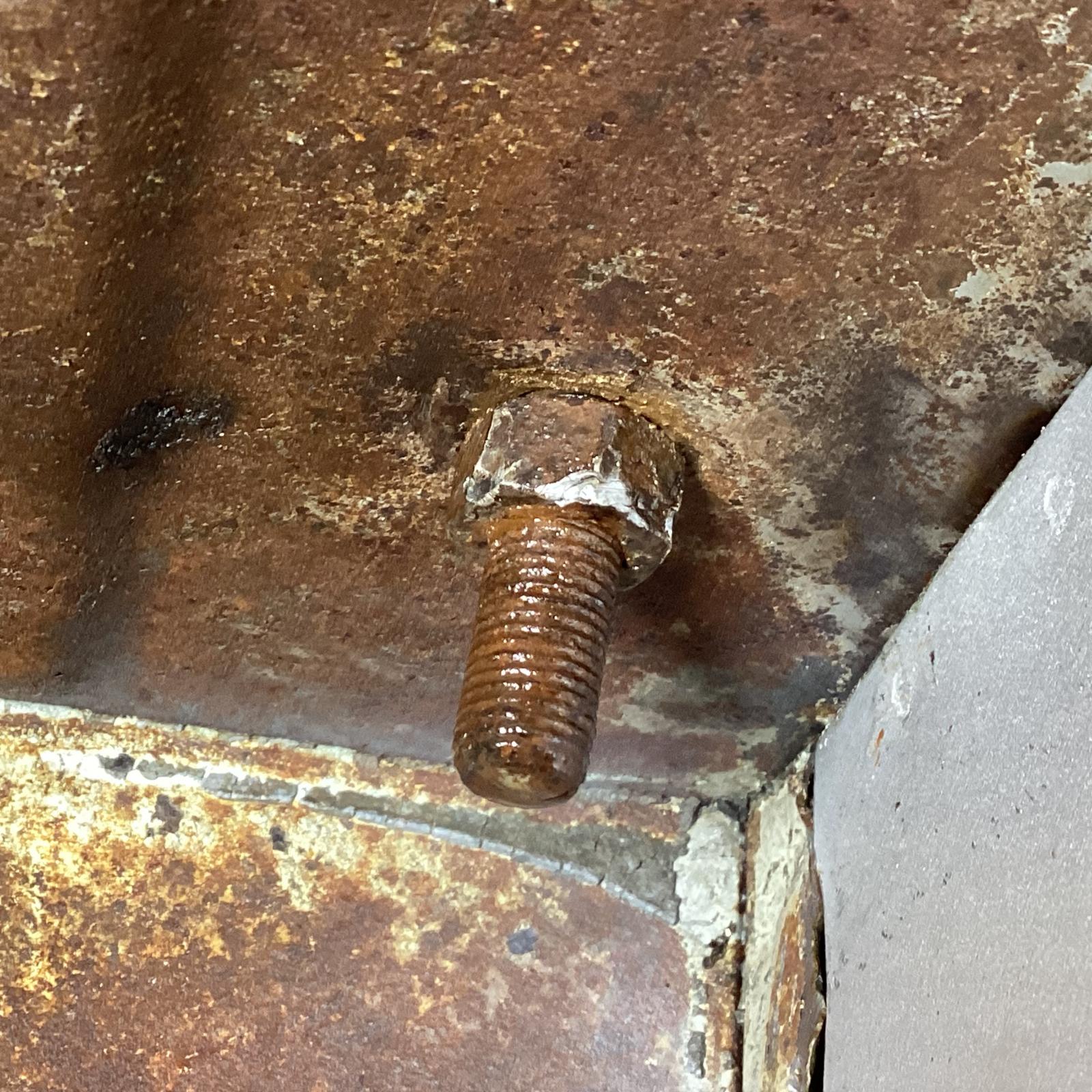

Looks like just a hole. Possible the wheelwell nuts have broken loose as they definitely spin. Toolwell I can’t tell because I can’t do both at once. Might try to get a video from below while I turn bolt head in well to see.

Aftermarket, and a really shitty job at that, not even a big washer to prevent it from pulling through, those belts were only decorative.
Clamping a big pair of vise grips on that will catch on something to hold it while you turn from above, but sawing it off would be my first choice.

Found my nut splitter, split the nut... stayed on the bolt! LOL. I'm gonna have to do most of them twice, and pound off the pieces. If it wasn't so loud under the wheelwell with a Fein tool I'd just saw the bolt in half!

You can cut the bolt and nut with an angle grinder, clamp the upper side to hold the bolt.

If the nut is split it must turn now, clamp some locking pliers on it and unwind the bolt out from above.

Got them off by buying a Makita impact wrench with deep sockets and a waaaay bigger visegrip. Even the split nuts resisted the impact wench for a few seconds. They weren't, but I was beginning to wonder if they were welded on...
