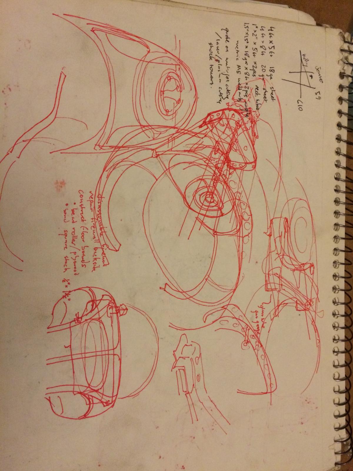

Anyways, I was staring at the pile of parts left over in the front yard and this idea came into my head that it would be cool if a front fender formed the lower part of the body of a volksrod and the torsion tube poked out from the headlight bucket. So I did some sketches to see if it might work. Sorry about orientation. I only have a tablet to work with and its windows based, slow, and annoying so I don't like to waste time with it much.
After seeing my sketches I decided it had to be built. I think I may have some pictures on an old hard drive of the chassis build phase, but have no idea how to recover them. But it took about a week to cut a foot or so out of the tunnel and z cut the rear suspension for something like a 6-8" drop.

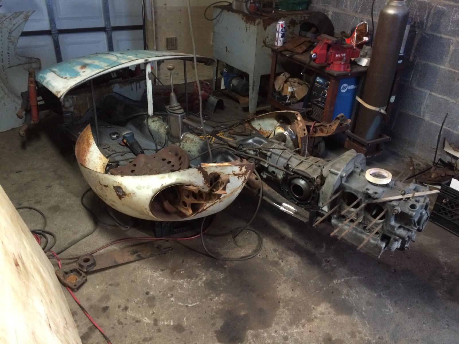

Finished up the transmission build upon returning with a nice case for it.
Here it is hanging out in my living room with a friend. Its the one on the right.

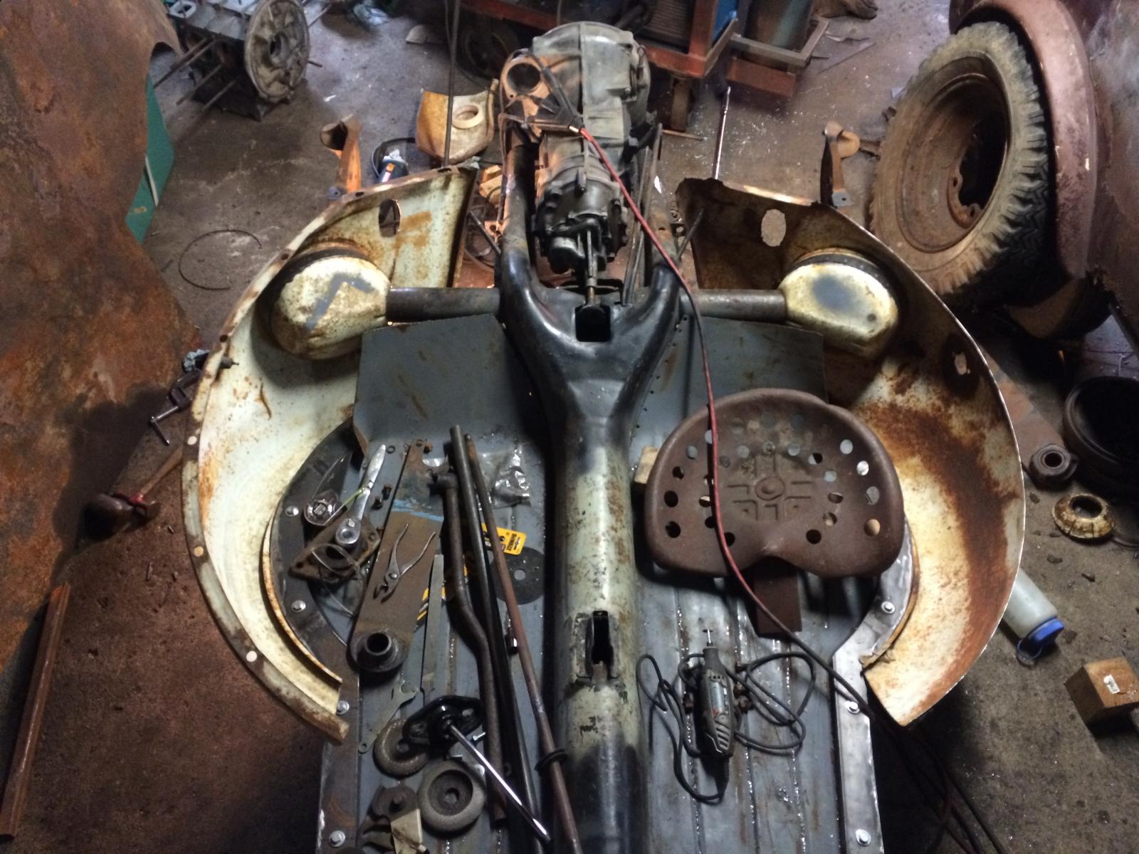

And here's some pictures of where I'm at with it now. More in my gallery.
First time the parts have been in the same pile/state in 5 years. Kinda gives a good idea of the direction things have to go for it to become a car.

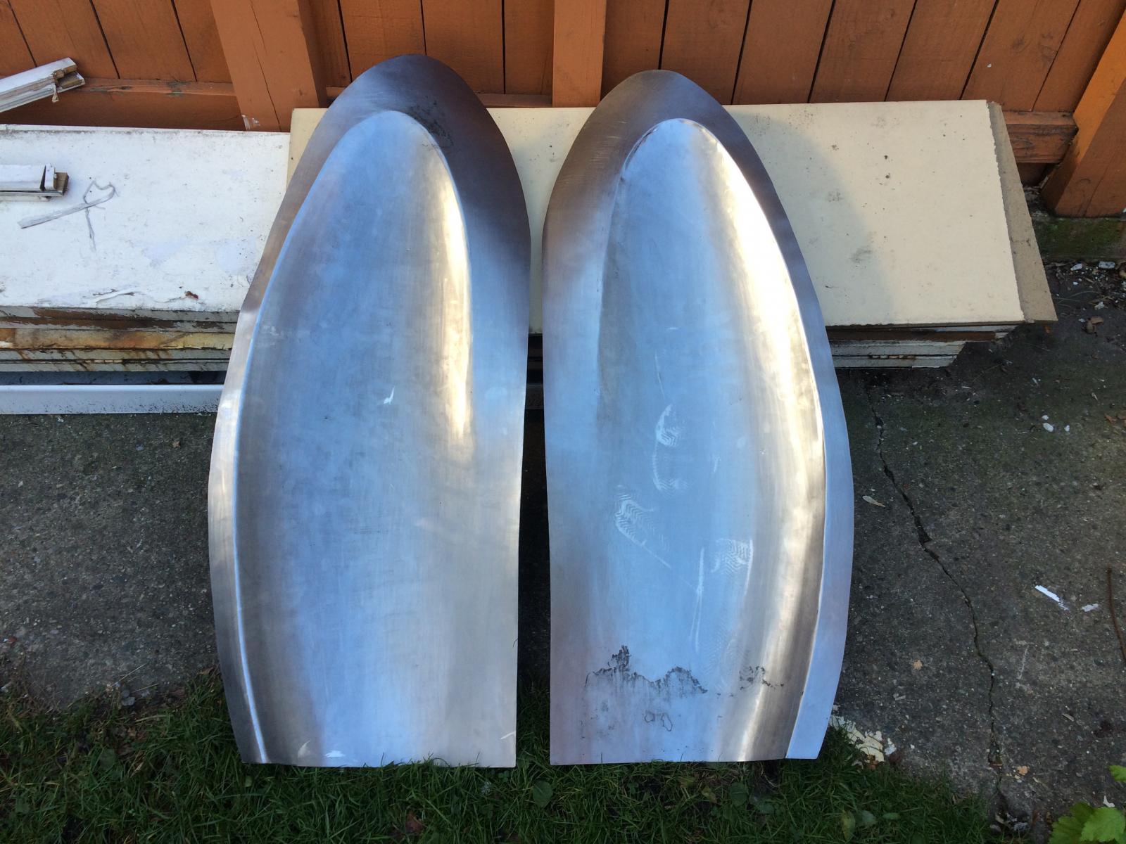

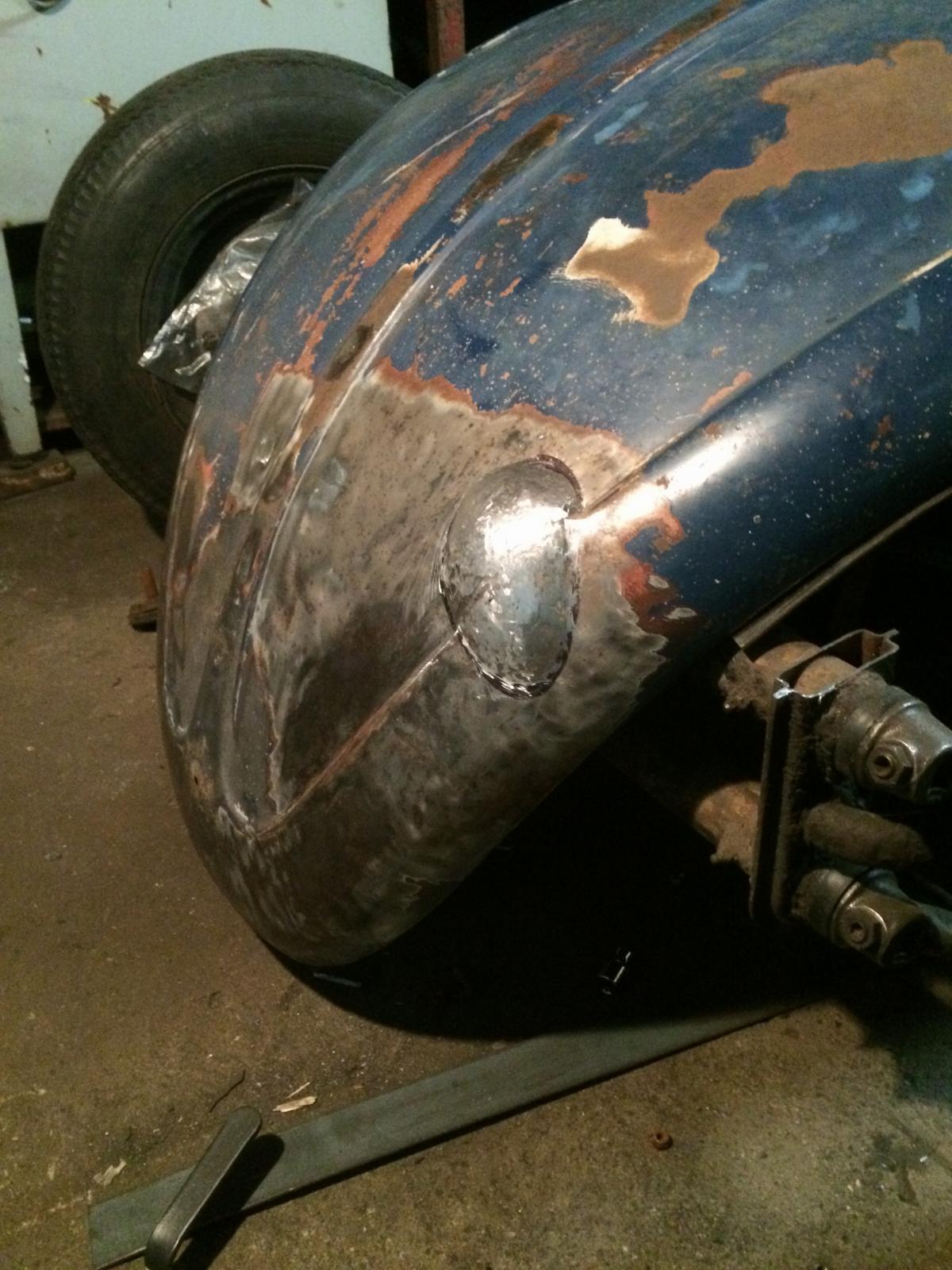

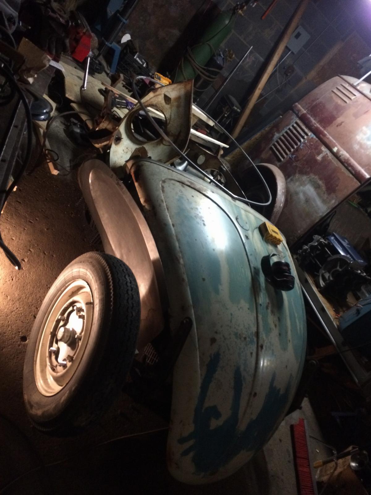

Formed taillight housing first. Going to try to get away with a single center mounted stop light for all my taillight needs.

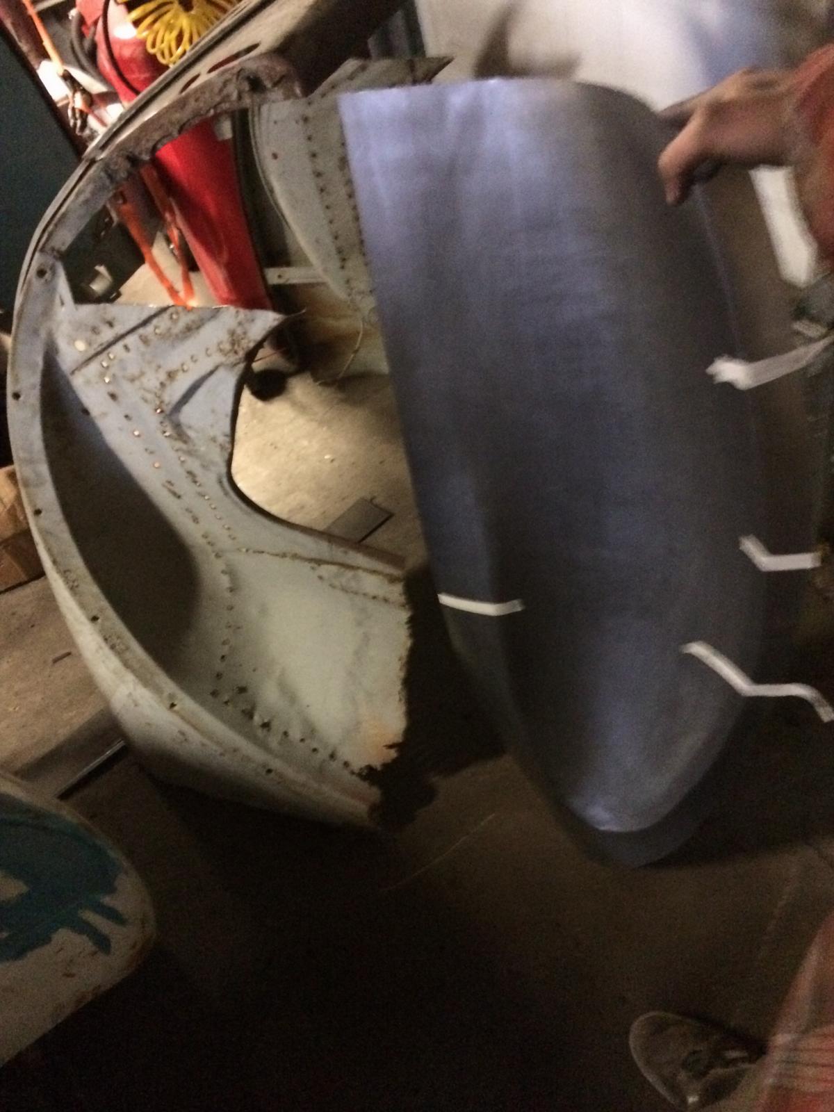

Then formed new front fender wells.
They aren't perfect but pretty damn close considering I've never really messed with an English wheel before this.

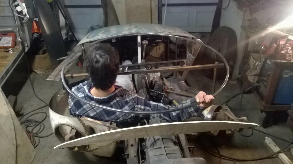

Test fit for bubble. Decided its going to have to be a bit larger and not quite as round at the front to make room for the steering wheel and me.
Ended up getting some steel bent, waiting for the place to call me back today or I'd be working on it now instead of posting here.

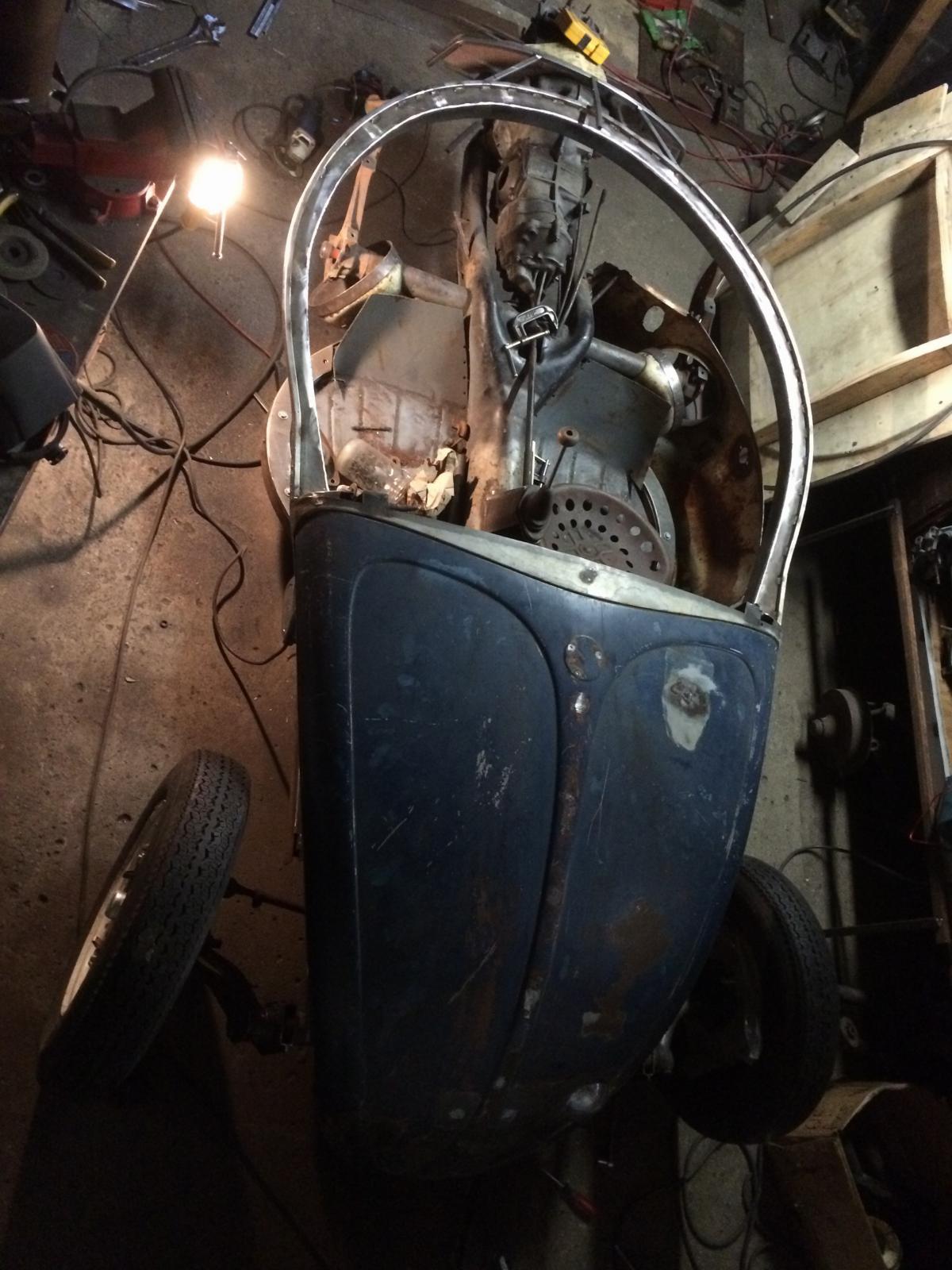

got some steel bent up for the hoops.
going to aim for a shape like this, but have to go to Pittsburgh for a few days so wont be able to get to it for a while.

I've only gotten maybe 6 hrs of work on this thing in the last 10 days. Been doing some drywall work in the attic and visiting friends over the holidays. Probably won't get back to it until this weekend.
Hoop for bubble is coming together nicely. But nothing worth taking pictures of right now.
I guess the bubble might look turret like to some folks. Wasn't really the idea I had in mind personally but this project is meant to inspire so if that's what you see I am totally cool with that.

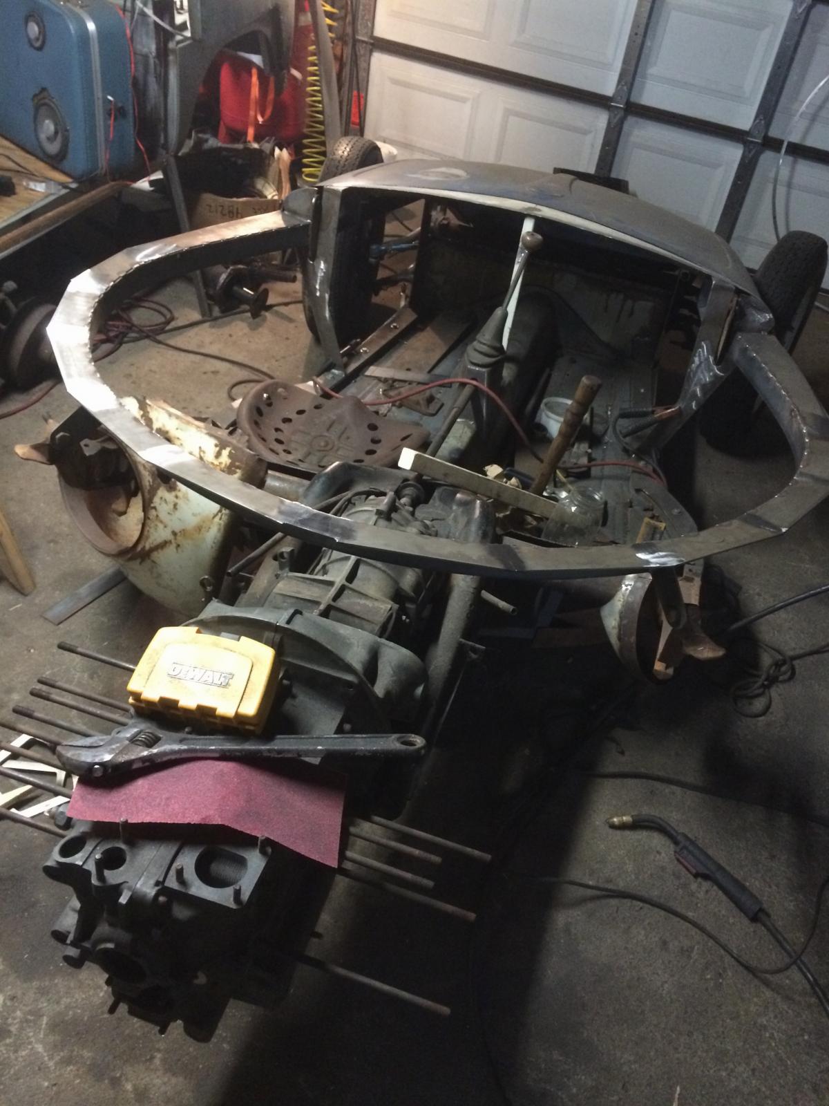

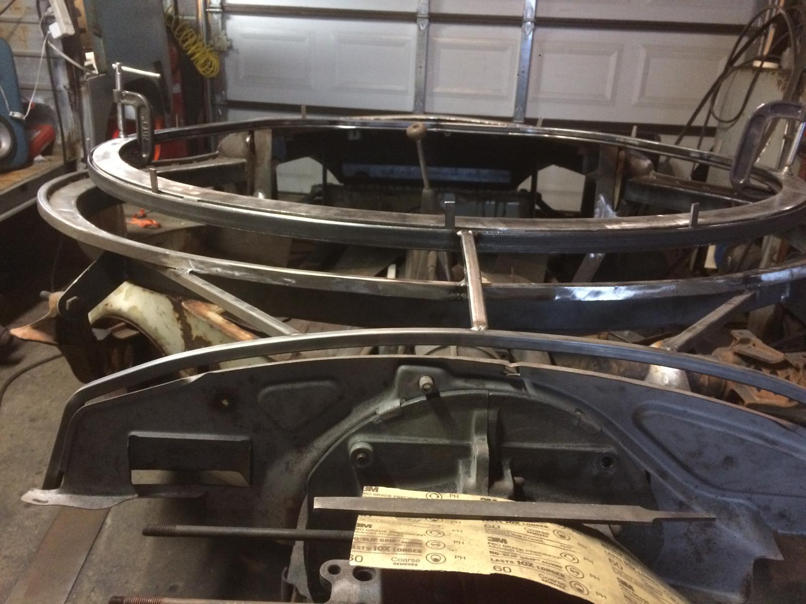

got all the hoops made up for the bubble top frame and mating piece for the body. 28 pieces needed to make the shapes I wanted. pretty tricky to maintain symmetry and an even gap.
used all my clamps and 1/8" thick scraps to maintain the gap.
got the mating piece tack welded in place.
checked position and reinstalled bubble hoop assembly. its tack welded together right now but eventually there will be hardware to hold it together.
shows the reshaped front part of the bubble frame.
couple of other angles just to make sure it looks good.
and then I had to see how close I got with my 3rd attempt at making a reverse curve a couple weeks ago.
also got some bits for the gas tank. not sure when I will get to that.
