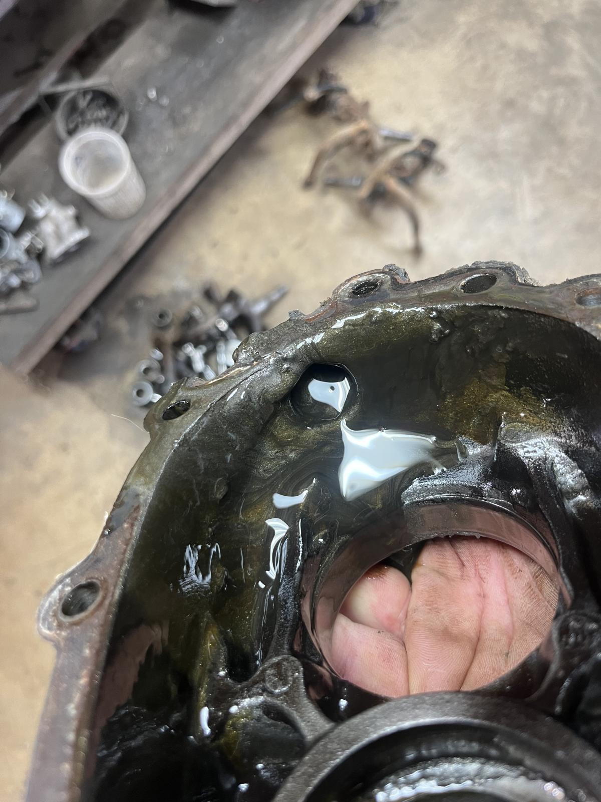

cuz this seems bad.
LOL. This bus is gonna kill me.

The bus rolled smoothly, so ya figure, "gosh, the tranny and RGBs at least are okay!" Also got a call today that my heads were toast, and needed new ones plus all related machine work.
At this point, I am pretty sure that next the gates are going to spontaneously combust, and the bed roll up like the lid of a sardine can...
At least this extra work gives me more time to paint the underside and start wiring work.

That happened to me on a long trip. I cleaned everything in gas, put the inner race back on, made a gasket out of a brown paper grocery bag, and went 43,000 more miles like that. I even think it may have been only the outer race I put back on.

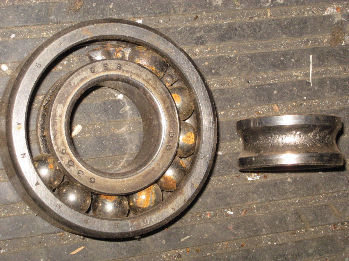

Here’s some parts from my 61. Took the pics before I chucked them when I moved, some years after they failed. One bearing the other half was stuck in the RGB cover. The ball bearings fell out when the cover came off.
Still have that rebuildt tranny in it.

Replace all of the bearings on that side. With that much metal chunks whirring around in there, the other bearings most likely have been damaged.
Just might be a good time to have the transaxle rebuilt now, and perhaps higher geared.

If that was a big nut RGB, they use a roller on the output side. Pretty sure it is the same part as a bay window bearing. An incredibly strong part. Ball bearings are much less durable, but one needs a ball bearing or pair of conical rollers (Timken patent) to fix the location axially (in or out on the axis).
I often suspect water intrusion/ rust on our old swing axle vehicles, especially if they ever get water into the swing axle boots.
water will ruin bearings very quickly and ball bearings worse than rollers. I think water will settle to the bottom of the RGB's or gearbox and can be drained out or tested for first, if you suspect it.
I'd guess your wow wow sound to be pinion bearing wear. certain point it is silent. too much or too little throttle will result in whining. A good ring and pinion guy (or gal) can fix that. Did they tell you how they fixed it?

Yes, it is a big nut in my 61. It got all new bearings.
The rust is the picture was from sitting on the shelf since I removed it from from the bus.
The noise in the center section went away after the rebuild. I did not ask what that was from. The rebuilder wasn’t perfect, it jumps out of second under load. 😕
I did change the oil when I first got it as a used tranny, and after 30k miles. It had a lot of brass in the oil.
Getting a used tranny is playing the tranny lottery. It rolling does not mean it is good. Getting a sitting bus going, you just don’t know. If the seller tells you it’s good, it could still be bad. Lol. It could be a howler. Or they could say it’s bad and it’s fine and just needs a shift linkage coupler. Or be fine except for no reverse.
I haven’t tended to find water in the trannies through.

once the bearing gets stuck it will destroy the shaft, but that looks good?
so change the bearings and everything is fine again!
