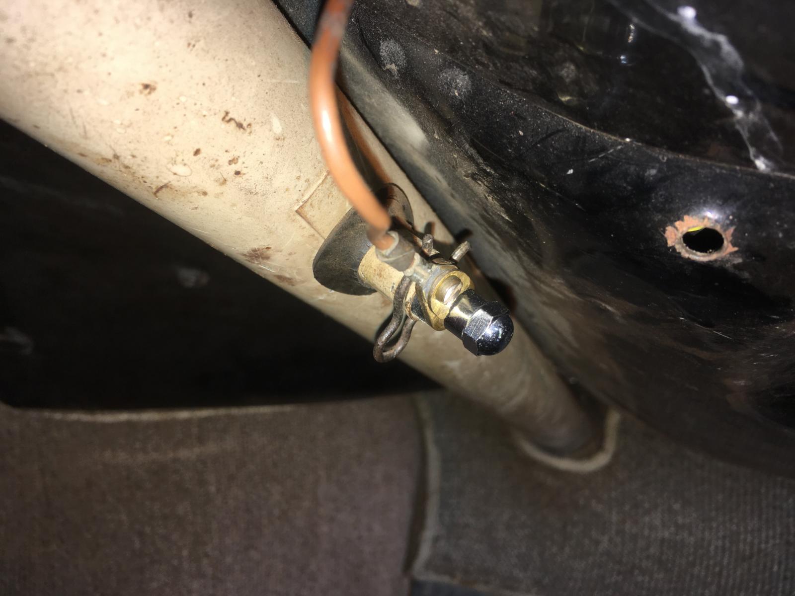

My 1957 is missing the plastic cap on the Horn Brush that holds in the brush and spring. Has anyone found a replacement or an alternative way to hold the brush in? I could purchase a new brush from WW but the $80+ cost is hard to swallow.

One of the P.O.'s of my car used a chrome valve stem cap to repair the brush:
It's working so I've left it alone. I imagine a black plastic one would work as well.

Thanks TCoop - i'll try the valve stem cap.
