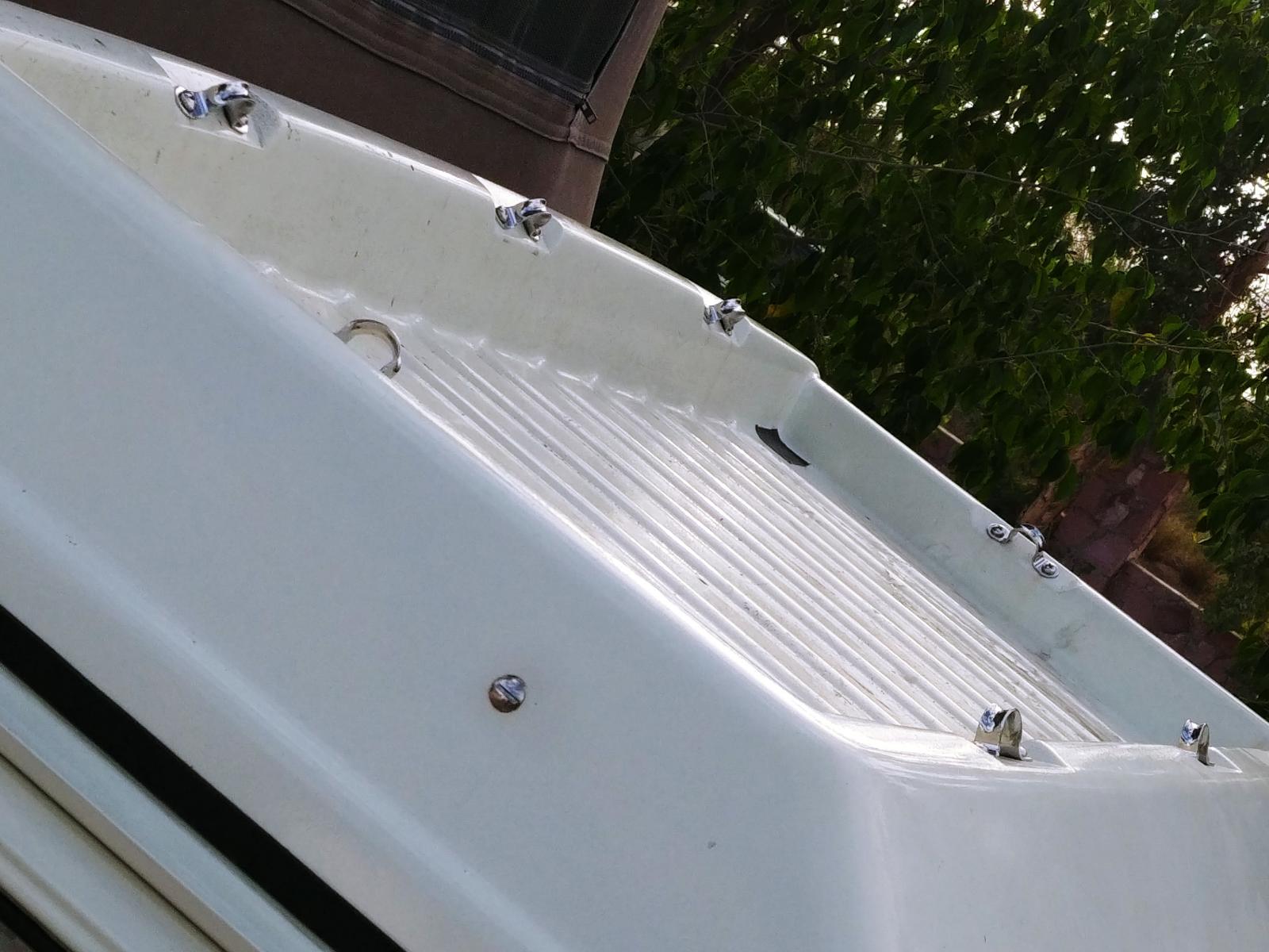

I ended up going with these:
Stainless Steel Oblong Pad Eye Straps Wire Plate Bimini Staple Ring 8mm
https://www.amazon.com/dp/B01BIA6428?psc=1&ref=ppx_yo2ov_dt_b_product_details
The spacing between the bolt holes was too narrow, so I reshaped them in a vice. I'm very happy with end result. I only have one trip with them installed, but didn't notice any vibration or wind noise.

PostPosted: Thu Jun 01, 2023 2:29 pm    Post subject: Re: Cargo bay tie down points Reply with quote
Perhaps a bit premature to post another update, but I just wrapped up a 900 mile road trip and these things are awesome. Super easy to use bungee cords and straps to secure my camp table, chairs, firewood, etc, to the luggage rack.
The link I provided above is still active and eight of these cost less than $16. Compare that to $52 for the original style cleats at GoWesty. Not knocking GoWesty, I love our vendors, but this is a no-brainer!
