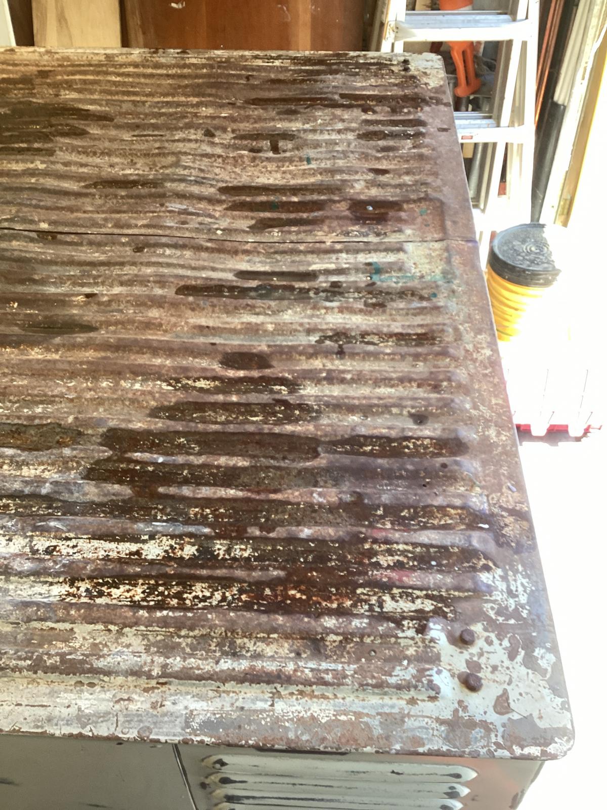

While the correct answer is ‘replace the metal,’ I am looking for other options on my bed, which has several spots hammered well below the plane of the bed. Any use pounding out from below? They don’t need to be flat, but better would be nice. Also, besides seam sealer, any suggestions for the seams? Weld them shut someday?

you're never going to get the metal right by pounding it
it was stretched when the dents were made. pounding the dents out will further stretch the metal, and it will need to shrink some so it doesn't oil can
I would just replace the bed, which is what you don't seem to want to do. The only other way is to remove the bed floor and work it that way. doing it in place is a suicide mission imho
you can drill out and remove the bed and replace it faster than you could even fix one dent.

Personally welded the seams shut. Only way to be pretty sure on a flat surface to seal it up.
When sheet metal is dented in like that, trying to hammer it up will not help. The very sheet metal has been stretched, as in longer from point "A" to "B" so no longer able to be a straight line. If you did hammer it up without any additional stretching from the hammering (definitely doubtful), you would have humps in the bed that would be equal to the dips you have now.
You really need to SHRINK the now stretched metal, but with corrugated metal like that it maybe hard to do. With fairly flat sheet metal using a shrinking disc has worked well for us. You might as well get one and try it out. There are two sizes, thinking that the bigger one might work better since it heat the areas faster, but you may still need the smaller sized disc at same time to get into the smaller areas. So two angle grinders would be needed to go back and forth quickly.

A combo of not wanting to replace the bed, and not having cash to do so! There are a number of things that could have been done when at the body shop, but cosmetics were axed by the budget.
I will try shrinking disks. And welding the seams eventually. Easiest is a bedliner but that seems wrong, even on a bed this beat. My main concern was standing water due to my local climate, but as I live on a hill I doubt it will be truly horizontal very often.
Dents will make installing bed slats an interesting process...

why? it's a 100% waste of time
they only work on smooth surfaces.
the only way to save what you have and not make a bigger mess is to 1) replace it or 2) remove it and work it by hand, feed it thru an english wheel etc to stretch/shrink it back into place
for 880 plus shipping I would go this route:
https://www.wolfsburgwest.com/cart/DetailsList.cfm?ID=261801400
just trying to save you from yourself. I mean you could literally have the whole bed like brand new in a day and 1/2

Dude, you bought a work truck that got worked hard, probably when it was several years old & had no value. If that’s the worst of it, preserve it & consider it part of its history.
There is no “working that out”.
Treat it, paint it, & toss plywood over the top of it until you can afford to replace it.

That's a possible option for the future... but assumes wallet, equipment and skills are up to it. Also space for the work. But I appreciate the advice on shrinking disks, and will just work with what I have for now.
I've got a router, so maybe I'll make the underside of the bed slats conform to the dents :)

Thanks silkvw; when I picked it up, Jeff Gagnon (body man) said "I'd just drive it." Which I planned to do, but the tranny/rgbs, spindles, brakes, wiring etc etc needed rebuilding (not to mention a motor getting built), so I saved what money I could on the welding: just enough so it didn't break in half! I might do the bed at some point, especially if the seams are a big(ger) problem and start causing serious rust below. Meanwhile I might hit the bed with epoxy primer and some rattlecan two-part just to stop the rust a bit.

Back in PG era (Pre Gerson) I took out my 23 window floor and shrunk it down perfectly with a large shrinking disc. It was a pain in the butt and I had to work the dips from the top and the bottom but it did work really well. Check out the photos from my gallery at the time. The only other option back then was the WW funky red panels that were trash and I couldn't stomach having floors that were so far from the original profile.

so as you can see it's doable. Would I do it again??? Hard to say as it is a bit of pride to say its the original floor (petty I know Wink )
