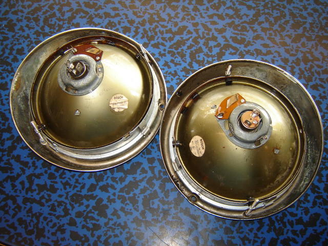

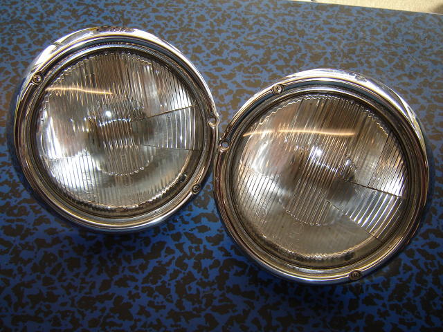

telford dorr wrote:
They should fit in your stock mounts...
You have seen VW Euro headlights with the bulb and reflector, right? There is no mount, the trim ring is the mount unlike seal beam units with the separate baskets and adjusters to hold the bulbs. IIRC there are also no tabs in the headlight bucket to screw the baskets to, not a giant pain but someting to consider.
Courtesy Hazetguy Wink
