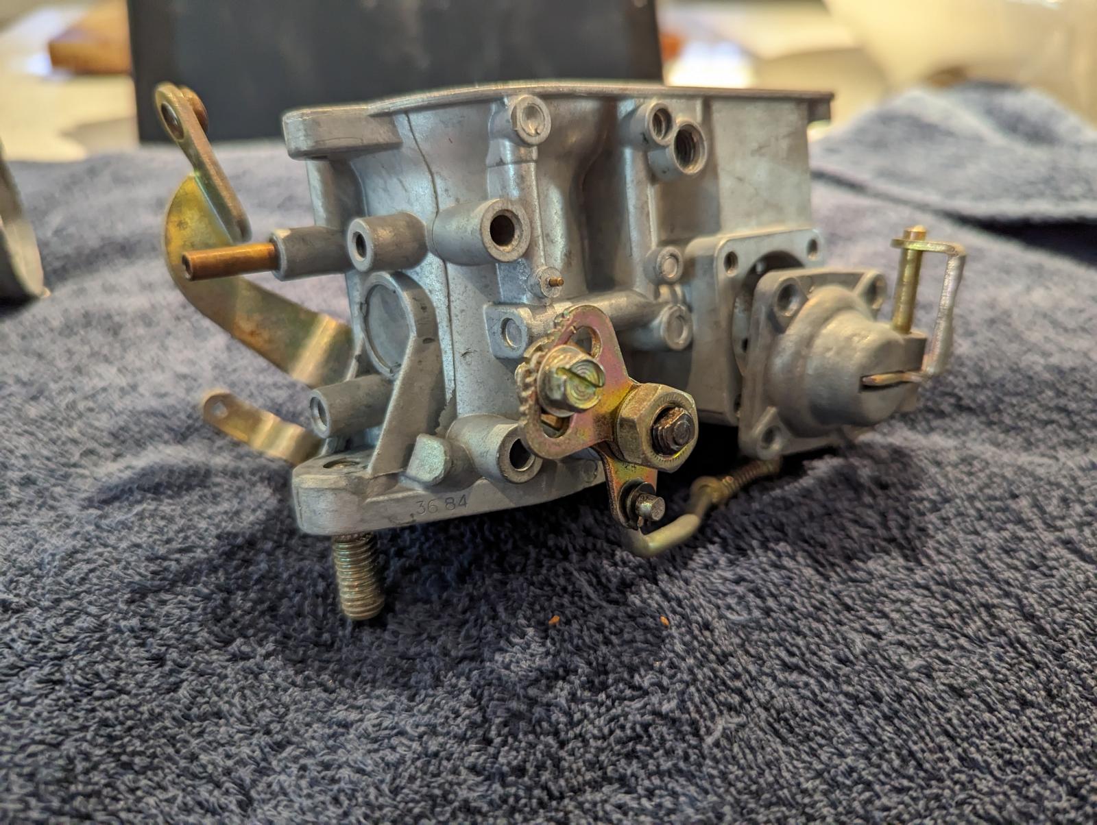

Since my last post I've rebuilt the carb. That was a fun first time experience. Car starts and seems to run a little better, but the timing issue is still perplexing.
@heimlich I'm thinking I will take your advice and replace the 009 dizzy, even if it doesn't solve the weird initial timing, at least the motor will be better timed dynamically and get rid of the flat spot.
This was my first time rebuilding a carb, and I got an ultrasonic cleaner to help minimize the effort. Holy heck was it worth it!
Before
After
