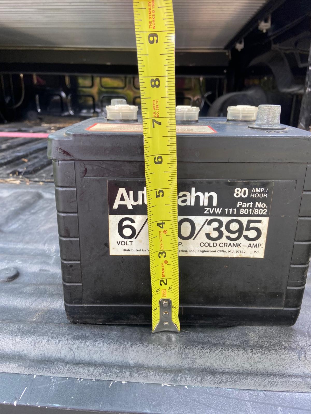

I have been looking for a low profile 6v battery for my split (1952).
I am in Canada and the stores, Nappa & Canadian tire, only have an 8.75 inch height battery.
Any recommendations?
I'll have to buy in the USA if necessary.
Thanks.

I believe it would be the same as I run in my stock 1960 beetle: 19L. these are 7.5" tall and available at many locations in the USA. prices have almost doubled in the last few years so expect in the $200 range.
I have typically gotten a decade of life out of mine.
NAPA: Part #: BAT 7217L
best wishes

I buy the 19L batteries. Have to call around, getting harder to find, and expensive. Paid $193 for the last one at my local Auto Parts Chain. They had to order it from their main distribution center.

Recently had to order a 6V battery for a project and tried to get an Interstate 19L which had been spec't at 172mm wide, 227mm long, which converts to 6.77" x 8.94"not sure of height. The 19L is no longer listed and has apparently been superceded by P/N 1-VHD. The newly listed battery measures 9" L, 6 15/16" W, 8 3/4" H. Battery should arrive next week, so I can check fit of cover, which I hope fits, not too many options at this point. Hope this helps those looking for new batteries.
geneL3c
Joined: October 08, 2007
Posts: 311
Location: Bridgehampton,NY
geneL3c is offline
PostPosted: Thu Nov 14, 2024 11:35 pm    Post subject: Re: Current info on low profile battery 6v for Split? Reply with quote
Update on low profile 6v battery for Splits. Advance Auto has a Die Hard 6v 19L battery listed for $192-. Ht - 7.5", W - 6.8", L -8.2". I'm staying with the Interstate battery I ordered since height is not a concern ( no back seat ) and have always had very good luck with Interstate batteries for my other 6v cars.
